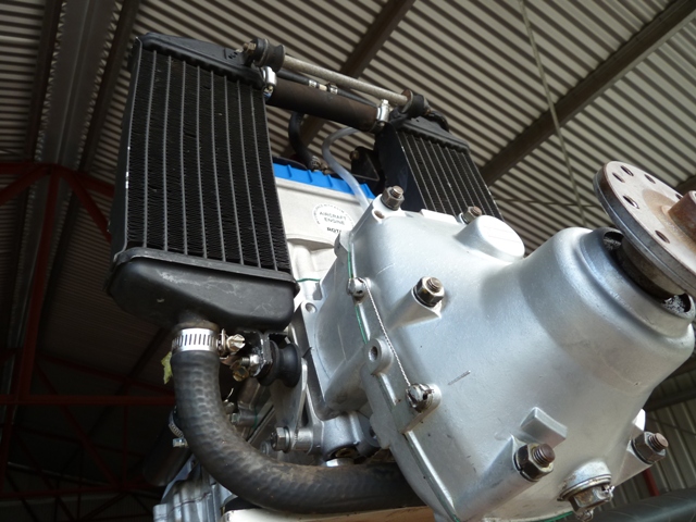

Frank,
I said a few posts ago that I'd put up some photos of the shock mounts I'm using. Here they are.
Pud, Are the bolts on the rubber mounts, on the radiator and exhaust, one long bolt right through the middle,or, are they 2 seperate bolts,one from each end and moulded into the rubber?

Pud, Are the bolts on the rubber mounts, on the radiator and exhaust, one long bolt right through the middle,or, are they 2 seperate bolts,one from each end and moulded into the rubber?Frank.
2 separate bolts moulded into the rubber. They need constant inspection to ensure the structural integrity but I reckon they provide better shock absorption then if it was one through bolt.
