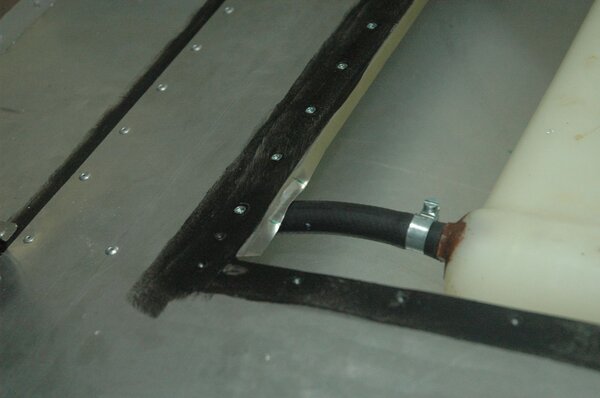

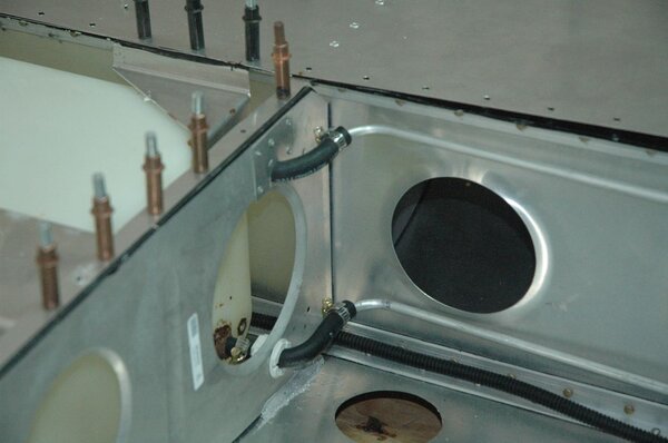

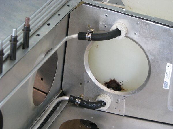

winsor68 Posted July 10, 2011 Share Posted July 10, 2011 Bubbleboy, It is common practise on our level of aircraft to use screw-clamps and rubber fuel hose. I won't use any fuel line unless it is black, from the US. I have been dissappointed with the red rubber hose, as it seems to crack the outer sheath fairly readily. If you putting fuel line in a position where it won't be easily accessable, like for instance Savannah wing-tanks, than I would definitly use US made, black rubber hose, and nothing else.All rubber hose looks good and equal when it is new. I see a lot of fuel line with years of use on it, so I am in a position to make good comparisions. It is something I take a particular interest in, and there is nothing but US made hose in my plane. If you are pushing rubber hose onto barb fittings, look for a good tight fit, but not so tight that you need to be Attula the hun to push it on. Also not so loose that you use the clamp to squeeze the rubber onto the barb to seal it. you can double clamp on lines that are pressurized by boost pumps if you have the room for two clamps. I use nothing but quality Tridon brand Stainless clamps. Do not overtighten clamps. Fuel line leaks are a pain, and dangerous, so do your best to avoid ever having any !...remember keep it as simple as possible, for added reliability.............................................Maj... Maj... Do you know what comes standard in the wings of the Sav S Certified? The one I fly has long range tanks... apparently they are an option. Link to comment Share on other sites More sharing options...
Bubbleboy Posted July 10, 2011 Share Posted July 10, 2011 Hi BubbleboyYou picked up on that mistake I made back then. The wings were one of the first things I made getting on to almost a year ago now. Those clamps are stainless Tridon clamps that Maj suggested BUT they are not like the rest of the clamps supplied in the kit. Those clamps are all solid no "teeth" holes in them. The main fuel line has them you can see in the pic and I have these now in the smaller size for the ones you picked out in the pics. Although there is no pressure on these lines I am replacing them with the norm used throughout the kit on all fuel lines. I will fix these up when the wings come back over to here. I made them at my mother inlaws place as I didnt have the room here then. I also have nutserted all the cover panels for the tanks rather than rivet the panels as done in the kit. This will give me easier access if anything goes wrong in the tank area or I have any leaks...a lot of work to do all the nutserts but better than having to drill out all those rivets and there is a lot in 4 tank covers Mark Hi Mark...I wasnt trying to be smart or anything it was just one of those things that "rung a bell" when I saw it. I had no idea if it was right or wrong hence why I posed the question. Im glad you posted them so now I know. Keep up the good work! Scotty Link to comment Share on other sites More sharing options...

Guest Maj Millard Posted July 10, 2011 Share Posted July 10, 2011 Mark, Generally the solid type clamps that you refer to are fine. They do come in a couple of styles, Rotax uses them on thier engines both for fuel and coolant hoses. If the hose is the correct size, and the fitting that it is going is a barbed or raised type, then the rubber hose should fit on firmly, and not want to come off. The use of clamps ensures that it doesn't come off, or leak in service. I wouldn't recommend the non-use of clamps in aircraft......................................................Maj... Link to comment Share on other sites More sharing options...
