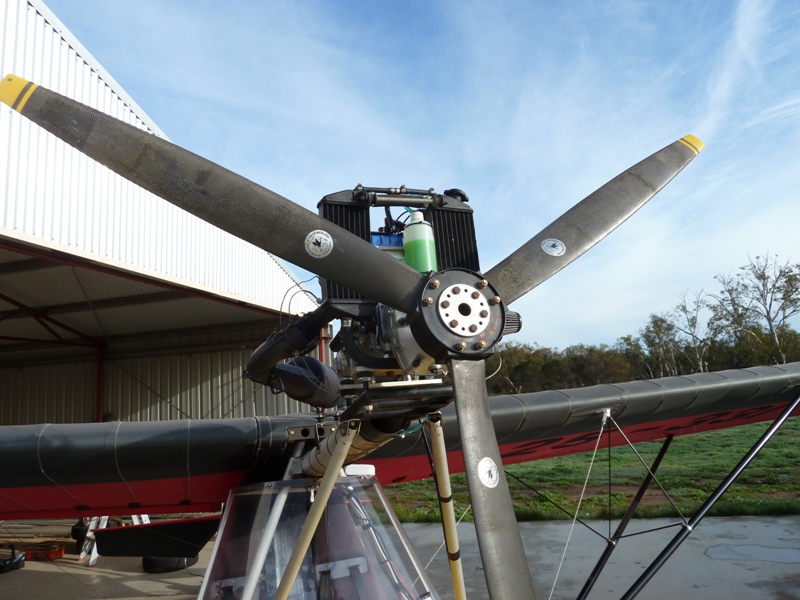

brilin_air Posted April 21, 2012 Posted April 21, 2012 I am not too familiar with the design of this aircraft but there looks to be no shrouding for the radiators and the air would take the path of least resistance and wash around the radiator instead of being forced through it ? Maybe leave the bottle where it is and slightly deflect the radiators inwards to get more airflow through them.

pudestcon Posted April 22, 2012 Author Posted April 22, 2012 Quote Do you have the bleed tube attached to the front top of the head on the 582 (going back into the radiator). There may be a large air bubble sitting there if the tube is not in place causing the overheating issue. Do the egt's vary in flight or is that a static reading.? The bleed tube is attached from top of the engine head to a 't' piece in the 1/4" horizontal pipe connecting the 2 radiator halves at the top. In the photo post #62 you can see the black tube connecting from the cylinder head to the 't' piece. The EGTs vary in flight depending on what RPM setting I am using at the time. I don't have EGT readings at the different RPM settings for you though. I can tell you they are always consistent on both cylinders. Pud
