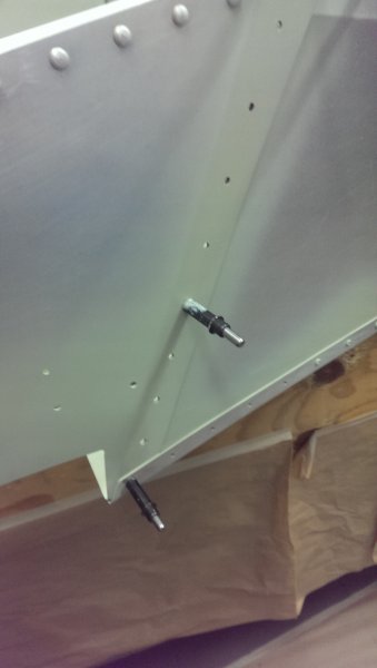

Lyndon Posted November 4, 2015 Author Share Posted November 4, 2015 No worries. Thanks. Where about s in the rear of the fuse Link to comment Share on other sites More sharing options...
rick morawski Posted November 5, 2015 Share Posted November 5, 2015 No worries. Thanks. Where about s in the rear of the fuse where abouts what? me no undystandy Link to comment Share on other sites More sharing options...
Lyndon Posted November 5, 2015 Author Share Posted November 5, 2015 Where does it come out on the rear fuse skin Link to comment Share on other sites More sharing options...
rick morawski Posted November 5, 2015 Share Posted November 5, 2015 Where does it come out on the rear fuse skin here, the dimensions in the picture are where you drill a hole, put a grommet in then the wire thru. Link to comment Share on other sites More sharing options...
Lyndon Posted November 5, 2015 Author Share Posted November 5, 2015 Thanks got all confirmed Link to comment Share on other sites More sharing options...

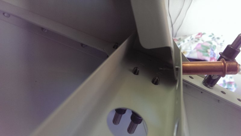

Lyndon Posted November 5, 2015 Author Share Posted November 5, 2015 Yep. My kit has the small trim tab in the manual. But the kit is supplied with the later trim. It also has some parts of the smaller trim. Thus my manual shows a complete different way to wire it. But then in another section it has the later wiring. My top skin has hole already in it for the grommet and wire. But it is in the very rear. Double checking before I go drilling again. Reg has informed me the manual for the vg was much improved for the xl. I think my kit and manual is during a time of change. But I do ask a lot of questions. Thanks Lyndon Link to comment Share on other sites More sharing options...
Lyndon Posted November 6, 2015 Author Share Posted November 6, 2015 Conformation that the angular is on the outside. Yes I looked and the manual is not clear at all. Thanks Link to comment Share on other sites More sharing options...

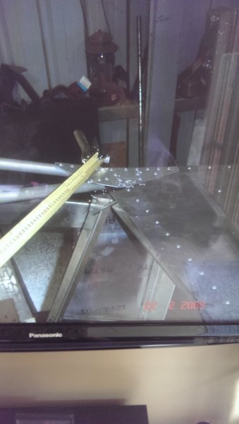

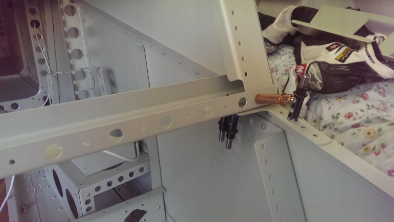

Lyndon Posted November 24, 2015 Author Share Posted November 24, 2015 Looks tight and needs to bent quite I bit to get the angle ??? Am I on the right track or ???? Thanks Lyndon Link to comment Share on other sites More sharing options...
rick morawski Posted November 24, 2015 Share Posted November 24, 2015 Yes, needs a bit of caressing into position. Link to comment Share on other sites More sharing options...
Lyndon Posted November 24, 2015 Author Share Posted November 24, 2015 Ta I have worked out it needs to on the rear as per the cut outs on the down sides of rib 8 Link to comment Share on other sites More sharing options...
Lyndon Posted November 24, 2015 Author Share Posted November 24, 2015 Sorted Link to comment Share on other sites More sharing options...

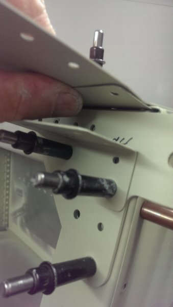

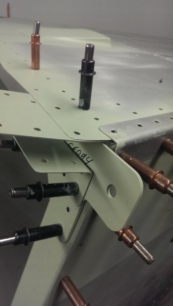

Lyndon Posted November 24, 2015 Author Share Posted November 24, 2015 Little unclear here. The top skin is attached to something at a later stage. The top bracket is to be fitted now. Looks like the top skin is bent up and riveted to the top bracket in the corners ???? True or false ??? Lyndon Link to comment Share on other sites More sharing options...
rankamateur Posted November 24, 2015 Share Posted November 24, 2015 Cabin frame tubes go in that gap where your finger is. 1 Link to comment Share on other sites More sharing options...
Lyndon Posted November 24, 2015 Author Share Posted November 24, 2015 Or ??? Link to comment Share on other sites More sharing options...
Osteri Posted November 24, 2015 Share Posted November 24, 2015 Or ??? Thats right! Link to comment Share on other sites More sharing options...

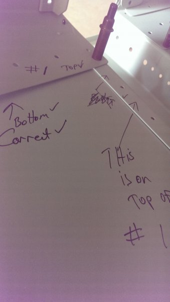

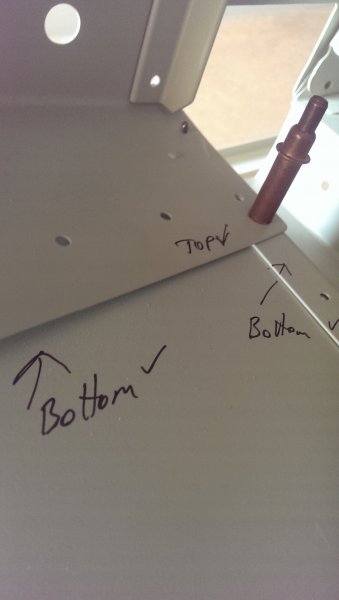

Lyndon Posted November 24, 2015 Author Share Posted November 24, 2015 So the way I have it now is correct. The manual generally has diagrams with how brackets and sheets are lined up but with this top bracket the manual is quite unclear. The frame tubes fit perfectly as I have them now. Thanks Lyndon Link to comment Share on other sites More sharing options...
Lyndon Posted November 24, 2015 Author Share Posted November 24, 2015 Nothing conclusive bin the manual at all. But in my build video pics I was right first time. It goes on top . Thanks Lyndon Link to comment Share on other sites More sharing options...
