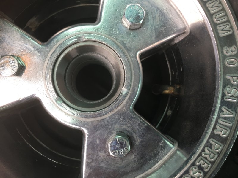

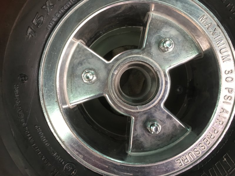

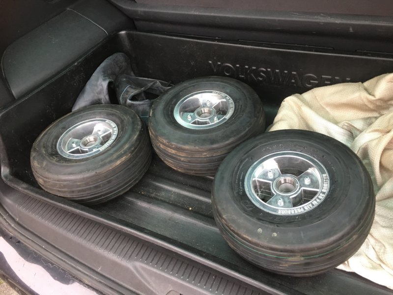

rmorton Posted January 30, 2018 Author Share Posted January 30, 2018 So finally I resumed production! Having made the mistake of drilling the rim and then having to get the hole welded (thank you Paul G for a brilliant job) I finally went to the tire specialist and had new inner tubes with 90 degree valves and the supplied tires assembled. Total cost for three tubes and assembly 75 Chfs, which for the work they did was well worth the money. The trick as stated here seems to be to cover the whole of the wheel with lube (a sort of black soap in this case) Press one half of the wheel into the tire and then set the valve in position with the inner tube stuffed into the tire. Add a small amount of air so the tire takes shape but only just. Then wiggle the second half of the wheel into place and insert the bolts and finger tighten the nuts. If needed add more air so that the inner tube doesn't get caught between the two wheel halves. tighten progressively the three nuts and check for pinching. If needed add more air so the inner tube moves clear of the gap. Repeat until the two halves are tight, then jack up the air to full pressure. Step back and feel good that at last it looks like a real aeroplane!!! :) and enjoy. Link to comment Share on other sites More sharing options...
MajorTom Posted January 31, 2018 Share Posted January 31, 2018 Good to hear from you Richard. You might consider one more step. Once the wheels are pumped up for the first time, release all air again and then fill up again. This allowes the inner tube to fit better. 2 Link to comment Share on other sites More sharing options...
rmorton Posted January 31, 2018 Author Share Posted January 31, 2018 Hi Thomas You are absolutely right in two of the pictures you can see that the valve hasn't fully seated so I will try to let the air out and re-inflate. I dont know why but this simple(because someone else did the hard part ) achievement was very satisfying and gives the impression that you have made progress! Also now getting on with the first wing Link to comment Share on other sites More sharing options...

rmorton Posted February 25, 2018 Author Share Posted February 25, 2018 Just to confirm that the advice in the video and given by Thomas is correct. I let the air out of the two tires, repositioned the valve stems to come out at 90 degrees and re-inflated. Bingo both are now easy to access and look the part! I just can't see why the supplied inner tubes were straight valves, hopefully I won't find out once it is all put together..... Link to comment Share on other sites More sharing options...
