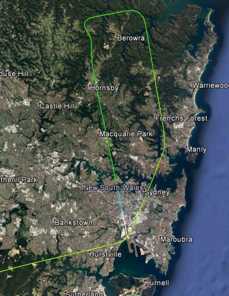

PapaFox Posted March 23, 2017 Share Posted March 23, 2017 All major turns were to the left (into the good engine) with a 20nm final onto 16R Link to comment Share on other sites More sharing options...
eightyknots Posted March 23, 2017 Share Posted March 23, 2017 Can anyone of you bring up the radar track for this aircraft? According to the news report, the loss occurred 16 kms from ASSY which is about 8.5 NM. I reckon the prop is in the Holdsworthy Army Firing Range...... OME It could have set off unexploded ordnance there . Link to comment Share on other sites More sharing options...
dutchroll Posted March 23, 2017 Share Posted March 23, 2017 The thing that stands out is that they put him on a right hand circuit for rwy 16, and that had 2 x 90 degree turns where the aircrafthad to turn into the dead engine. I thought that was a no no. Only if you have an engine failure after takeoff, or are slow with high power set on the operating engine. On descent or clean at high speed, not a problem. Normal circuit for 16R in Sydney is a right-hand circuit due to the parallel runway operations. If as shown above he did a left circuit for 16R, then it would only be because he specifically asked for it. Link to comment Share on other sites More sharing options...

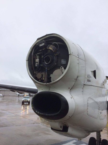

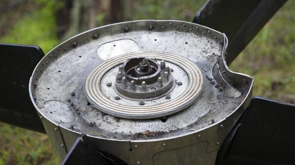

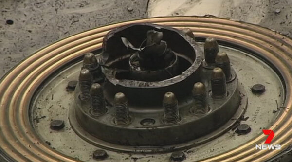

Downunder Posted April 13, 2017 Share Posted April 13, 2017 Fatigue fracture led to Rex propeller fall Fatigue fracture led to Rex propeller fall Link to comment Share on other sites More sharing options...
M61A1 Posted April 13, 2017 Share Posted April 13, 2017 What is the hole (missing bolt!) in the picspacesailor A dowel.... Link to comment Share on other sites More sharing options...
