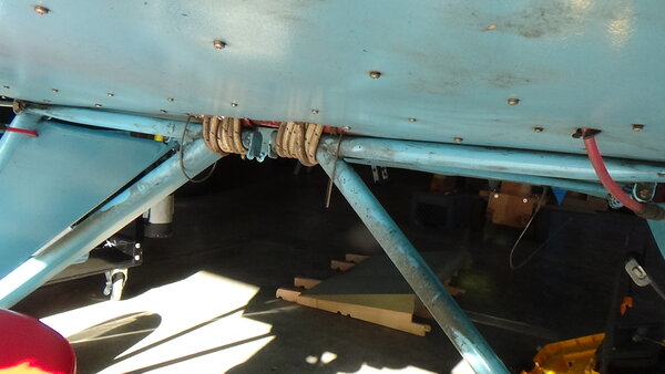

brinykraut Posted April 19, 2020 Share Posted April 19, 2020 That very much resembles the safety cables/snubbers around my landing gear legs. They're supposed to keep the gear legs from collapsing in the event of the bungees failing. I agree they seem too small to do the job, but that's what came with the plane... Here is another "whats this" (the cable not the tape!) found in the hangar today and have no clue what it is off. [ATTACH=full]52411[/ATTACH] Link to comment Share on other sites More sharing options...

Red Posted April 19, 2020 Share Posted April 19, 2020 Brinky, I have similar safety straps on my bungee gear and also they seem completely inadequate...in fact http://www.lightaircraftassociation.co.uk/2015/Magazine/Oct/safety_spot.pdf though tbh the strap does seem heavier gauge than the one in the OP 1 Link to comment Share on other sites More sharing options...
brinykraut Posted April 19, 2020 Share Posted April 19, 2020 Brinky, I have similar safety straps on my bungee gear and also they seem completely inadequate...in fact http://www.lightaircraftassociation.co.uk/2015/Magazine/Oct/safety_spot.pdf though tbh the strap does seem heavier gauge than the one in the OP Thanks for the LACA article--makes me glad I at least replaced the original bungees during my post-purchase overhaul. They weren't visibly worn, but 15 years on... I'm upgrading to wider gear legs this year, I will be sure to upgrade the safety cables as well! Link to comment Share on other sites More sharing options...

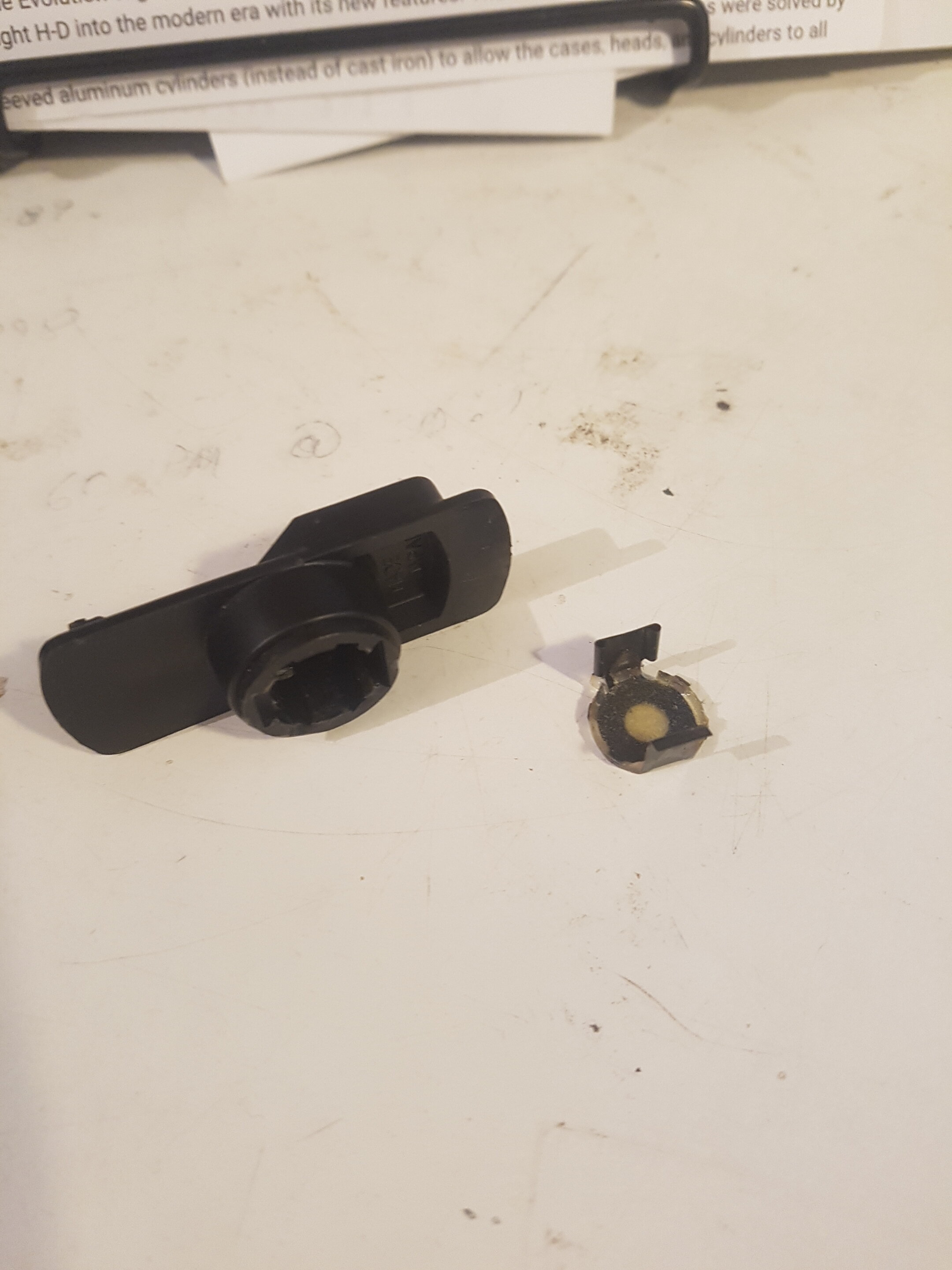

myshed2 Posted May 18, 2020 Author Share Posted May 18, 2020 Well three months later and none the wiser as to what the object I found under my plane was, I had all but given up and was trying my hardest to convince myself that it wasn't from the plane. Quite by accident today I identified the object. Its a clip that fits inside the distributor rotor. Moral of the story (well one of them) if you pry off the rotor of your Jab 2200 (which should have been glued to the shaft) make sure the clip comes off with the rotor. Dave 4 2 Link to comment Share on other sites More sharing options...

M61A1 Posted May 18, 2020 Share Posted May 18, 2020 That very much resembles the safety cables/snubbers around my landing gear legs. They're supposed to keep the gear legs from collapsing in the event of the bungees failing. I agree they seem too[ATTACH type=full" alt="DSC01661.JPG]52476[/ATTACH] small to do the job, but that's what came with the plane... The one in the pic looks like a retainer for a oil cap or pip pin as used on many aircraft. If you zoom in on this image you will see at least four of them... https://upload.wikimedia.org/wikipedia/commons/5/58/ILA_2018%2C_Sch%C3%B6nefeld_%281X7A5375%29.jpg Looking at the swages, one would have to be a special type of genius to expect it to hold the landing gear in case of bungee failure. Those ones need proper swages. 1 1 Link to comment Share on other sites More sharing options...
Head in the clouds Posted May 21, 2020 Share Posted May 21, 2020 Regarding those cables with the bungee suspension - they're not there in case the bungee fails, they're not strong enough to hold the gear legs if the bungee had failed. They actually act like the 'bump stops' on vehicle suspension, they limit the amount of stretch of the bungees, and by doing that they prevent the bungees being overstretched and then failing as a result of the overstretching. On some aircraft they also limit the amount of suspension travel so as to prevent a prop-strike on the ground in event of a hard landing. 1 1 Link to comment Share on other sites More sharing options...
skippydiesel Posted May 21, 2020 Share Posted May 21, 2020 Regarding those cables with the bungee suspension - they're not there in case the bungee fails, they're not strong enough to hold the gear legs if the bungee had failed. They actually act like the 'bump stops' on vehicle suspension, they limit the amount of stretch of the bungees, and by doing that they prevent the bungees being overstretched and then failing as a result of the overstretching. On some aircraft they also limit the amount of suspension travel so as to prevent a prop-strike on the ground in event of a hard landing. I think older LandRovers had canvas looking straps on the back axle (limiting vertical movement) for a similar reason - not convinced that it was an effective strategy in this application. 1 Link to comment Share on other sites More sharing options...
M61A1 Posted May 21, 2020 Share Posted May 21, 2020 Regarding those cables with the bungee suspension - they're not there in case the bungee fails, they're not strong enough to hold the gear legs if the bungee had failed. They actually act like the 'bump stops' on vehicle suspension, they limit the amount of stretch of the bungees, and by doing that they prevent the bungees being overstretched and then failing as a result of the overstretching. On some aircraft they also limit the amount of suspension travel so as to prevent a prop-strike on the ground in event of a hard landing. They seemed to work when I saw it happen on an Auster...... 1 Link to comment Share on other sites More sharing options...
