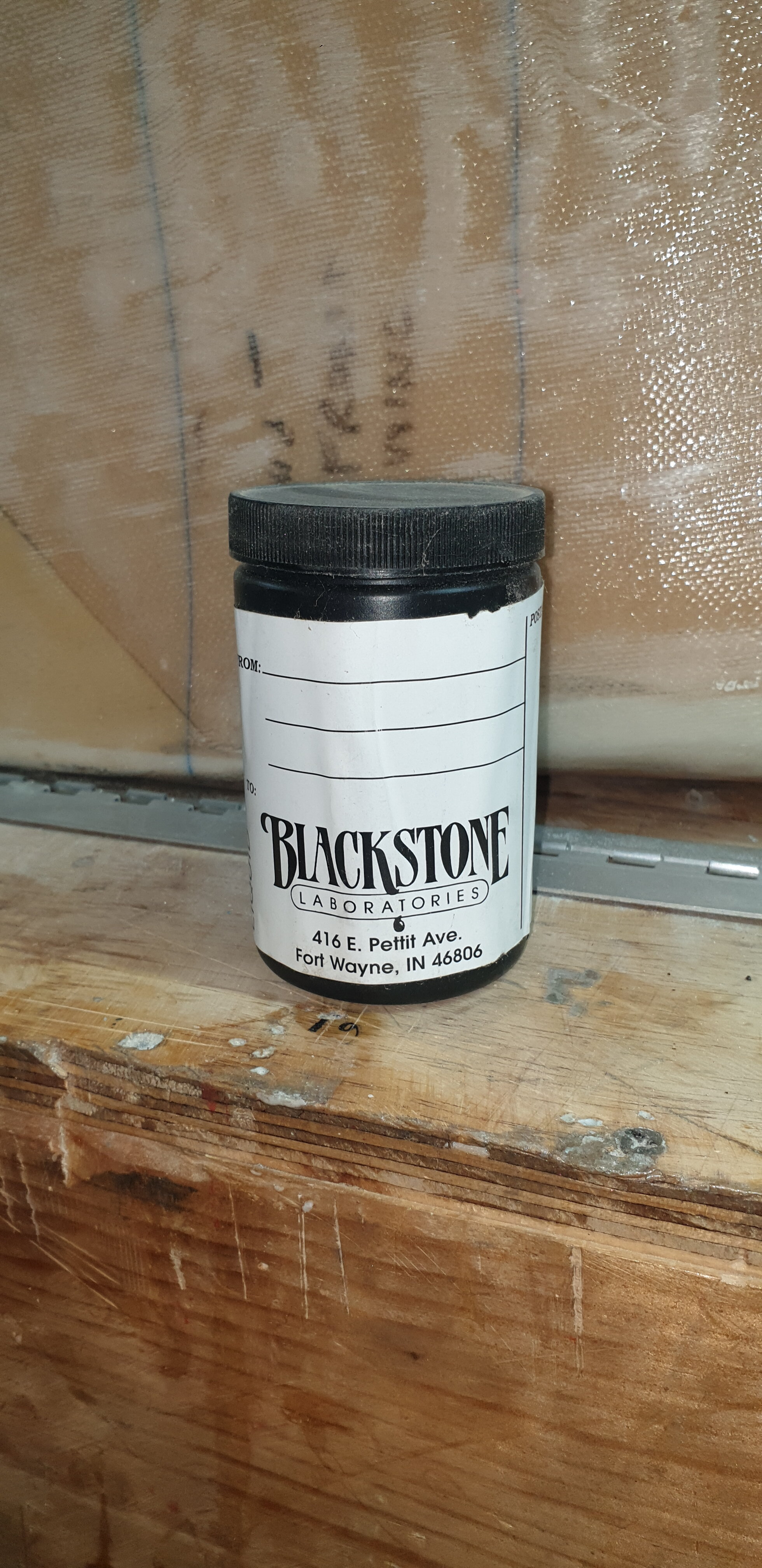

I no longer need these oil testing kits. They are prepaid just posting cost to USA. Free to anyone that wants them. Useless to Jabiru engines and 2 stroke engines, any others wanting them please pm. My project uses 2 stroke engines so no further use to me. Used this brand when I had the Mooney
