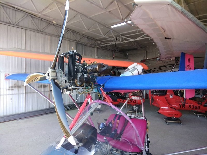

meglin Posted September 18 Share Posted September 18 We supply a 2-blade propeller with a diameter of 2 m (78.7") on this airplane and motor. With more powerful motors, 3 and 4 blade versions of the same diameter. Would be curious to compare :). 1 Link to comment Share on other sites More sharing options...

BrendAn Posted September 19 Share Posted September 19 15 hours ago, meglin said: We supply a 2-blade propeller with a diameter of 2 m (78.7") on this airplane and motor. With more powerful motors, 3 and 4 blade versions of the same diameter. Would be curious to compare :). what would you supply for an xair standard with a 582 and 2.62 -1 gearbox. i got a quote on an e prop but that was far too expensive with our poor exchange rate. Link to comment Share on other sites More sharing options...
meglin Posted September 19 Share Posted September 19 Of course, the 3-blade propeller is 1700 mm (67") in diameter. It can be saber blades (quieter) or classic blades (cheaper). If clearance allows, you can also go with 2 blades of 68,9". There can be saber, classic and ellipse-shaped blades. There is no point in talking about price - it is always lower than quality. 1 Link to comment Share on other sites More sharing options...
Kyle Communications Posted September 19 Share Posted September 19 EXC-3-185-C4-T (X-AIR Rotax 582 gear ratio 2.62) This is what you would require for your Xair 1 Link to comment Share on other sites More sharing options...
BrendAn Posted September 19 Share Posted September 19 2 hours ago, meglin said: Of course, the 3-blade propeller is 1700 mm (67") in diameter. It can be saber blades (quieter) or classic blades (cheaper). If clearance allows, you can also go with 2 blades of 68,9". There can be saber, classic and ellipse-shaped blades. There is no point in talking about price - it is always lower than quality. Nice looking prop Link to comment Share on other sites More sharing options...
