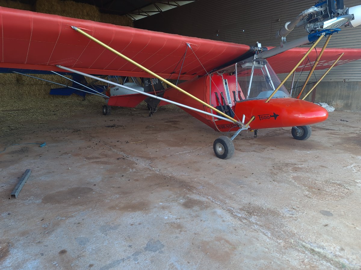

Hi guys I really want to get this old girl back in the air any info would really help cheers
damien 0458928000
Do you have the engine
12 minutes ago, Damien said:
Yes Brendan I do it’s a rotax 582 not sure on hrs
Nice. Plenty of power. I sent you a message about the best bloke to help you. Stewart lives and breathes thrusters.

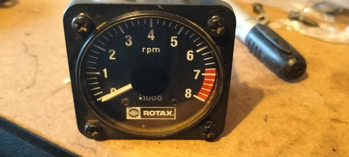

Should be easy to get. They take the signal from a plug lead. No metal contact needed.    The Thruster looks good. Nev

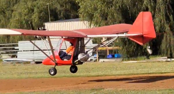

8 hours ago, Damien said:
Get them all flying I found this one in a shed and returned it to airworthy great little flyer anyone know of a digital rpm that I can get to read the rpm’s ?
Good job Damien getting another one flying again. They are great fun,  safe aircraft.  I may or may not be be the stuart referred to above. The tiny tach works well if the rotax 582 tacho has failed. This is usually due to the resistor on the tacho coil of the stator failing. Join and make a post on our Facebook group "thruster flyers down under" about your Thruster. message me here if you have any questions.
Great job Damian.
Send me a mailing address and I will send you a genuine Rotax 2 stroke tacho. I have  a couple.
No charge ,happy to see it gets used.

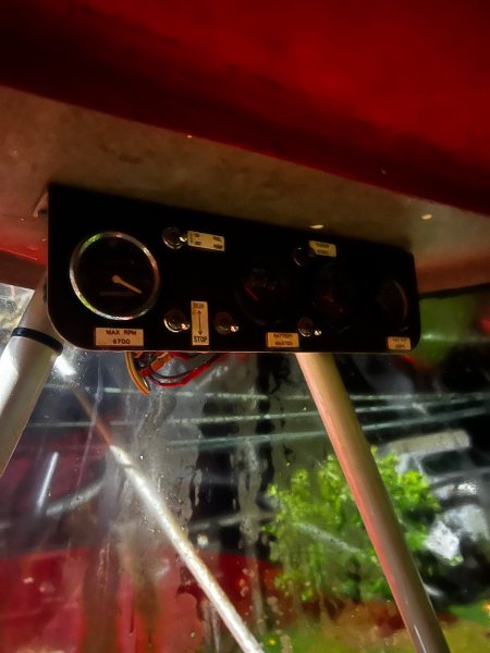

22 hours ago, facthunter said:
Is that one a pull start?  Nev
No it’s electric start nev
21 hours ago, Blueadventures said:
I see an engine start toggle switch on panel so expect has a starter.
You are correct
On 10/06/2024 at 7:42 PM, BrendAn said:
Great job Damian.
On the way. I sent you a dm
