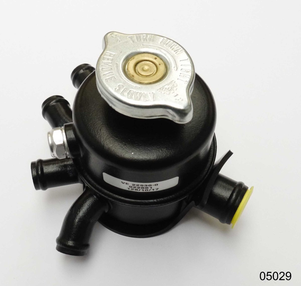

BirdDog Posted April 4, 2022 Author Share Posted April 4, 2022 41 minutes ago, skippydiesel said: Inexplicably Rotax call this the expansion tank - Rotax 9's dont have an expansion tank. Did you try for a Holden Gemini radiator hose? Hmm.. I would have thought the expansion tank would be the plastic bottle attached to the firewall. Or do they call that the overflow! LOL! Have not been able to try anything as Repco have had nothing even close. Link to comment Share on other sites More sharing options...
440032 Posted April 4, 2022 Share Posted April 4, 2022 Try mackay rubber cattledogs: https://www.mackayrubber.com.au/_files/ugd/17eaaa_667dde98888c456d96bd9e229d01053b.pdf Link to comment Share on other sites More sharing options...
Blueadventures Posted April 4, 2022 Share Posted April 4, 2022 (edited) 36 minutes ago, BirdDog said: Hmm.. I would have thought the expansion tank would be the plastic bottle attached to the firewall. Or do they call that the overflow! LOL! Have not been able to try anything as Repco have had nothing even close. This is the 912 expansion tank. The outlet on the right side (yellow plug) is 25mm and goes to the radiator and the others plumb to the engine heads and are the smaller size. This is why I asked if you have the 25mm size that your chasing for a usual rotax radiator setup. Cheers Edited April 4, 2022 by Blueadventures Link to comment Share on other sites More sharing options...
Blueadventures Posted April 4, 2022 Share Posted April 4, 2022 37 minutes ago, BirdDog said: Hmm.. I would have thought the expansion tank would be the plastic bottle attached to the firewall. Or do they call that the overflow! LOL! Have not been able to try anything as Repco have had nothing even close. Yep, plastic on firewall is overflow collector bottle. Link to comment Share on other sites More sharing options...
