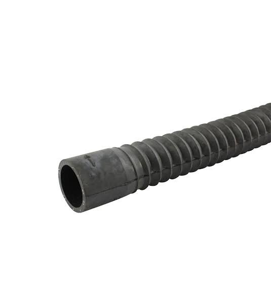

Thruster88 Posted April 21, 2022 Share Posted April 21, 2022 I have used this style of gates universal coolant hose on ground vehicles. Has a wire inside and won't collapse, bends to any shape. Has to be the correct length, can only be terminated on the straight ends. 1 Link to comment Share on other sites More sharing options...
