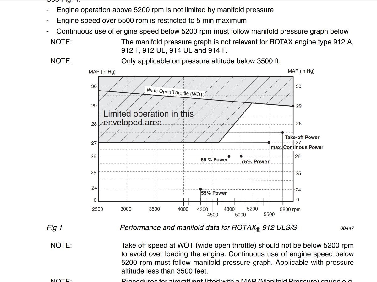

Thruster88 Posted May 7, 2022 Share Posted May 7, 2022 Without manifold pressure this discussion is meaningless. 5400 wot at sea level is not the same as 5400 wot at 5500 feet. Service letter SL-912-016 provides information on how rotax would like the engine to be operated. 75% cruise power is 5000rpm and 26in MP. 2 Link to comment Share on other sites More sharing options...

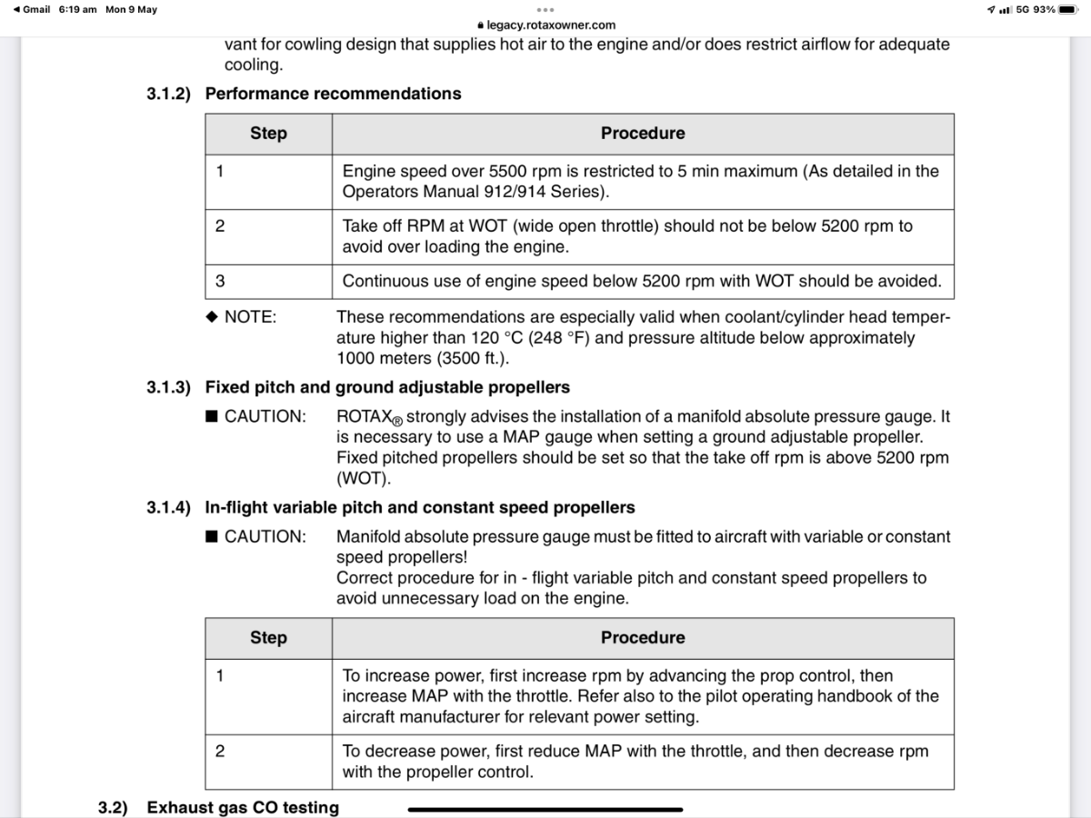

Mike Gearon Posted May 8, 2022 Author Share Posted May 8, 2022 Okay 5200rpm seems to be the sweet spot for cruise based on what I’ve been reading and below and maybe mentioned by one or two pilots here. Bold at bottom via Roger Lee the most definitive. 5200 combining fuel economy with engine at favourable RPM for longevity. Rotax bulletin. https://legacy.rotaxowner.com/si_tb_info/serviceletter/sl-912-016.pdf Rotax bulletin 3.1.2 No WOT continuous below 5200 RPM and that’s what your ear/ feel is telling you when it labours down at 5000rpm WOT I was trying some 5000 RPM low MAP with consideration to fuel economy yesterday. Had my own personal runway rain cloud for landing so didn’t get a lot of time to play around. Pics yesterday below. Flying to commute so have to cop cross winds and rain within reason. Seems to be fairly dramatic drop in fuel consumption. 130kn 5400 rpm 27 map is some 22lph. Dropping map back to 20 and 110kn around 12 lph… I’ll test this more. Seems too big a drop in lph. 390nm trip and get there in 3 hours/ 66l or 390nm trip in approx 3 1/2 hours for 36l and save some 60-70 dollars or stretch a trip to avoid a refuel and get there at the same time with less dollars spent. Maybe… This provides a reason to run 5000RPM range lower MAP. However, is it easier on the engine based on Rotax 2000 hour tests? Don’t know. This lifted from Robert Lee in CTflier 2012. The Rotax 912 series engine was not designed to run under 5000 rpm. It was specially designed to run in the mid 5000's. Running in the 4000's will cause excessive vibration (no you can't feel it) to the engine and more heat. The jetting in the carbs is set up to run in the 5000's. Running in the 4000's with 100LL will absolutely cause more leading and faster. If you run a steady diet of 100LL run the engine around 5300-5400 in cruise to help keep the lead blown out. We are not talking about 4000 rpm to land or slow to look at something. That is intermittent. We are talking the most used or sustained throttle position that is important to the engine. Set your WOT to be around 5500-5700 for a ground adjustable prop (closer to 5600 is better). Use a cruise rpm of 5100-5400 rpm. Your Rotax 912 can really run at 5500 rpm all day 24/7 if you wanted. That said I see no reason to run at 5500 24/7 just because it burns more fuel, you don't go that much faster than 5200 or so and there is a little more wear at the higher rpms if it is a 24/7 run. My 2006 CTSW cruises around 135 mph at 5100-5200 depending on the days conditions. The 6 CT's at my field I have set up are about the same and yes they can go faster with more throttle in cruise. (i.e.5500 rpm) Can a CT fly faster at 5700 rpm WOT compared to 5500 rpm, yes. IF you set the prop to get 5700 rpm at your average altitude then it will run better at the higher altitudes because it will be able to get more rpm up high verses too much pitch causing it to bog down some at the higher altitudes due to loss of HP and torque to turn the prop at that particular pitch setting. The rule of thumb is a 3% loss of HP for every 1K ft. This from another forum. I guess I will share a few more tidbits about the Rotax that you won't find in print. In the manual it says to only run 5500-5800 rpm for up to 5 minutes. In truth it could run 5800 all day. It could actually hit 6200 rpm and not cause any damage. The engine probably won't float a valve until around 7000 rpm. Rotax set the 5500-5800 rpm and time limit as a liability safety margin. So now you can see that it was designed for higher rpms and running way down in the 4000's isn't great. That's almost like running a 3 speed manual shift car in 3rd. gear at 15 mph. Not quite that bad, but it makes my point.http://ctflier.com/public/style_emoticons/default/wink.gif From Roger Lee some 6 years back…. Hi Claus, I see you have a 1680mm (66 inch prop) ground adjustable prop. WOT means Wide Open Throttle. Since you do have a ground adjustable prop you usually want a prop pitch set to get a good overall balance performance. If anyone is over pitched there are ZERO redeeming qualities with over pitching. You lose out on everything. Typically a good rpm be to be setup for for a balanced performance envelope is 5600-5650 rpm at WOT (wide open throttle) at your average altitude in level flight. A prop getting 5200 on take seems a little under pitched and would get upwards of 5800 at WOT in level flight. Nothing really wrong with that. That gives you a good climb prop, but you would lose some speed and fuel economy. In other words you'll have to give it more throttle and rpm to do a decent cruise speed which in turn would eat up more fuel. Most guys are around 4950-5000 rpm at takeoff and that usually puts them in the 5600 range, Adding a little pitch back into the prop will also increase temps a small amount. Probably not much in your case. Your engine really isn't designed to run its life in cruise at 4500-4800 rpm. It is better to be over 5000 for cruise. Most of the guys I know here have there 912iS prop set up to get that 5600-5650 rpm and cruise around 5100-5400 with the average being 5200. Low cruise rpms is also causing you low engine temps. 1 1 Link to comment Share on other sites More sharing options...

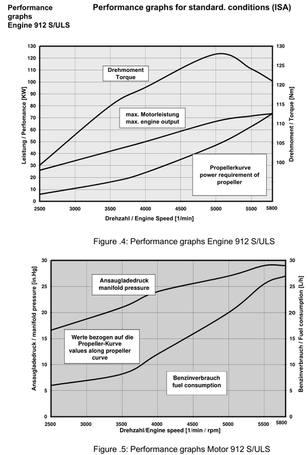

RFguy Posted June 21, 2022 Share Posted June 21, 2022 (edited) I am surprised of the comment that '5400 burns more fuel (implying less efficiency) , because the fuel usage per kW is still fairly linear in that region. Edited June 22, 2022 by RFguy Link to comment Share on other sites More sharing options...
Mike Gearon Posted June 22, 2022 Author Share Posted June 22, 2022 That’s good info. I guess it’s also a matter of experimenting with settings. I know when I chase my buddy who can run 140-145kn cruise (Blackshape retractable csu 912). and I’m maxed at 130-135kn 5400rpm (virus 912 csu) I’m using a load of fuel. Say 23-24 lph. I don’t want to slow him down too much so cop it. Link to comment Share on other sites More sharing options...
RFguy Posted June 22, 2022 Share Posted June 22, 2022 (edited) Mike, There is a slight increase in the slope in fuel consumption in that region , and a slight reduction in the slope of the engine output. two possibilities that come to mind : 1) If at WOT , or close, maybe that is the rich jet coming on ? 2) higher gas velocities are leading to higher fluid (the mixture) flow losses beyond the maximum torque point. I think the best place to CRUISE the rotax is where the engine output curve slope reduces just slightly, at the point of maximum torque- about 5100-5150 RPM. Edited June 22, 2022 by RFguy 1 Link to comment Share on other sites More sharing options...
