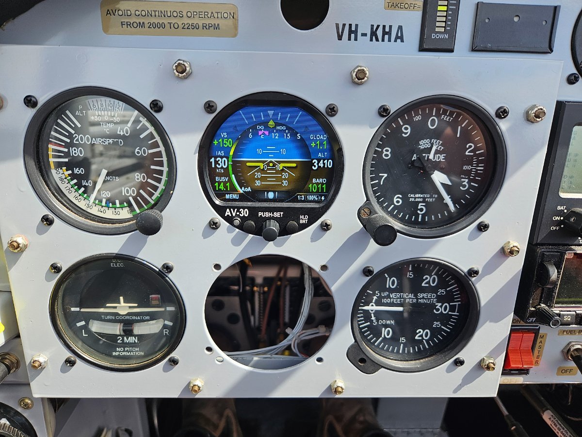

Thruster88 Posted January 20 Share Posted January 20 Just received my rebate for uAvionix tailbeaconX transponder and AV30C control head/EFIS. Removed the Vac system completely and saved 4.5kg. Stil use SkyEcho2 for traffic in on the tablet. It can see the tailbeaconX so a constant verification that adsb out and in is working. The AV30 is a beautiful little EFIS for those that like a traditional 6 pack, gives redundancy of airspeed and alt. Still a few months left to get a rebate. 4 1 Link to comment Share on other sites More sharing options...

Thruster88 Posted January 20 Share Posted January 20 (edited) 1 hour ago, Bosi72 said: Congrats! I've heard rebate is applicable to transponder only, not av30 ? Can you please confirm. Also how many working hours ($) for installation? Ballpark figure is fine 🙂 Thanks! Installation and 100.5 checks cost $2200, total cost just over 10k so got 1/2 back. My application number was 728 so a nice increase in equipped aircraft. Edited January 20 by Thruster88 1 Link to comment Share on other sites More sharing options...

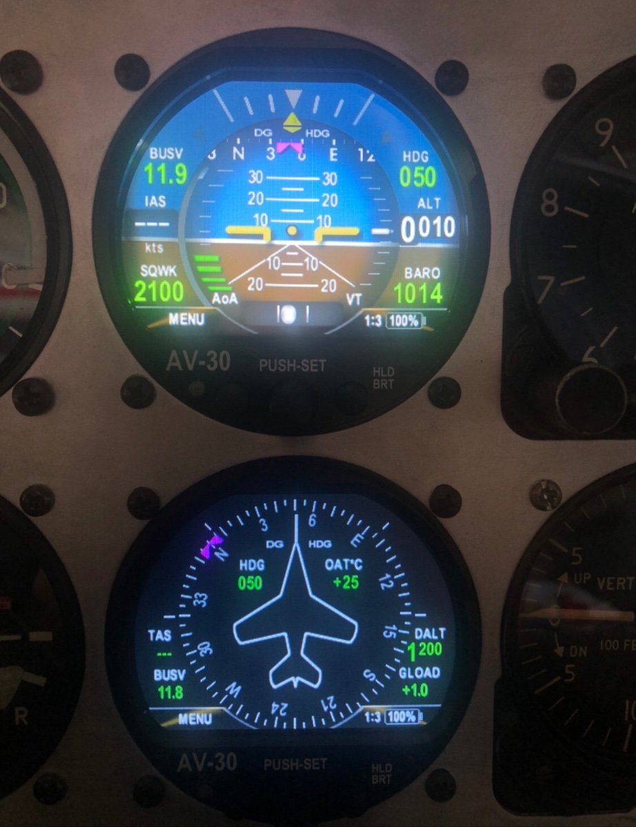

Area-51 Posted January 22 Share Posted January 22 9 minutes ago, IanR said: I have gone for the TailbeaconX and AV30C as well. Being installed next week. Looking forward to seeing how it goes. For me it killed two birds - my DG was dying so will use the AV30C as DG. I have found the DG floats a little too quickly; it required constant monitoring every five minutes even with the latest update. Installing the AVMAG and splitting it between both heads rectified this totally; after 90 minutes and three inflight clearoffs DG is still aligned to mechanical compass. Link to comment Share on other sites More sharing options...
IanR Posted January 22 Share Posted January 22 2 minutes ago, Area-51 said: I have found the DG floats a little too quickly; it required constant monitoring every five minutes even with the latest update. Installing the AVMAG and splitting it between both heads rectified this totally; after 90 minutes and three inflight clearoffs DG is still aligned to mechanical compass. Thanks - yes got that feedback so I have ordered the mag as well Link to comment Share on other sites More sharing options...
