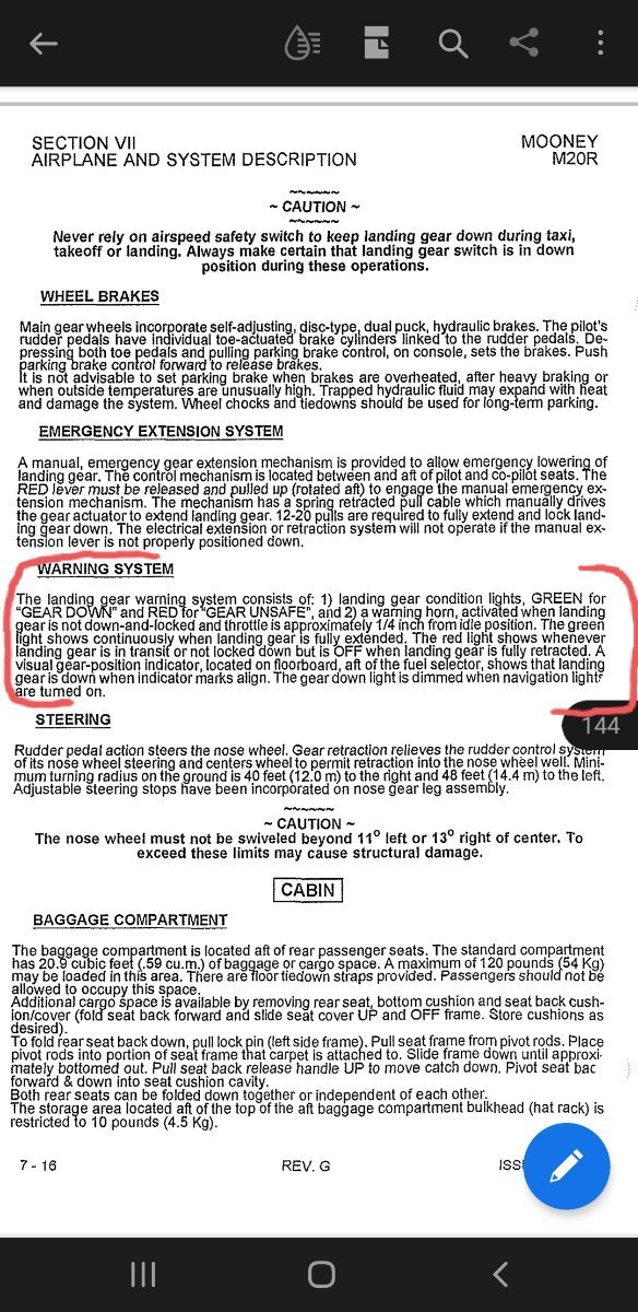

Bosi72 Posted May 18, 2023 Share Posted May 18, 2023 The POH says the warning horn is activated if gears are not down and locked and throttle is 1/4 from idle. But your Mooney might be a different version. The best is to test and confirm in training area. 1 1 Link to comment Share on other sites More sharing options...
