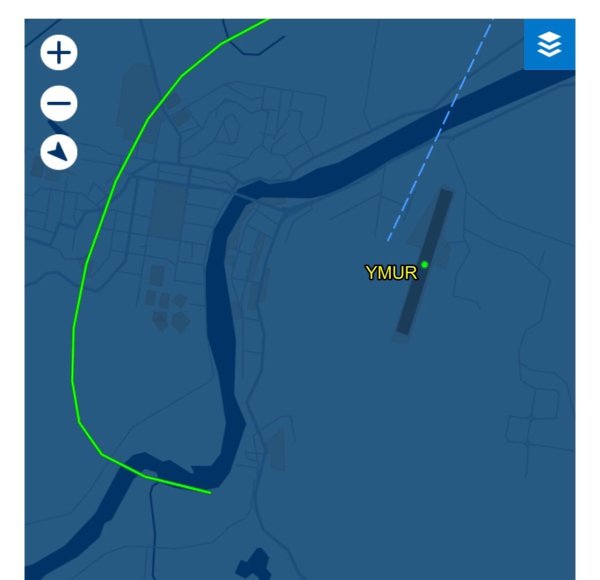

Area-51 Posted October 15, 2023 Share Posted October 15, 2023 Link to comment Share on other sites More sharing options...
RFguy Posted October 15, 2023 Share Posted October 15, 2023 how good is the ADSB coverage in the region at ground level- is this the termination of flight, or just the ADSB coverage limitation ? glen Link to comment Share on other sites More sharing options...
Area-51 Posted October 15, 2023 Share Posted October 15, 2023 (edited) 32 minutes ago, RFguy said: how good is the ADSB coverage in the region at ground level- is this the termination of flight, or just the ADSB coverage limitation ? glen Flat flood plains all the way to coolangatta. ADSB registers on the ground at YMUR, Tygalgah is just north of YMUR though. So must of happened on climb out Edited October 15, 2023 by Area-51 Link to comment Share on other sites More sharing options...
