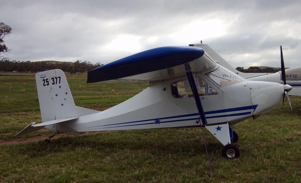

red750 Posted December 17, 2023 Share Posted December 17, 2023 I was going through some of my photos and I came across one that had a 2-3 format rego, rather than the normal 2-4 format. Can a rego of, say, 25-0999 be shown on the aircaft as 25-999? In other words, can the 0 in that location be dropped? (Note, that's not the real number in question.) Link to comment Share on other sites More sharing options...
kasper Posted December 17, 2023 Share Posted December 17, 2023 Absolutely yes. The regos were originally xx-xxx and when it was expanded to 4 digits the leading 0 was allowed under the tech manual prior to 4 to be omitted. all old aircraft rego are grandfathered so old reg 2-3 numerals still exist. 1 Link to comment Share on other sites More sharing options...
Kiwi Posted December 17, 2023 Share Posted December 17, 2023 Must have hyphen after first two digits displayed. My Drifter had 250404 on the boom and I had to change it to 25-404 or 25-0404 But you must use the full four digits during your radio calls ie: Drifter 0404. 1 Link to comment Share on other sites More sharing options...
red750 Posted December 17, 2023 Author Share Posted December 17, 2023 Thanks for that. The photo was that of an Australiann Lightwing Ga-55. There is nothing on the Hughes Engineering website more recently that 2021. Have they gone out of business? Link to comment Share on other sites More sharing options...
FlyingVizsla Posted December 17, 2023 Share Posted December 17, 2023 Hughes are still in business; we recently got parts for our Lightwing GA. They are more a general engineering works. Not making aircraft anymore AFAIK. AUF was short sighted and thought 999 planes would be the maximum. There were mistakes made early on. AUF issued the same number for 10- and 19- etc. Our Karasport was one that had to change the 10-number because there was a 19-same number (or whatever). Our Lightwing has 55-646, it should have a zero there now. Link to comment Share on other sites More sharing options...

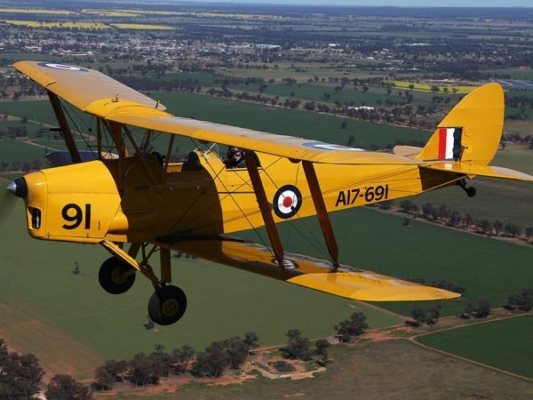

spacesailor Posted December 18, 2023 Share Posted December 18, 2023 So what or where is a rego, 17 - . Come from. It is on a " Tigre Moth '' . For sale . spacesailor Link to comment Share on other sites More sharing options...
facthunter Posted December 18, 2023 Share Posted December 18, 2023 IF you're searching, it's for a DH 82A TIGER Moth. produced here in 1941. It might be wearing it's service Number. Nev Link to comment Share on other sites More sharing options...
spacesailor Posted December 18, 2023 Share Posted December 18, 2023 Only the " A-17-626 " . Is on the fuselage, So is it the rgo number , or .is it something else . ( is a none registered number allowed ). $82,000 spacesailor Link to comment Share on other sites More sharing options...
turboplanner Posted December 18, 2023 Share Posted December 18, 2023 24 minutes ago, spacesailor said: Only the " A-17-626 " . Is on the fuselage, So is it the rgo number , or .is it something else . ( is a none registered number allowed ). $82,000 spacesailor Like this? Link to comment Share on other sites More sharing options...
spacesailor Posted December 18, 2023 Share Posted December 18, 2023 (edited) More like this Spacesailer Edited December 18, 2023 by spacesailor 1 1 Link to comment Share on other sites More sharing options...
turboplanner Posted December 18, 2023 Share Posted December 18, 2023 26 minutes ago, spacesailor said: More like this Spacesailer Yes the same as this with the Tigers. My cousin's uncle was a RAAF Instructor, killed at the Parafield Satellite field while teaching a student Blind Takeoffs. Link to comment Share on other sites More sharing options...

red750 Posted December 18, 2023 Author Share Posted December 18, 2023 This is the photo I referred to in the opening post. Does anyone on this site own or have owned this aircraft? Link to comment Share on other sites More sharing options...

FlyingVizsla Posted December 19, 2023 Share Posted December 19, 2023 2 hours ago, red750 said: This is the photo I referred to in the opening post. Does anyone on this site own or have owned this aircraft? From the RAAus register - 25-0377 Lightwing GA-55, serial Ga55-055, rego cancelled 18 Oct 2013. I'll have a look through my records to see if it comes up. A bit busy this time of year, so it might take time... Link to comment Share on other sites More sharing options...
FlyingVizsla Posted December 19, 2023 Share Posted December 19, 2023 From the Lightwing database: Manufacture #055 A.U.F Registration #25 377 Date: 14 June 1990 Area: Coonalpyn, SA. So it lasted 23 years and started in South Australia Link to comment Share on other sites More sharing options...
red750 Posted December 19, 2023 Author Share Posted December 19, 2023 Thank you F.V. Link to comment Share on other sites More sharing options...

FlyingVizsla Posted December 19, 2023 Share Posted December 19, 2023 Early AUF Regos From the AUF magazine Issue #47 p.19 August 1990. Ultralight Aircraft Registration Markings (snip) Ultralight aircraft registration markings are arabic numerals and hyphen, e.g., prefix 55 and registered number separated by hyphen - 55-1234 or the registered numbers only for CAO 95.10 aircraft - 1234 for 10-1234. (snip) except that leading zeros of registered numbers are not required, e.g., 10-0125 is 125, 55-0145 is 55-145 (snip). _______ So early AUF planes may display 123 (which is 10-0123) or 55-123 (which is 55-0123) Shows a bit of short sightedness in that other categories came in and the 10- had to be prefixed for clarity. The argument was that 95.10's didn't have the space for lots of numbers. 1 Link to comment Share on other sites More sharing options...
