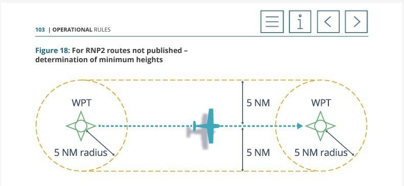

facthunter Posted December 24, 2023 Share Posted December 24, 2023 How far wide of track do you consider and is 500 feet enough?. LSALT gives more. Flying along valleys has it's place IF you know what you are doing and the LSALT would rule that out. It IS something but not everything. Nev Link to comment Share on other sites More sharing options...
turboplanner Posted December 25, 2023 Share Posted December 25, 2023 LSALT is not important for VFR flying, because you can only fly where you can see the mountaintops, although if you're going to be flying in mining areas, Tower locations can be important because they can be in the landing strip pattern or nearby and hard to see. However in a lot of IMC crashes the non-qualified pilot was able to maintain control but died by flying directly into a mountain, building etc. IMC pilots are required to identify Lowest Safe Altitude, not for the route on the screen, but for a path 5nm each side of the direct track, so you have to survey 10 nm of mountains x the route from point A to Point B and around each airport. This drawing is from CASR Part 91 General Operating and Flight Rules, Plain English Guide starting at Page 102 1 Link to comment Share on other sites More sharing options...
Ironpot Posted December 25, 2023 Share Posted December 25, 2023 12 hours ago, turboplanner said: LSALT is not important for VFR flying, because you can only fly where you can see the mountaintops, although if you're going to be flying in mining areas, Tower locations can be important because they can be in the landing strip pattern or nearby and hard to see. However in a lot of IMC crashes the non-qualified pilot was able to maintain control but died by flying directly into a mountain, building etc. IMC pilots are required to identify Lowest Safe Altitude, not for the route on the screen, but for a path 5nm each side of the direct track, so you have to survey 10 nm of mountains x the route from point A to Point B and around each airport. This drawing is from CASR Part 91 General Operating and Flight Rules, Plain English Guide starting at Page 102 It is important! I think you forgot NVFR!!!! The illustration should be 10 miles left and right of track and it’s only applicable if you’re TSO’d GNSS equipped; otherwise you have to calculate lowest safe by reference to the aids available. In practice, I think this pilot would be aware of “Grid” LSALT as shown on the ERC (not the VFR) chart. So just switch to ERC on your iPad/tablet and the big blue number indicates the LSALT for the grid square that you’re situated. 2 Link to comment Share on other sites More sharing options...
Ironpot Posted December 25, 2023 Share Posted December 25, 2023 Apologies I didn’t want to cause a debate on LSALT. Like everyone else, I try to learn something from these reports and take something a way that I can use, should I find myself in a similar situation. My personal solution will not work for everybody and l’m not suggesting non-instrument rated pilots even think of using this! Climbing to grid LSALT was 5200 (10 nm Amberley would be better and that’s 3400) but this guy would still be in cloud, and copping flak from ATS but on Autopilot and safe. ATS would’ve had him on radar and vectored him to safety somewhere. That’s what they are there for. I can’t imagine the shit he would’ve copped afterwards. But he was retiring 2 months later! Hey ho! 1 1 2 Link to comment Share on other sites More sharing options...

Roundsounds Posted December 26, 2023 Share Posted December 26, 2023 (edited) On 25/12/2023 at 7:31 PM, turboplanner said: LSALT is not important for VFR flying, because you can only fly where you can see the mountaintops, although if you're going to be flying in mining areas, Tower locations can be important because they can be in the landing strip pattern or nearby and hard to see. However in a lot of IMC crashes the non-qualified pilot was able to maintain control but died by flying directly into a mountain, building etc. IMC pilots are required to identify Lowest Safe Altitude, not for the route on the screen, but for a path 5nm each side of the direct track, so you have to survey 10 nm of mountains x the route from point A to Point B and around each airport. This drawing is from CASR Part 91 General Operating and Flight Rules, Plain English Guide starting at Page 102 I was taught to add 500’ to the highest terrain 5NM either side of the planned track as a rule of thumb LSALT. This helps in go / no go decision making if the weather deteriorates. The sole reliance on devices for planning reduces familiarisation with route terrain. Edited December 26, 2023 by Roundsounds 1 1 Link to comment Share on other sites More sharing options...
facthunter Posted December 27, 2023 Share Posted December 27, 2023 I'd prefer to use a bit more than 500', myself. Allowable errors take 400" of that and you're usiing BARO for reference which is mandatory for separation from other A/C but not ideal for terrain as it's based on ICAO Standard Atmosphere Nev 1 Link to comment Share on other sites More sharing options...
skippydiesel Posted December 27, 2023 Share Posted December 27, 2023 34 minutes ago, facthunter said: I'd prefer to use a bit more than 500', myself. Allowable errors take 400" of that and you're usiing BARO for reference which is mandatory for separation from other A/C but not ideal for terrain as it's based on ICAO Standard Atmosphere Nev I agree - 500 ft is way to slim a margine, you can lose that in a downdraft in "a blink of an eye". Link to comment Share on other sites More sharing options...
