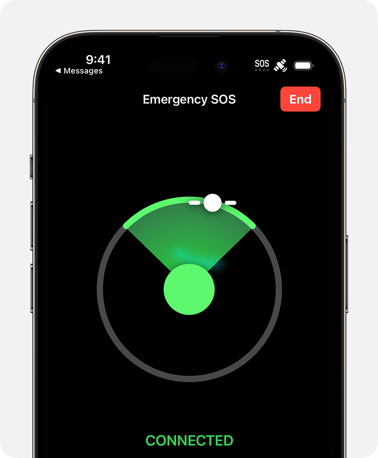

As a further line of defence (back-up for your PLB) recent iPhones
come with their own Sat-based SOS system which now works in Oz.
SUPPORT.APPLE.COM
With iPhone 14, iPhone 14 Pro, iPhone 15 or iPhone 15 Pro, you can use Emergency SOS via satellite to text emergency services when you're off the grid with no mobile and Wi-Fi coverage.
