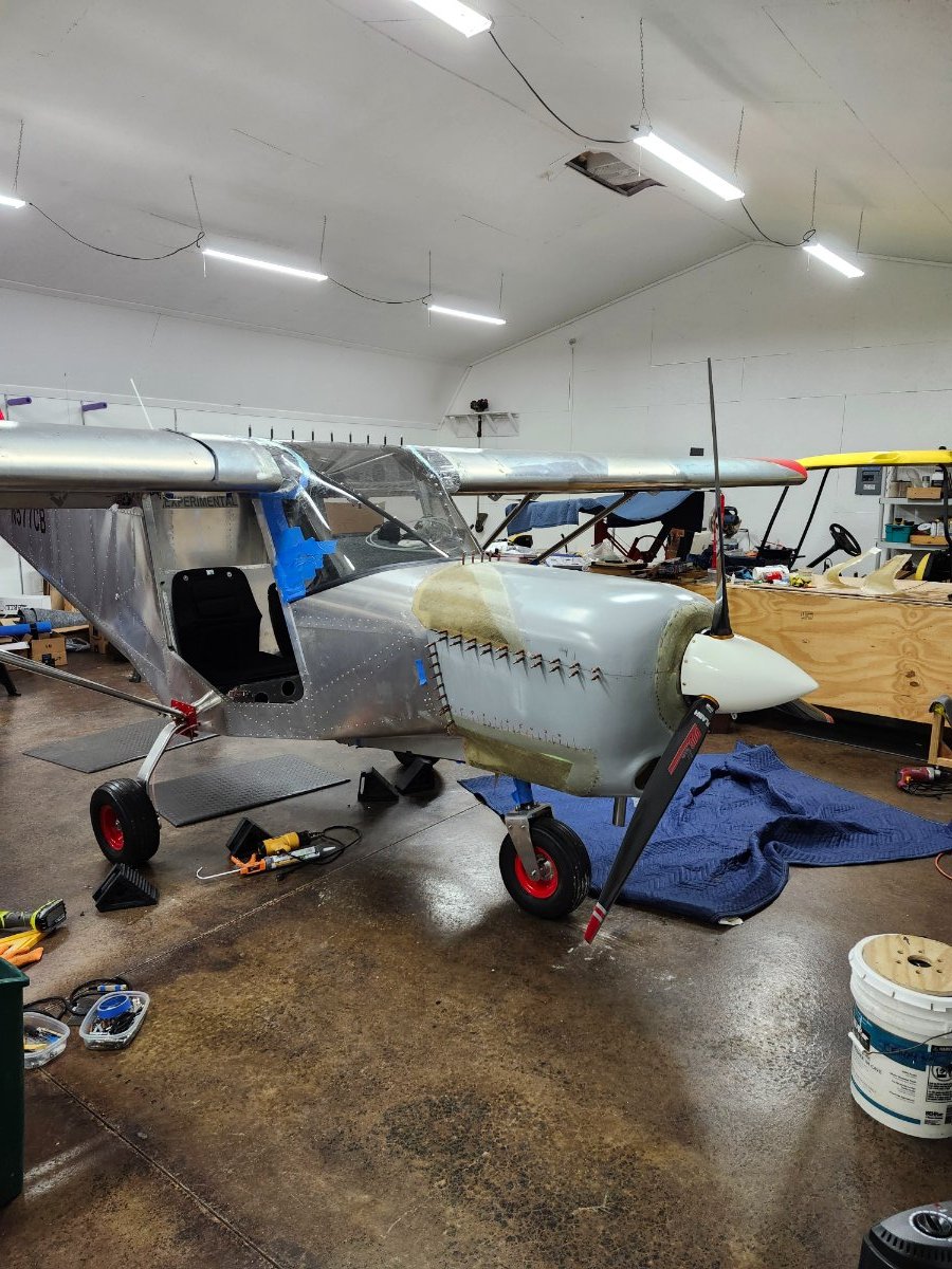

What prop diameters are you turning? And do you have the required minimum 7" ground clearance with the 15x6-6 tires?
I just mounted my prop and discovered that I only have 3.5" of ground clearance. I think I have the wrong prop. The nose fork will not accommodate a taller tire.

So a 70" prop with a rotax 912 on 15x6 tires will give you how much ground clearance????
I fly off of a grass field so I am concerned about ground clearance.

The problem isn't the prop size, it's that it's attached to the aircraft lower than with a 912.
Note this will also result in a different thrust line.
Also, unfortunately, just jacking up the front (which would need a much bigger tyre and the forks to take it etc.) is likely to result in less than ideal takeoff and landing behaviours:
On takeoff, the aircraft is rotated from the go, so will lift off at a low speed, whether you want that or not.
On landing, gusty weather may result in multiple touchdowns, as once all wheels are on, those high lift wings are sitting in a rotated attitude.

I truly appreciate all the input.
I acknowledge that I am installing a non-rotax engine and the elevation of the prop shaft may be different.
I understand the ramifications of raising up just the nose gear.
I contacted a guy that purchased all three Savannah S kits which included the 912 and prop. ICP sold him a 175cm(68.9") prop.
I received 180cm(70.9") which yields 3.5" of ground clearance.
If I convert to 22" tires(all three) from the 15" tires that would yield another 3.5" and bankrupt me at the same time 😂

Update:
Viking will replace the 71" with a 68" prop.
They will also supply a nose gear spacer.
I may change the main gear tires to make up for the nose gear spacer after a few crow hops.
  • Like 3
I also read the Stolspeed.com prop study that you all suggested.
That guy does get work. His study uncovered that the cruise speed remains essentially the same for all props he tested but climb rate would be affected from going down to a 68 from a 71. I can live with the that since I this is not a Stol competition plane

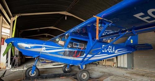

The Facebook link was just to show a pic of a Savannah with an extremely extended nose gear.
Attached is the pic.

Re the jacked up nose leg on the Savannah, yep seen that here a few places.  Just great if you want an aircraft where it’s really hard to get the nose wheel off early in your take off roll and just as hard to hold off in the flare  and with the greater leverage make it much easier to break……
 IF it's hard to rotate the Mainwheels are too far back. It's nice/ necessary to be able to DECIDE when the plane is going to lift off, particularly in gusting crosswinds. You can't hold it down with an extended nose wheel  set up either.. Uncontrolled weight on the nosewheel at speed isa recipe for loss of directional control. With a tailwheel set up you can PIN it on. I'm NOT suggesting everyone should fly a tailwheel .. I doubt they will ever disappear though. No nosewheel is built to take the whole weight of the aeroplane and most of us should try harder to keep the weight OFF it. Nev
