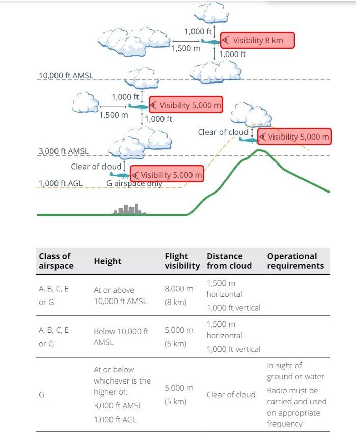

aro Posted May 14 Share Posted May 14 34 minutes ago, turboplanner said: if you have the situational awareness that some people have referred to, and you are flying legally, the cloud you see will be at least 5 kilometres away If the 5km applies to distance from cloud, how do you explain the requirements to be 1000m horizontally from cloud above 3000', or clear of could below 3000' / 1000' AGL? Wouldn't they be redundant? 2 Link to comment Share on other sites More sharing options...
Area-51 Posted May 14 Share Posted May 14 (edited) 46 minutes ago, aro said: If the 5km applies to distance from cloud, how do you explain the requirements to be 1000m horizontally from cloud above 3000', or clear of could below 3000' / 1000' AGL? Wouldn't they be redundant? 5000 regards visibility not minimum distance from cloud. These aspects are provided for by NAIPS in a TAF Edited May 14 by Area-51 2 Link to comment Share on other sites More sharing options...
turboplanner Posted May 14 Share Posted May 14 48 minutes ago, aro said: If the 5km applies to distance from cloud, how do you explain the requirements to be 1000m horizontally from cloud above 3000', or clear of could below 3000' / 1000' AGL? Wouldn't they be redundant? I posted the VFRG distance diagramme on the previous page. Note that based on altitude the visibility requirement extends to 8 km. Link to comment Share on other sites More sharing options...
aro Posted May 14 Share Posted May 14 2 minutes ago, turboplanner said: I posted the VFRG distance diagramme on the previous page. Note that based on altitude the visibility requirement extends to 8 km. Yes I know, I’m just questioning whether you understand it. Link to comment Share on other sites More sharing options...

turboplanner Posted May 15 Share Posted May 15 31 minutes ago, aro said: Yes I know, I’m just questioning whether you understand it. Yes I do. Link to comment Share on other sites More sharing options...
aro Posted May 15 Share Posted May 15 3 hours ago, turboplanner said: the cloud you see will be at least 5 kilometres away See the column that says Distance from cloud? It says 1500m horizontal, or Clear of cloud at or below 3000 AMSL or 1000 AGL - not 5km. Link to comment Share on other sites More sharing options...
turboplanner Posted May 15 Share Posted May 15 29 minutes ago, aro said: See the column that says Distance from cloud? It says 1500m horizontal, or Clear of cloud at or below 3000 AMSL or 1000 AGL - not 5km. Here is the diagramme I posted earlier with the distances shown by the figures in the red rectangles. Link to comment Share on other sites More sharing options...
BurnieM Posted May 15 Share Posted May 15 Can we just accept that distance from cloud and visibility are not as defined as they should be ? Visibility is generally acknowledged to be in the direction of travel. Arguing about this when we all (should) know what is meant is not meaningful. 1 Link to comment Share on other sites More sharing options...
facthunter Posted May 15 Share Posted May 15 THEY are defined as they should be. It's just a matter of getting it right. Nev Link to comment Share on other sites More sharing options...

aro Posted May 15 Share Posted May 15 20 hours ago, turboplanner said: Here is the diagramme I posted earlier with the distances shown by the figures in the red rectangles. Try again - the word you are looking for is "cloud". Visibility is how far away you can see things you don't want to fly into - clouds, mountains etc. Clouds are - well, clouds. If visibility is 5000m you can't even see a cloud until it is closer than 5000m. Link to comment Share on other sites More sharing options...
