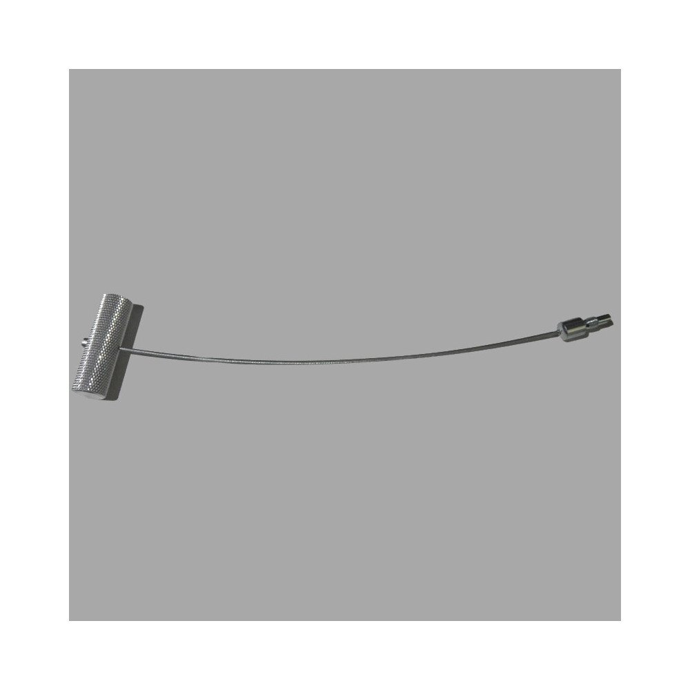

spacesailor Posted April 2 Posted April 2 (edited) Automotive tyre stems Are larger then the hole in the rim . Not tubed , so tubeless stem is ' lubed ' & pulled through with great strength . The reason your worker can't do it .he's lost muscle strength. I use a ' claw ' hammer to ease it through. I also have the correct pulllthroug spacesailor Edited April 2 by spacesailor Two pics

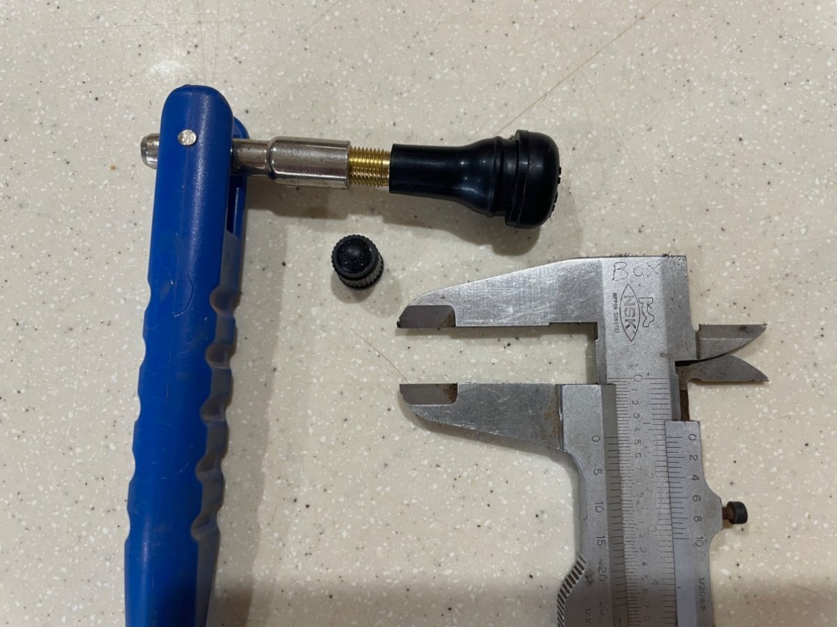

Moneybox Posted April 2 Posted April 2 On 02/04/2025 at 6:34 AM, Blueadventures said: I'd suggest revisiting the tyre shop and measure their stem size and the normal wheel it goes into. Then you can compare your size. (eg if your stem is same as ones at tyre shop then your hole must be too smaller an id. You could then consider drilling or reaming your rim hole and dress the edges, so they are not sharp, so no mechanical damage occurs in service. Expand Don't do too much for now. I've got valve stems and a rim or two so I'll measure it. Normally you'll just lube it a little with anything suitable for rubber, silicone grease, tyre lube, lanolin grease, soap or whatever. The valve stem is inserted from the inside and pulled through to the outside using a suitable puller made for the job (it screws on where the valve cap fits). Fitting it takes perhaps five seconds all up.
Moneybox Posted April 2 Posted April 2 (edited) I just measured a VW rim that is 11.5mm, about the usual size. If pulled through from the inside out very little effort is required. I have this little tool just because it was as cheap as chips on TEMU but a normal "T" shaped valve tool from your local auto parts store will easily do it. You are correct the valve stem od is 14.5mm but it easily compresses into the 11.5mm hole. Edited April 2 by Moneybox

Moneybox Posted April 2 Posted April 2 On 02/04/2025 at 10:38 PM, sfGnome said: Yes, they are bolt together, but with an O-ring to seal the halves. I have received and answer from ICP (they are super helpful and quick, which ameliorates somewhat the less-than-helpful assembly manual). Anyhow, the answer was “expand the hole”. Unfortunately, Federico didn’t suggest by how much the hole should be expanded, but I’ll start with MB’s measurement and go from there. Expand My VW rim with the 11.5mm hole is typical of automotive rims with the valve stem shown. Your valve stem is very short so I'm guessing the brass insert for the valve extends down to the area you need to compress. That's going to make it very difficult. You could just go with automotive valve stems although the length might run into the hub making inflation difficult.
