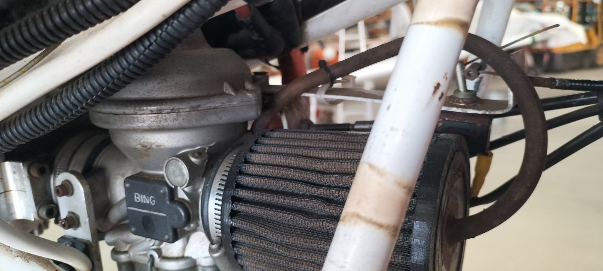

BrendAn Posted July 11, 2024 Posted July 11, 2024 On 11/07/2024 at 7:44 PM, Red said: Brendan, what is that black round thing with a rod or tube sticking out of its centre that appears to be directly behind the air filter element? Expand It's a hose. I forget what it's there for. Will have a look when I get home and let you know. 1
Thruster88 Posted July 11, 2024 Posted July 11, 2024 On 11/07/2024 at 7:53 PM, BrendAn said: It's a hose. I forget what it's there for. Will have a look when I get home and let you know. Expand Crankcase breather to stop the skins getting oil soaked? 2

BrendAn Posted July 12, 2024 Posted July 12, 2024 On 11/07/2024 at 9:54 PM, Thruster88 said: Crankcase breather to stop the skins getting oil soaked? Expand crank breather runs to catch can. i did trace that hose on the airfilter but i forget what it was for. will check tomorrow 1
Red Posted July 12, 2024 Posted July 12, 2024 On 12/07/2024 at 1:35 AM, spacesailor said: Aren't those airfilters supposed to be oiled . Likewise the foam filters . spacesailor Expand Yes both types should be oiled 1
Red Posted July 12, 2024 Posted July 12, 2024 On 12/07/2024 at 1:47 AM, BrendAn said: crank breather runs to catch can. i did trace that hose on the airfilter but i forget what it was for. will check tomorrow Expand Does it actually go into the filter?, perhaps a makeshift primer? 1

BrendAn Posted July 13, 2024 Posted July 13, 2024 The hose must be for carb vacuum or maybe a vent ?. It just loops over to a nipple on the carby.

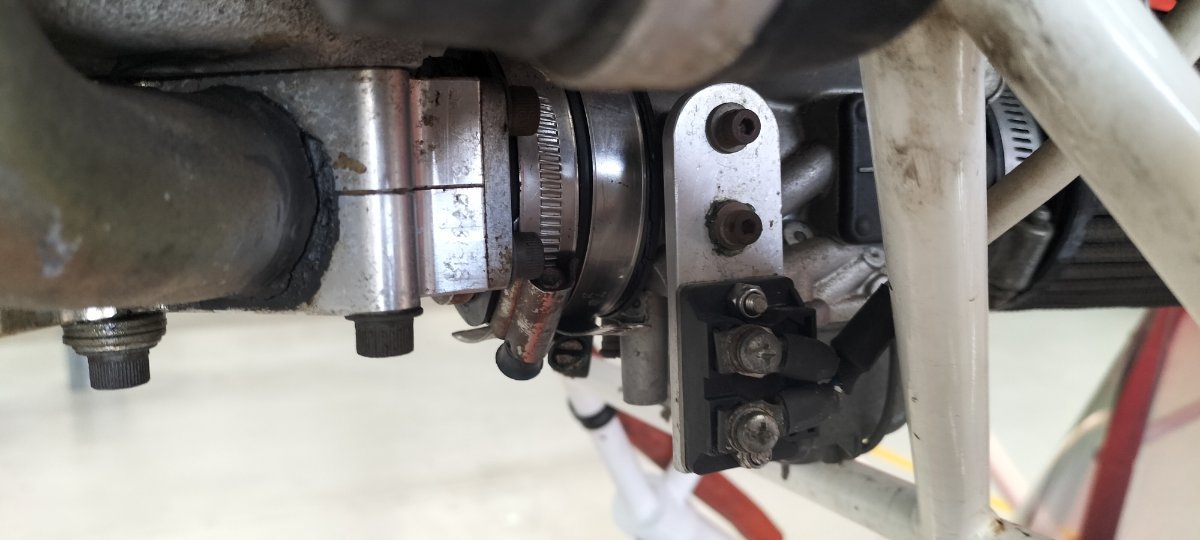

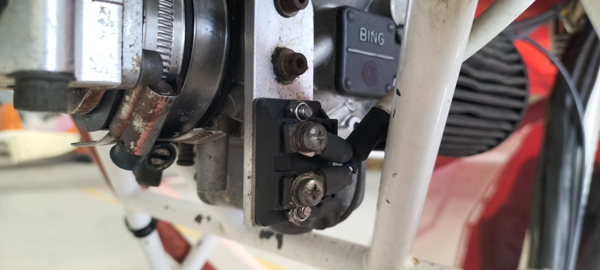

BrendAn Posted July 13, 2024 Posted July 13, 2024 And how does this carb heat work.does it just warm the body of the carb. Its a flat plate with 2 wires attached to it.
skippydiesel Posted July 13, 2024 Posted July 13, 2024 On 13/07/2024 at 5:20 AM, BrendAn said: The hose must be for carb vacuum or maybe a vent ?. It just loops over to a nipple on the carby. Expand It likly the carburettor float bowl breather/overflow. Its supposed to terminate in an area of atmospheric pressure thats the same as the carburettor air intake. 1
facthunter Posted July 13, 2024 Posted July 13, 2024 Venting it in the wrong place makes the mixture go for a Whoopsie. Bit of a trap for young players . Nev 1
Red Posted July 13, 2024 Posted July 13, 2024 On 13/07/2024 at 6:17 AM, skippydiesel said: It likly the carburettor float bowl breather/overflow. Its supposed to terminate in an area of atmospheric pressure thats the same as the carburettor air intake. Expand Seeing the pictures that's exactly what it is, I have done the same except with a shorter hose that enters the opposit end of the filter near the carb throat avoiding the loop...does the same thing 2
Red Posted July 13, 2024 Posted July 13, 2024 (edited) On 13/07/2024 at 5:22 AM, BrendAn said: And how does this carb heat work.does it just warm the body of the carb. Its a flat plate with 2 wires attached to it. Expand Yea they are just a resistor that affixs to carb body near the area where the butterfly is located, as much use as a chocolate teapot imo Edited July 13, 2024 by Red 1
