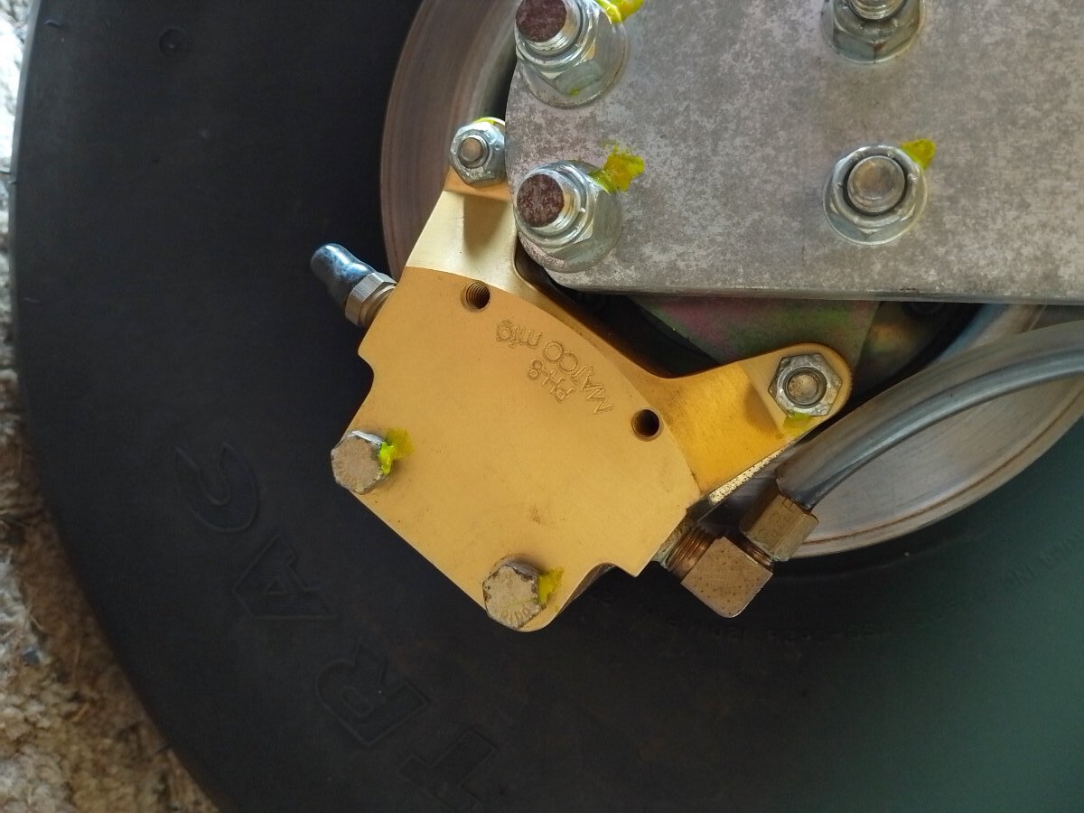

danny_galaga Posted Monday at 04:46 AM Posted Monday at 04:46 AM I figured the engine section is the best place to ask My plane has matco ph-8 disk brakes. The right one is getting much hotter than the left one. Have to add extra herbs after landing to taxi. And much harder to push back into the hangar. It looked a bit glazed, so I was hoping maybe it's suffering from a positive feedback loop whereby the more it overheats, the more glazed it becomes. The more glazed the hotter it gets. I took the caliper off, and de glazed with wet and dry and water. Also touched up the pads with wet and dry on a flat surface. The system is comically simple, and everything thing seems to moving. Pressing the brake pedal gently showed the piston moving. The caliper sliding thing slides. I'm at a loss! If I don't hear of any easier things to try by tomorrow, I'll swap left caliper for right (they are symmetrical) and see if the problem follows it.

BrendAn Posted Monday at 05:37 AM Posted Monday at 05:37 AM On 16/06/2025 at 4:46 AM, danny_galaga said: I figured the engine section is the best place to ask My plane has matco ph-8 disk brakes. The right one is getting much hotter than the left one. Have to add extra herbs after landing to taxi. And much harder to push back into the hangar. It looked a bit glazed, so I was hoping maybe it's suffering from a positive feedback loop whereby the more it overheats, the more glazed it becomes. The more glazed the hotter it gets. I took the caliper off, and de glazed with wet and dry and water. Also touched up the pads with wet and dry on a flat surface. The system is comically simple, and everything thing seems to moving. Pressing the brake pedal gently showed the piston moving. The caliper sliding thing slides. I'm at a loss! If I don't hear of any easier things to try by tomorrow, I'll swap left caliper for right (they are symmetrical) and see if the problem follows it. Expand I think you will find a tight piston. . Can you push the piston In by hand 1
Blueadventures Posted Monday at 05:50 AM Posted Monday at 05:50 AM On 16/06/2025 at 4:46 AM, danny_galaga said: I figured the engine section is the best place to ask My plane has matco ph-8 disk brakes. The right one is getting much hotter than the left one. Have to add extra herbs after landing to taxi. And much harder to push back into the hangar. It looked a bit glazed, so I was hoping maybe it's suffering from a positive feedback loop whereby the more it overheats, the more glazed it becomes. The more glazed the hotter it gets. I took the caliper off, and de glazed with wet and dry and water. Also touched up the pads with wet and dry on a flat surface. The system is comically simple, and everything thing seems to moving. Pressing the brake pedal gently showed the piston moving. The caliper sliding thing slides. I'm at a loss! If I don't hear of any easier things to try by tomorrow, I'll swap left caliper for right (they are symmetrical) and see if the problem follows it. Expand Is the piston returning (coming off, the pad retracting off the disk surface); if not that cause heat. 1
kgwilson Posted Monday at 06:41 AM Posted Monday at 06:41 AM I agree with Brendan. I reckon the piston is not returning after braking. Pull the whole wheel cylinder apart & check for rub marks grit etc, clean everything meticulously, reassemble & make sure moving parts i.e. the piston moves freely. 1 1
BrendAn Posted Monday at 06:47 AM Posted Monday at 06:47 AM When you own Honda road bikes you learn about sticky brake pistons 1
Thruster88 Posted Monday at 07:49 AM Posted Monday at 07:49 AM (edited) My friend once had a similar problem in his Socata TB10 Tobago. Problem turned out to be the master cylinder was not able to fully retract so hydraulic pressure could not be released to the reservoir. The hotter it got the harder the brake grabbed. Do you have a park brake valve or anything that might be holding pressure. Wrong fluid and swollen orings? Edited Monday at 07:50 AM by Thruster88 1
facthunter Posted Monday at 09:12 AM Posted Monday at 09:12 AM I'm with Thruster. Check residual pressure in the specific brake line. Crack the Bleed. That master cyl may not be porting. Check there's some free play before the Piston moves. Your pads may be too thick also. Nev 1 1

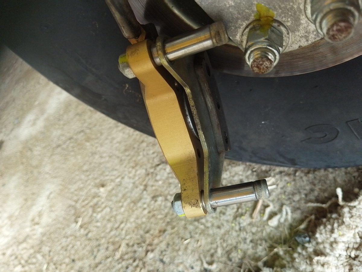

danny_galaga Posted Wednesday at 02:29 AM Author Posted Wednesday at 02:29 AM solved! I think 😄 Another pilot in the hangar asked what the grease on the sliding pins on the caliper looked like. But when I took the right one off a few days ago it was clean as a whistle and I just assumed that's how they are. But I shouldn't be surprised with this kit. He said any similar brakes he's ever worked on always had a thin smear of grease. I happened to have some anti seize grease which seems ideal for this job. Did both calipers. Two landings and a taxi back to the hangar gave me a much more respectable 35 ish degrees, both brakes with ambient of about 18° Will try the park brake tomorrow. I wanted to keep potential multiple issues separate.
skippydiesel Posted Wednesday at 03:00 AM Posted Wednesday at 03:00 AM Grease & brakes are not usually compatible - always a first time. If going down the slipy track, I suggest using a high temperature lubricant, like graphite, rather than an oil based lubricant.😈
BrendAn Posted Wednesday at 04:27 AM Posted Wednesday at 04:27 AM On 18/06/2025 at 2:29 AM, danny_galaga said: solved! I think 😄 Another pilot in the hangar asked what the grease on the sliding pins on the caliper looked like. But when I took the right one off a few days ago it was clean as a whistle and I just assumed that's how they are. But I shouldn't be surprised with this kit. He said any similar brakes he's ever worked on always had a thin smear of grease. I happened to have some anti seize grease which seems ideal for this job. Did both calipers. Two landings and a taxi back to the hangar gave me a much more respectable 35 ish degrees, both brakes with ambient of about 18° Will try the park brake tomorrow. I wanted to keep potential multiple issues separate. Expand you threw us off at the start when u said the calipers were sliding ok. antisieze is fine. it has a high temp tolerance . 2
