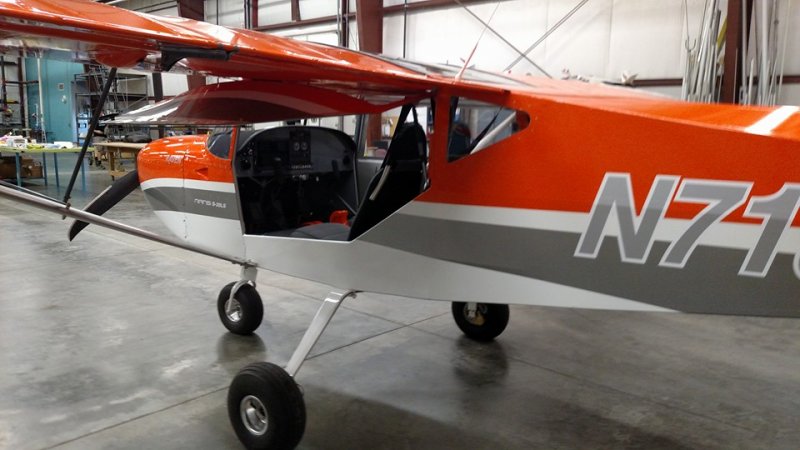

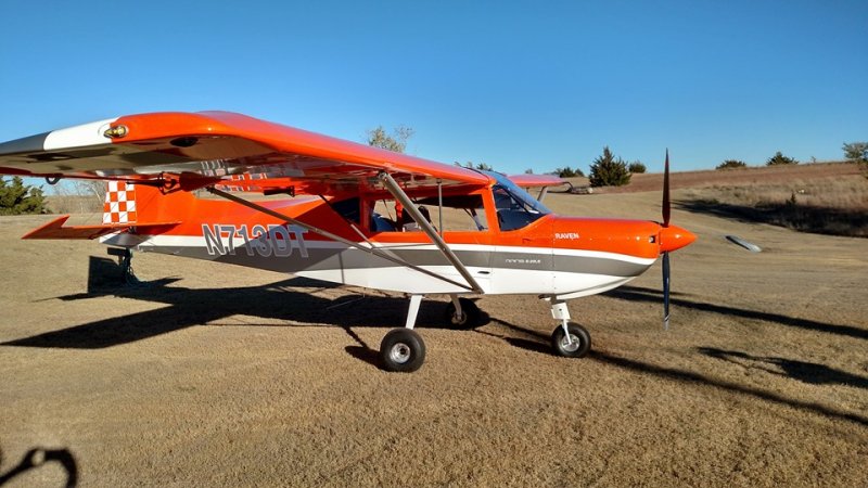

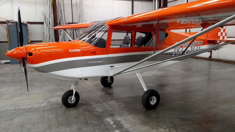

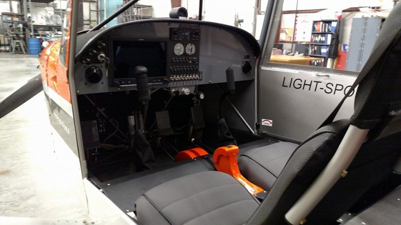

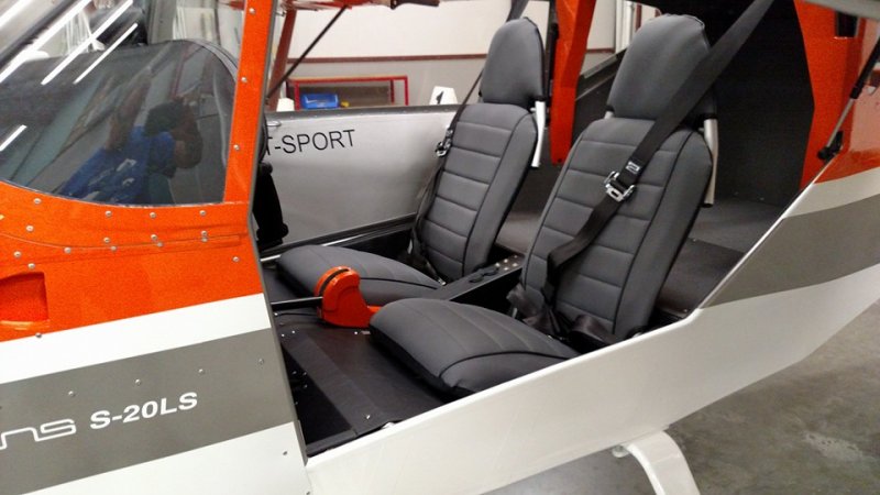

As you know when the funds are forthcoming I want to start the next build project and the Rans S-20 Raven is the one I have picked all bar having a flight in one first but Randy Schlitter posted these photos today of the new LSA version with the trike gear...how sexy does this look?

Lovely!! I think it looks better in the nose-dragger version.
Yes I like the taildragger too but the beauty of this one is you can go either way just about an hour to do the change over so one day you can fly as a tail dragger the next a nose dragger

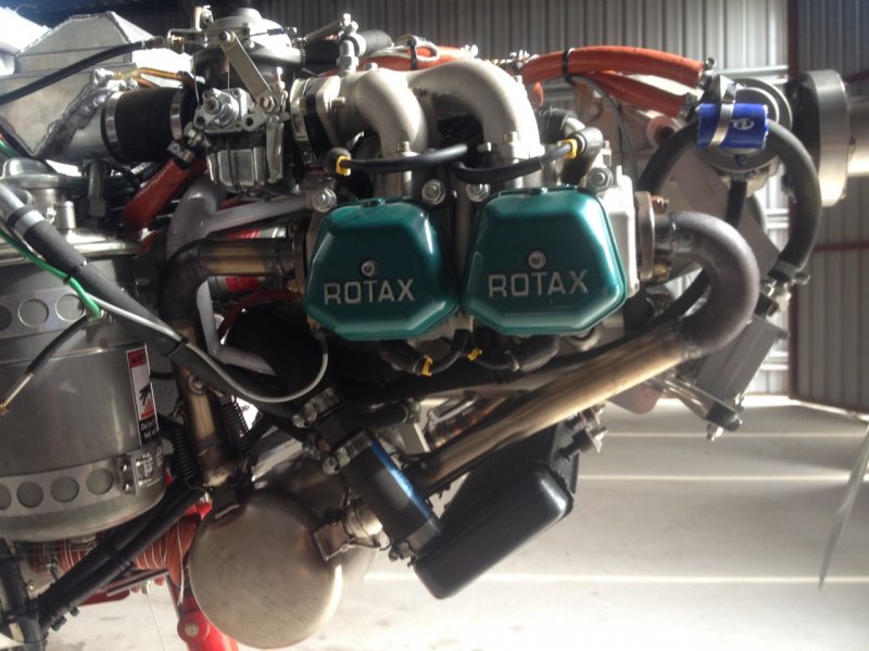

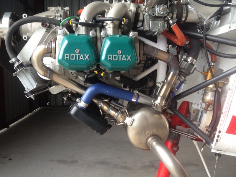

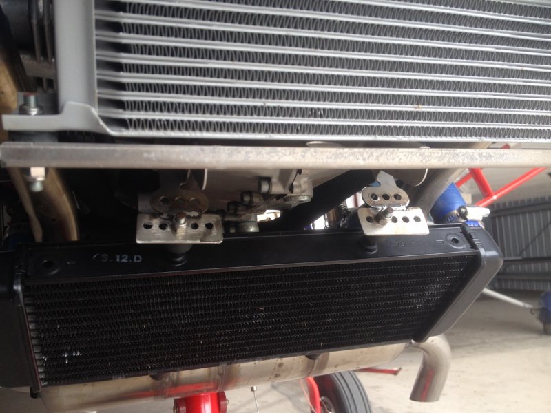

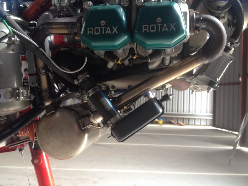

Finally got the exhaust system welded completely. My mate who did the welding couldnt get here and Danny Leach was working with Roger a couple of hangars down so I cut and fitted the last pipe to make it fit and Danny kindly tigged it for me. He did a great job too. I have lowered the radiator to clear the tension springs just by adding some plates with extra holes for adjustment onto the existing radiator brackets. This worked quite well. Dragged the girlfriend out of the hangar and fired her up. Well it certainly sounds different and seems to have more accelleration. Interesting is that at full power I was only getting 5100 while held there I thought I had more previously. I will know soon as I will put the original system back on and do the same test but my initial feeling is there is a fair bit more instantaneous power than before. I am going to mold the bottom cowl so I can keep a original and then the mould can be used to make a standard one and then I will modify it to maake one for the new system. This way I can still fly the girlfriend while doing some more work but will see after I give it another ground run with the original system

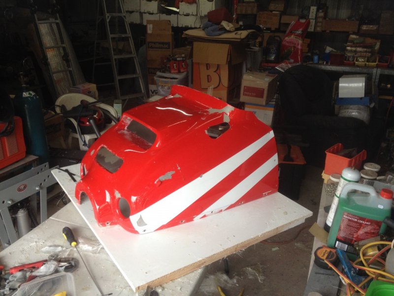

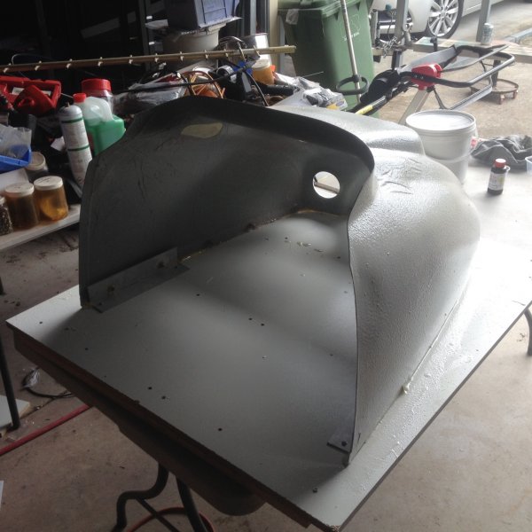

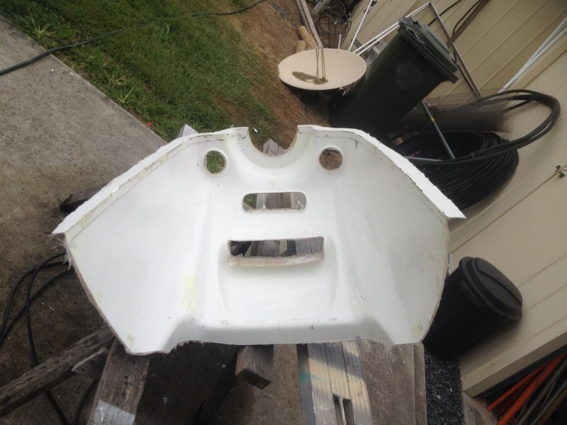

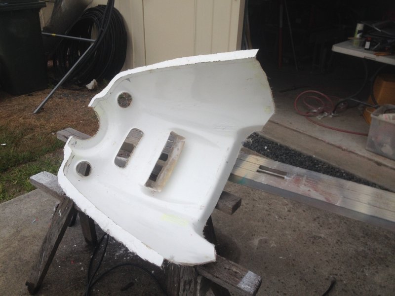

Its been a hectic few weeks here but during the week I got my lower cowl back home and mounted it on a base plate. Did the usual waxing then PVA release agent. Danny leach came over with some gelcoat yesterday and sprayed the cowl. This morning I am starting to glass up the mold. Hopefully by the end of the day it will be finished and in a day or 3 I can hopefully get my cowl out of the mold and I will have a bottom cowl mold ready to lay up a new cowl that I can then modify for the new Rotax muffler system. I will be away for the next 2 weekends so cant do much but hopefully can get to do more testing with the rotax muffler fitted then I will change it all back to the ICP muffler and put my original cowl back on and can do some flying while I lay up the new cowl then I will need to put the Rotax system back on and fit the new cowl and modify it. I will obviously fly the girlfriend with a unpainted cowl to see what the actual difference is.

Did you work out if the new muffler gives you a bit more take off ooomf?
Hi Hank
I havent had the time to get back to it lately although I have been making a new mold so I can knock out a new lower cowl. The initial testing I did shows promise for sure. Engine RPM didnt seem to be more but havent done the comparison yet that will be this weekend I will have a better idea. But on first impressions there is a big difference in throttle response the engine accellerated heaps faster. But will know more this weekend as I am currently in Melbourne will be flying home tomorrow afternoon then lots to do at work. Not enough hours in the day at the moment.

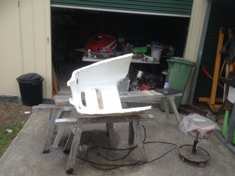

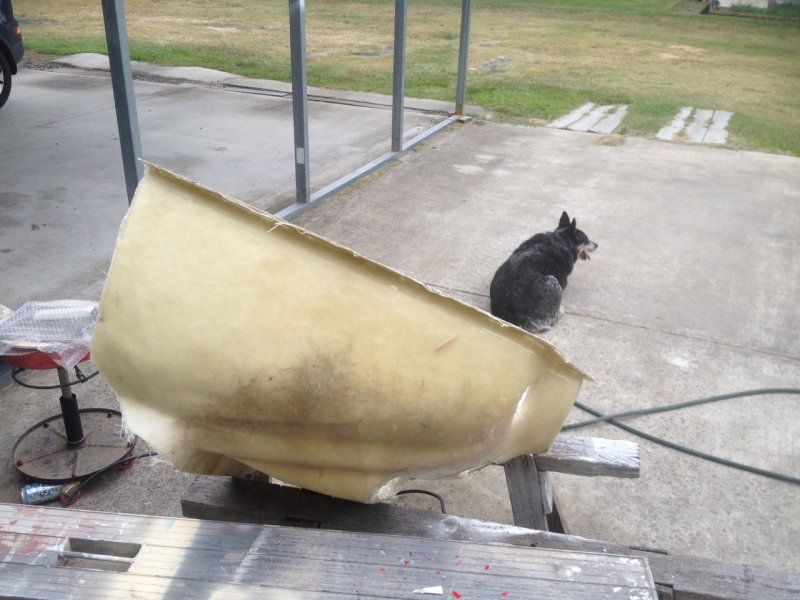

One would have thought that with all the fibreglassing I have done with model jets over the past 20 years I would have learnt something. Obviously not..... Wanting to get the new cowl mold done pretty quickly as I want to get the girlfriend back into a flying state even with the original exhaust system until I get a new cowl made from the mold I didnt give much thought to how the mold should have been done. It really needed to be split right down the middle to a left and right side. There is a section at the bottom of the cowl that has the air scoop for the radiator. It has a section in it that wont allow you to get the cowl out in one piece. It comes back in on itself slightly so getting it out has been a misson and a half. Trying to get it out I have wrecked the original paint job on my cowl so need to sand it all back and repaint it. Oh well no drama I can get that done pretty quickly only a couple of days. But I will now have to split the mold I have made otherwise I wont be able to get the new cowl out of the mld when I make it. Splitting it now will make a slight difference to the size but that wont really matter. Hopefully I can get the original cowl ready for painting this week and get it done by next weekend. I have to do some repairs to the mold and then split it but it will be all fine just a few hours extra work.

One would have thought that with all the fibreglassing I have done with model jets over the past 20 years I would have learnt something. Obviously not..... Wanting to get the new cowl mold done pretty quickly as I want to get the girlfriend back into a flying state even with the original exhaust system until I get a new cowl made from the mold I didnt give much thought to how the mold should have been done. It really needed to be split right down the middle to a left and right side. There is a section at the bottom of the cowl that has the air scoop for the radiator. It has a section in it that wont allow you to get the cowl out in one piece. It comes back in on itself slightly so getting it out has been a misson and a half. Trying to get it out I have wrecked the original paint job on my cowl so need to sand it all back and repaint it. Oh well no drama I can get that done pretty quickly only a couple of days. But I will now have to split the mold I have made otherwise I wont be able to get the new cowl out of the mld when I make it. Splitting it now will make a slight difference to the size but that wont really matter. Hopefully I can get the original cowl ready for painting this week and get it done by next weekend. I have to do some repairs to the mold and then split it but it will be all fine just a few hours extra work.[ATTACH=full]39952[/ATTACH] [ATTACH=full]39953[/ATTACH] [ATTACH=full]39954[/ATTACH] [ATTACH=full]39955[/ATTACH] [ATTACH=full]39956[/ATTACH] [ATTACH=full]39957[/ATTACH]
That sounds frustrating and like a lot of extra work. pull_hair.gif.3994f465d56951521f66ae0593c25df0.gif

If I want to fly her with the cowl the way it is it will only take an hour to swap over the exhaust systems. But I think I will repaint the cowl first. I will start the sanding tomorrow after work but I have to go up the farm on thursday night got a funeral in Bundy on friday should be back here on sat arvo or sunday morning so hopefully its ready for painting. I am on holidays from this thursday arvo for 3 weeks and will have until the 27th before we go back up the farm for about 8 days or so. So should have her flying again sometime after this weekend coming.

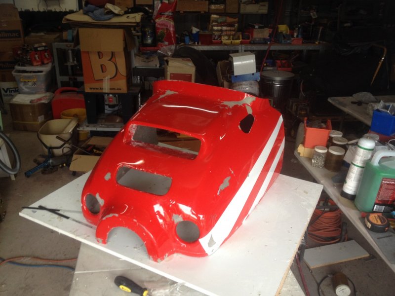

Well best laid plans....tried to get the lower cowl ready for paint before we went away up to our farm but just too much to do and the filler is used didnt go off very well so had to strip it all off...that pissed me off so didnt get back to it. So I put it in the car with the rest of the gear in the trailer and bought it up here to the farm as I knew I would get some time to work on it in the 9 days we are here.
Oops..pressed the wrong button...anyway had the guy come and look at my hangar up here to repair the doors after the tornado went through here a month of so ago. He found some other damage to the hangar so I have cleaned up the area he needs to work in and also put my workbench and some storage shelves in so what better way to christen aircraft work in the hangar. Yesterday I finished sanding the cowl then I undercoated it...rubbed it back a bit then hit it with the old spray putty. Sanded that again this arvo its not finished yet but almost there. Will get to that tomorrow then hit it with another coat of undercoat and when I get home on tuesday I will wet sand it and it should be ready for painting...so hopefully it will be finished and back on the plane by the end of the week

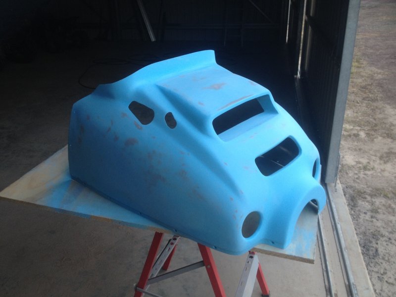

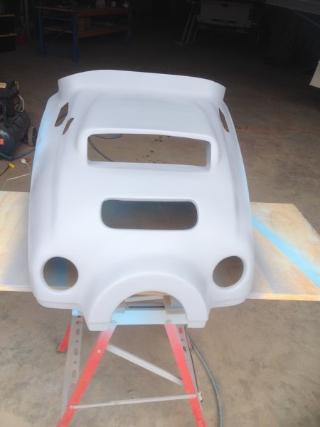

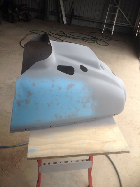

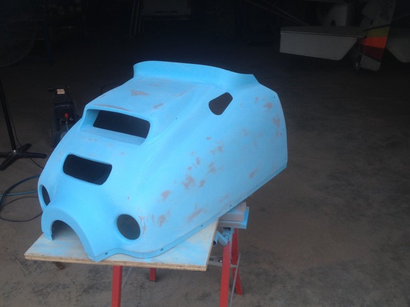

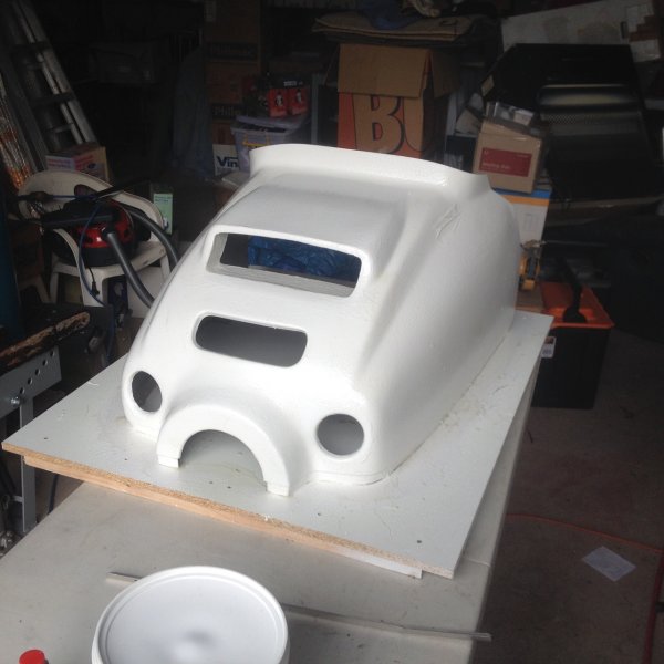

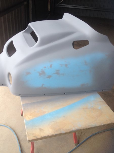

I was trying to upload these pics while I was away but they didnt want to play the game on the wireless broadband...so here they are...sanded the spray putty back further than in the photos then proceeded to undercoat . The cowl is now back home will wet rub it tonight and hopefully the weather will be kind tomorrow and I can get some paint on it
  • Like 3
Looking good!, but as they say the final finish is as good as the preparation, which you are doing.
A slower but thorough job simply takes a bit longer, but is well worth the effort in the long run.
Are you finishing it with 2pac?
Yes the original paint is 2pack...its Protec paint. I have some left over when I painted it when I built the plane. So it will all match
