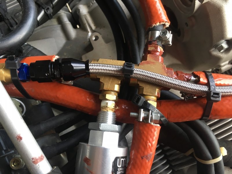

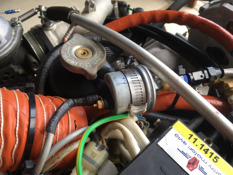

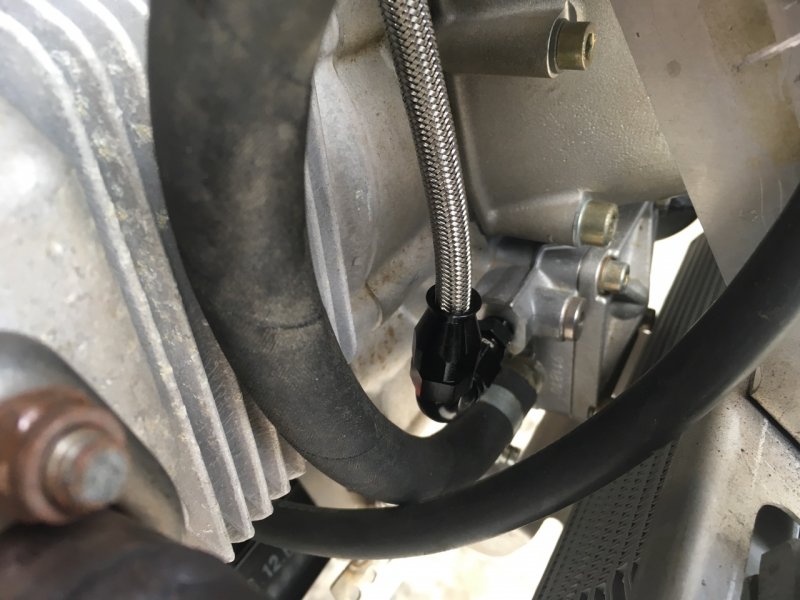

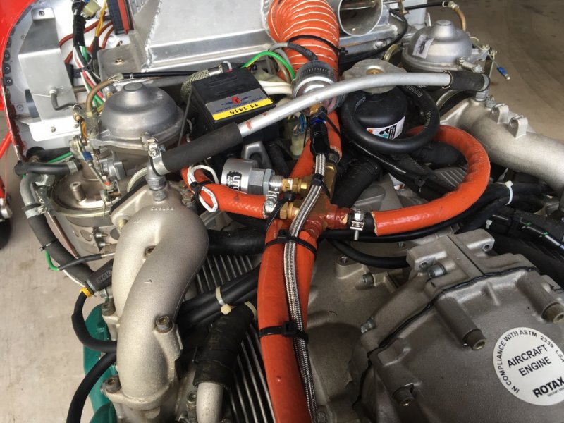

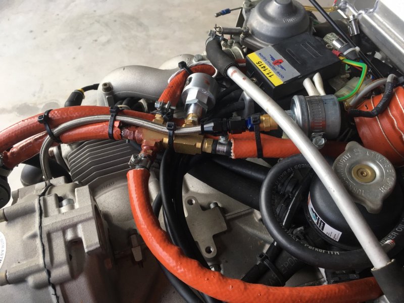

Kyle Communications Posted June 25, 2016 Author Posted June 25, 2016 Ok put the cowls back on this morning so took some pics. You van see the elbow now coming out of the block and the pipe up to the new sender. The earth for the sender is a clamp which is easy todo and the earth is ok if you spread the wire out like shown under the clamp. The fuel splitter I made up to replace the crappy one supplied. Its just from all available fittings I got from the local hose/fittings place. I used telflon tape but it seems to have broken down over time with the fuel so I have put stag in the front 2 where it was very very slowly weeping from so that should sealit. The other reason as well for the new splitter is for my fuel pressure sender for the MGL you can see connected. Just make sure the port going back to the tank you solder up the nipple and then drill a 0.3 or 0.4 mm hole through it for the feedback 2
IBob Posted June 25, 2016 Posted June 25, 2016 Hi Mark, you've certainly done a neat job of packing it in there. I was thinking about this pressure transducer issue; as I've written elsewhere, I have a fair bit to do with them in industrial settings. Carrying that thought forward, I was considering what the differences would be (between a refrig engineroom and an aero engine) and two occur to me. The first is ambient conditions: engineroom transducers are typically in a warm dry envoronment. The second is changes in atmospheric pressure: since these are 'gauge' and not absolute transducers, the outer side of the diaphram (and probably part of the circuitry) has to be exposed to the outside air pressure. That is, the unit cannot be hermetically sealed, and will 'breath out' when the aircraft climbs, and breath in again when the aircraft descends. This seems like a very minor issue, but in my experience enclosures that breathe can build up moisture. And I do know that exposure to significant moisture is a significant cause of failure in our industrial transducers. I'm not sure where that thought goes, beyond mounting the transducer in a place where it is sheltered from moisture and contamination.
Kyle Communications Posted June 25, 2016 Author Posted June 25, 2016 The consensis about the failures is the vibration from the engine. Danny Leach opened his broken one up and you can see where the resistor wire had worn through where the wiper was on it. I think he posted some pictures on the forum somewhere
