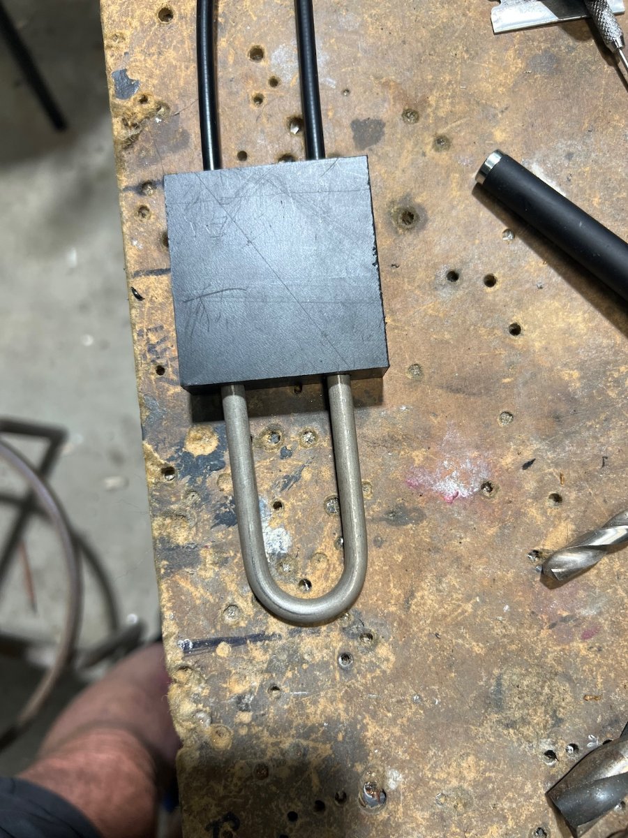

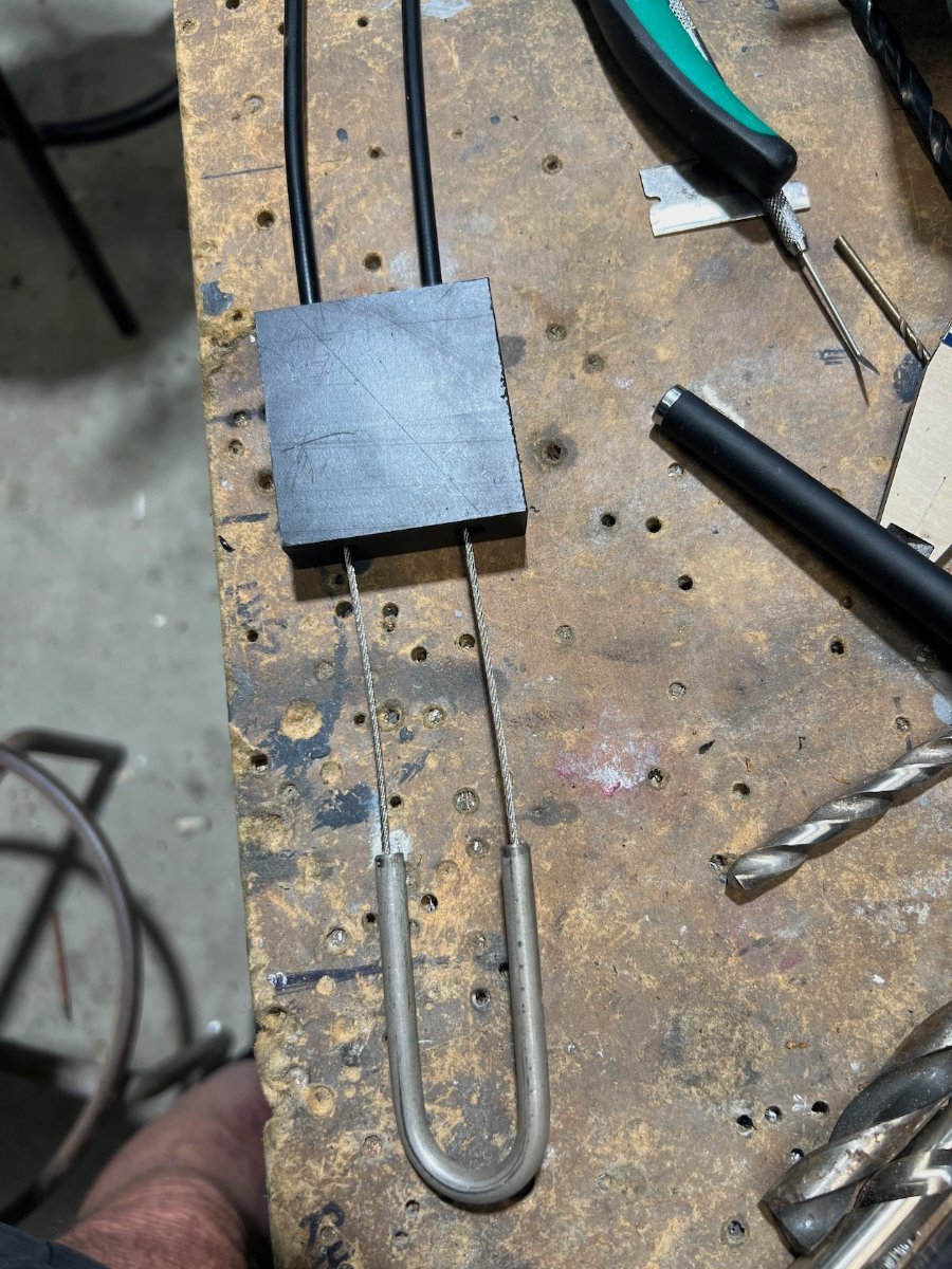

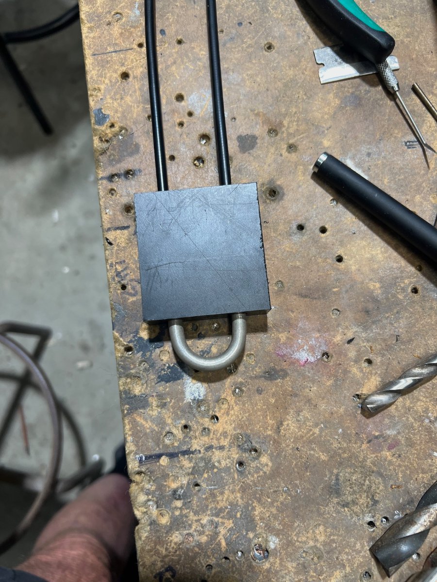

  22. All done and installed for the choke. Very happy how it operates
