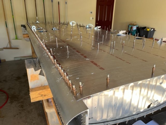

  6. Major step number 1...first wing is now down at the hangar. The Mistress left wing is now keeping Mabel's parts company

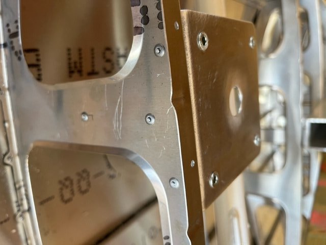

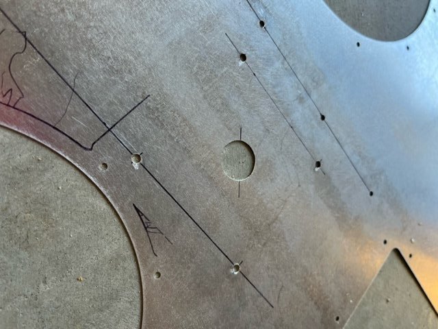

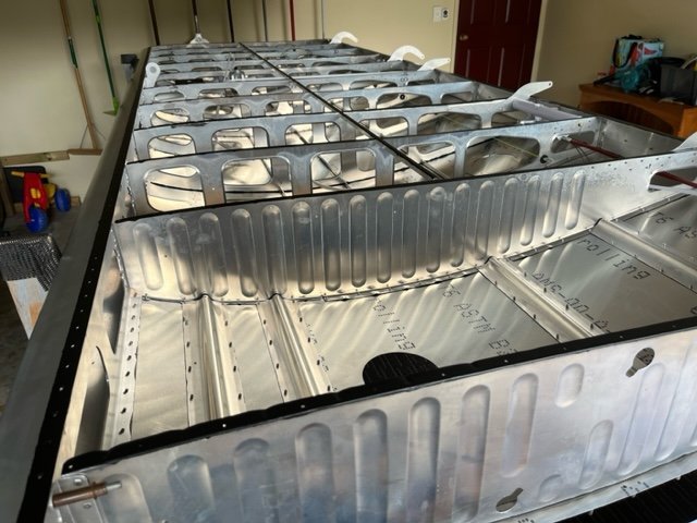

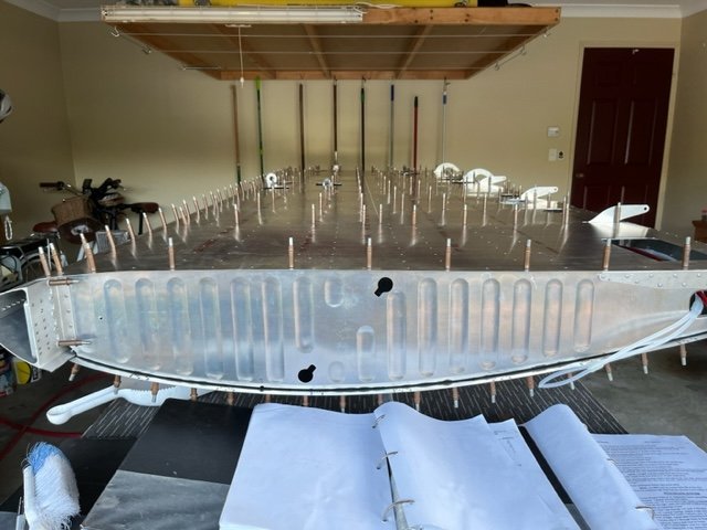

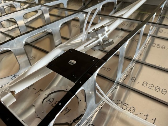

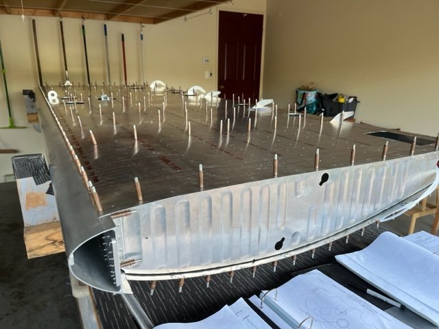

  8. 09/08/23 Installed fuel tank stand and filler flange. Installed fuel tank retention brackets. Modified sight tube fitting penetrations and installed LH wing root rib. LH wing fabrication complete. 5.2h
  9. 08/08/23 Fabricated fuel cap retainer ring. Marked and cut openings in fuel tank. Vacuumed and flushed fuel tank, checked for leaks under low head. Installed fuel sight gauge and tank flange fittings to tanks. 5.1h
  10. 07/08/23 Proseal bonded Viton fuel tank scupper plate to inside of upper RH wing skin. 1.3h

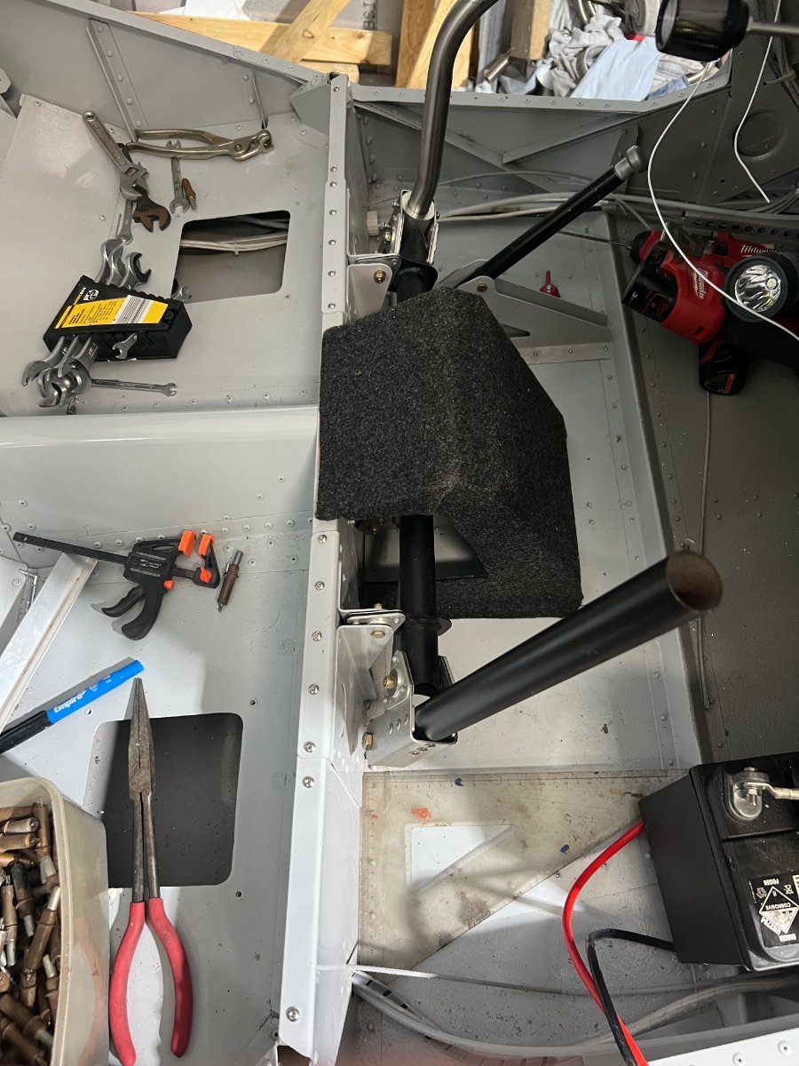

  12. Havent magaged to get a lot of work done on Mabel lately..its been too cold at night out in the shed and have been up at the farm for 4 days every 2 weeks trying to get the house finished. Finally today got to work on her. Grabbed the parachute box I made...so long ago it seems now and got it installed. Had to get the mrs to give me a hand lowering the chute into the ammo box and got it all mounted. Not sure how I am going to run the trigger for it yet or where I will mount it. I think I will cover the box with very light carpet because it will be easy to d that rather than waiting for paint to dry. Up the farm again next weekend but the following week I hope to get Mabel down to the hangar

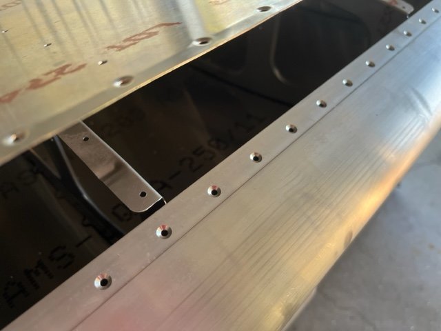

  15. 17/07/23 Riveted lower LH wing skin to ribs. Match driller rear spar, deburred, vacuumed swarf from wing cavity and riveted skin to rear spar. 6.8h

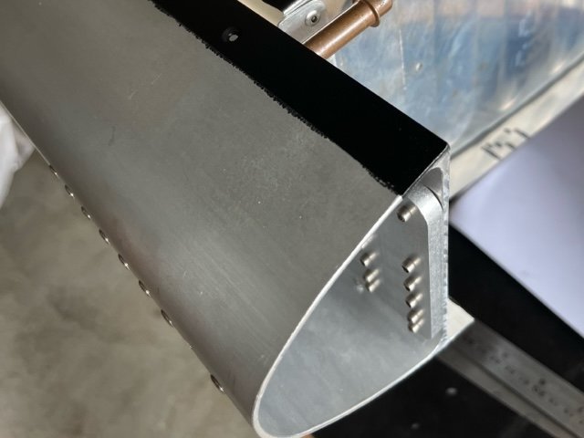

  16. Savannah builders will recognise the dreaded black goop. It is actually a fantastic product if applied correctly. Its not put on everywhere on this build as I havent put it on every mating surface. Only the surfaces that may have moisture ingress like the skins and rivets. I got a couple of tins from Aerokits just for this project
