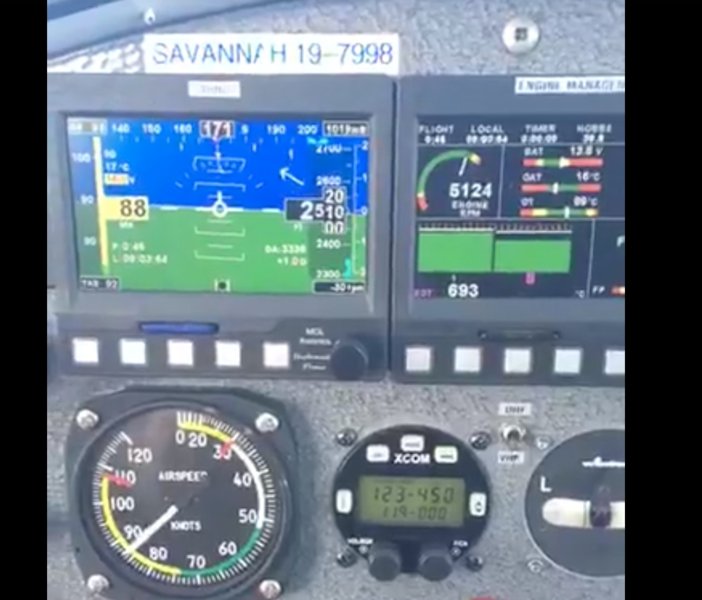

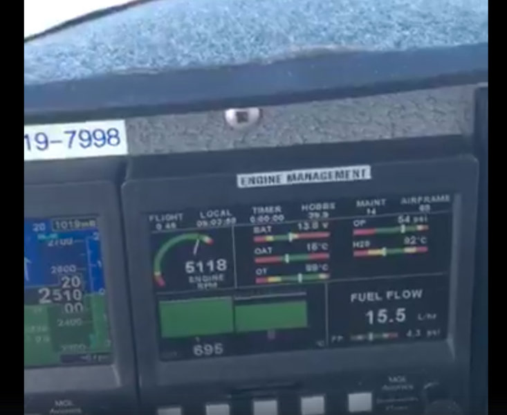

what your fuel usage in liters at cruise? 85 knots?
at 5000 its 14.5 litre at 5200 its 15.7 litres
Interesting figures.
At 5000 I get about 18-19lph I haven't actually done accurate tests.
At 4800 I get 15.6 lph. Averaged over 200 hours. As I don't have a fuel flow meter.
5000 gives me 85 knots
At 4800 I get 85 knots IAS and at 5000 I get 87 knots. Not worth the extra fuel burn to me.
Besides at 4800 and 85 knots she just feel right.
