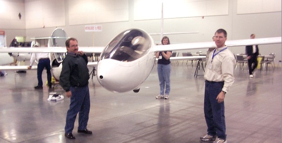

Have a look at the SparrowHawk Glider;
Empty weigh = 70kg!
Span = 10.9m,
L/D = 37:1 similar to an Astir (for half the weight).
[ATTACH=full]35850[/ATTACH]
Empty weigh = 70kg!
Span = 10.9m,
Where does the pilot go???
Empty weigh = 70kg!
Span = 10.9m,
They are pretty amazing aren't they!!!! But I suspect that the light wing loading(at 29kg/m2 about the same as a puchacz) is the reason for the ability to turn tight rather than the short wings.
