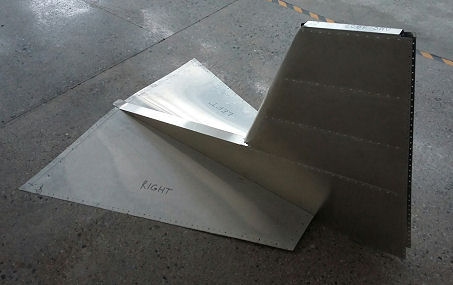

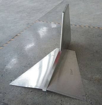

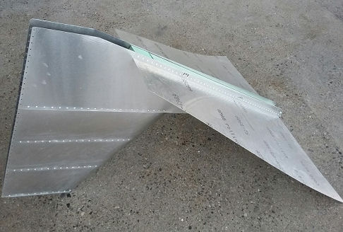

bexrbetter Posted November 23, 2016 Author Share Posted November 23, 2016 So today I assembled the vertical stab onto the rear rear turtle deck sheets, again as per post #541 above, and threw it on, it's so stupidly easy you even question yourself if it should be so easy. I need to make a few minor changes, one example is my 'spine' is too short, needs to run all the way to the tail post (the spine has that green foam in it for support to drill and rivet against). 5 Link to comment Share on other sites More sharing options...

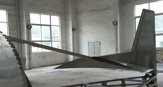

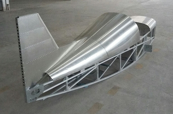

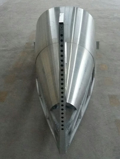

bexrbetter Posted November 25, 2016 Author Share Posted November 25, 2016 In the end I not only increased the length of the spine, I ended up running it the complete length of the 2 turtledecks, from the top of the roll bar (and a real roll bar too for your safety), to the bottom of the tail post. Dang it made it easy to hang the dorsal fin, rudder and rear turtledeck from, as well as adding strength to the complete structure for a weight penalty of under 1kg/2lbs. It also makes it easy to align the front and rear turtledecks as can be seen here, very smooth junction between them with just a couple of rivets at this time, happy about that. 4 3 Link to comment Share on other sites More sharing options...

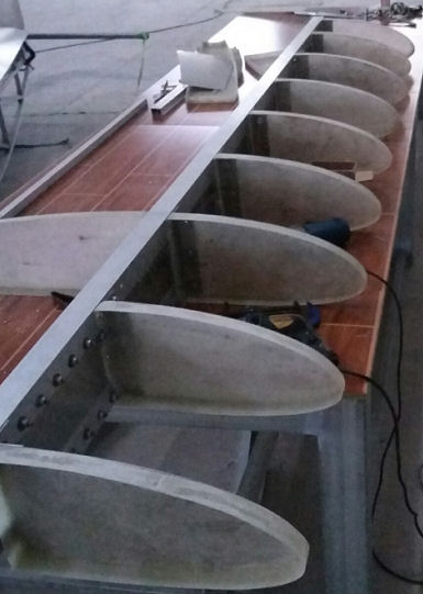

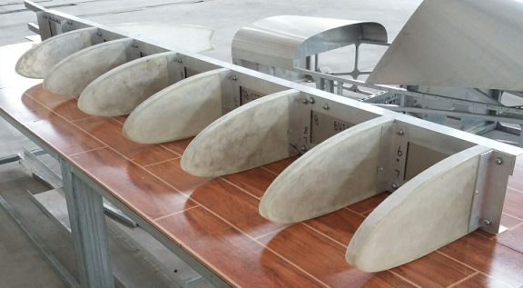

bexrbetter Posted December 2, 2016 Author Share Posted December 2, 2016 Getting the wings assembled now after finally getting some ribs together ... 8 1 Link to comment Share on other sites More sharing options...

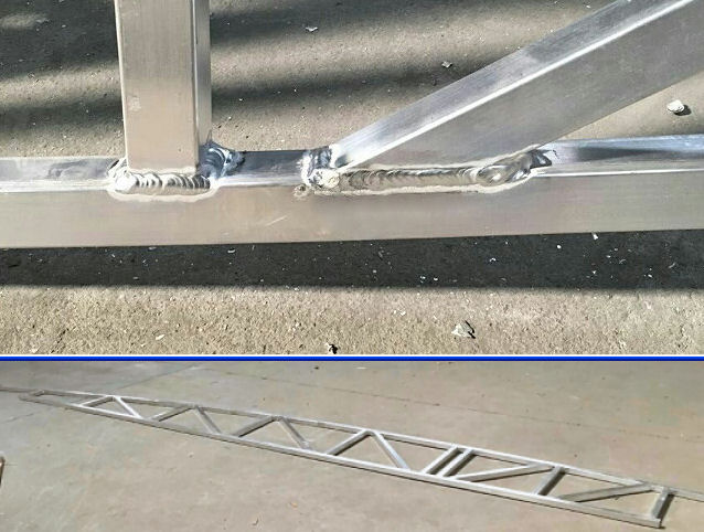

bexrbetter Posted December 8, 2016 Author Share Posted December 8, 2016 Found an interesting specialized aluminium truss company locally so am trying some little experiments. Have been working with them for a couple of days and have ordered some parts to see if they will pan out or not, so stay tuned for when they arrive in about a week. 1 Link to comment Share on other sites More sharing options...

bexrbetter Posted December 12, 2016 Author Share Posted December 12, 2016 Found an interesting specialized aluminium truss company locally so am trying some little experiments. Have been working with them for a couple of days and have ordered some parts to see if they will pan out or not, so stay tuned for when they arrive in about a week. One of my little experiments is finished and should be in transport tomorrow, I'll talk more about it when I see the results for myself .... adswttn. 2 Link to comment Share on other sites More sharing options...
