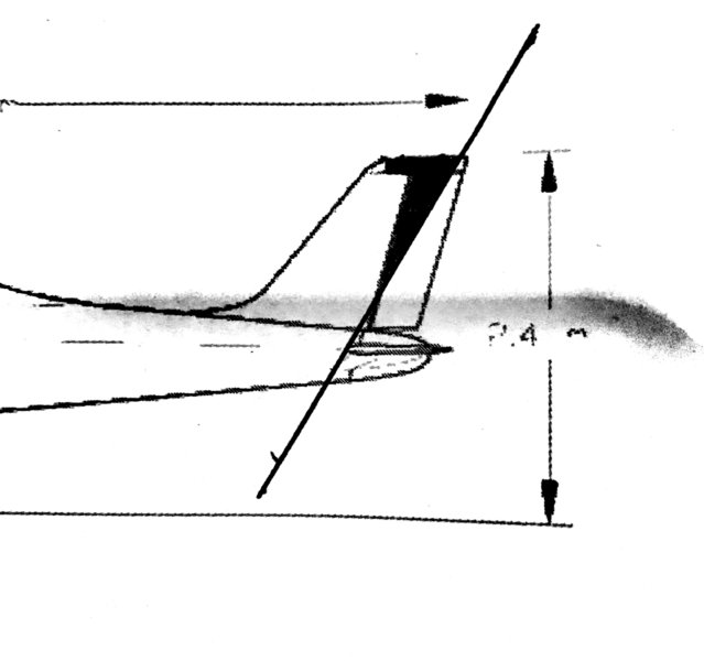

APenNameAndThatA Posted October 28, 2018 Share Posted October 28, 2018 ABC is reporting a plane crash in Victoria.Plane crashes at Black Range in Victoria's west Tecnam vs Bristel. With these aircraft, the tail seems forward of the horisontal stabiliser, having a swept horisontal stabiliser would also contribute to blocking airflow to the movable tail. Also, I suspect that the more ambitious someone was about the performance of their aircraft, the closer the stall speed of the horisonatal stabiliser would be to the stall speed fo the main wing. 60 degrees *might* be a bit arbitrary for the angle, but the difference in the amount of the exposed control surface is massive. Just, wow. Link to comment Share on other sites More sharing options...
APenNameAndThatA Posted October 28, 2018 Share Posted October 28, 2018 This is taken from Darrol Stinton's book "The Design of the Aeroplane" which might be of relevance or interest. Furthermore Stinton notes that spin damping is better when there is a deep rear fuselage and when there is rudder area beneath the tailplane and elevator. None of these are designed into many modern aircraft including the above as so many LSA type aircraft become very thin towards the real fuselage including this aircraft. Interestingly Stinton (perhaps controversially) writes in relation to the above quote "much of this design wisdom is being lost".[ATTACH=full]62068[/ATTACH] Too, the Tecnam has more fuselage below the horisontal stabilizer. Link to comment Share on other sites More sharing options...
facthunter Posted October 28, 2018 Share Posted October 28, 2018 These aspects are good general rule of thumb considerations and general GOOD ADVICE.. The shielding of the rudder IS a problem. Why the rudders slope is perhaps a silly styling exercise that should put you off buying it if you had the option. Plenty of FAR 23 info about that's in the same vein. Why not learn by other's misfortunes? You don't live long enough to work it all out again for yourself. There's a few crap designs out there and more appearing all the time. OK as a desk top model? Not even that. Nev 1 Link to comment Share on other sites More sharing options...

facthunter Posted October 29, 2018 Share Posted October 29, 2018 I wouldn't say Mooney have it particularly right though I'm not saying it has an evidenced problem. A 60 degree line from the leading edge still eliminates a lot of the rudder area. Some rudder under the horizontal stab helps too when it's there.. The strake in front of the fin helps to make the rudder more effective as well as a rounded fuselage section.. Nev Link to comment Share on other sites More sharing options...
APenNameAndThatA Posted October 31, 2018 Share Posted October 31, 2018 If someone wants to have a steeply raked tail, all they have to do is do it the old-fashioned way and put the tail behind the horizontal stabilizer. Link to comment Share on other sites More sharing options...
djpacro Posted October 31, 2018 Share Posted October 31, 2018 Still need enough out of the "blanketed" area - easy enough to do a reasonable assessment at the initial design phase but costly to fix at prototype stage. Even just to demonstrate compliance with the LSA requirements for recovery from a one turn spin is a significant and costly effort. 1 1 Link to comment Share on other sites More sharing options...
