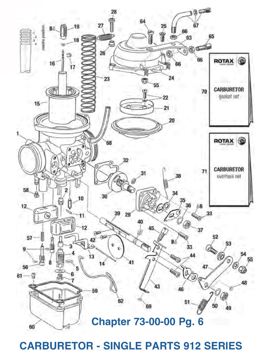

Garfly Posted January 18, 2021 Share Posted January 18, 2021 (edited) ... and, since too many 912 videos are never enough, this one shows how carb vent tubes can, in the wrong place, cause rough running. Edited January 18, 2021 by Garfly 1 Link to comment Share on other sites More sharing options...
IBob Posted January 18, 2021 Share Posted January 18, 2021 I may have this wrong, but: I'm pretty sure his problems started with his assumption those are drain tubes (and he's still thinking that and calling them drain tubes). My understanding is they are nothing of the sort: They should be connected to wherever the carb is drawing it's air from, their function being to ensure that the float chamber is at the same pressure as the incoming air. (So, for instance, if you have an airbox with a filter, they are connected to the airbox but after the filter.) Put them anywhere else and you'll get exactly the sort of behaviour he's talking about, as the float chamber is then running at a pressure higher or lower than the carb air, resulting in rich or lean mixture. Feel free to straighten me out if I haven't got this right. 2 1 Link to comment Share on other sites More sharing options...
jackc Posted January 18, 2021 Share Posted January 18, 2021 I will have to check my drain? Tubes. Don’t have an air box, only a pancake filter on each carby. Link to comment Share on other sites More sharing options...
Garfly Posted January 18, 2021 Share Posted January 18, 2021 He calls them 'drain tubes' when he speaks but 'vent tubes' on the title of his video. Link to comment Share on other sites More sharing options...
jackc Posted January 18, 2021 Share Posted January 18, 2021 Exploded view of carby..... Link to comment Share on other sites More sharing options...
skippydiesel Posted January 18, 2021 Share Posted January 18, 2021 Garfly - not only does he mis name the vent tubes I suspect the exhaust/muffler system he is running (doesn't look like ball & sockets system) is prone to all sorts of stress cracking. 1 Link to comment Share on other sites More sharing options...
IBob Posted January 18, 2021 Share Posted January 18, 2021 FWIW, I believe it is the pressure on those vent lines that is lowered when a fuel leaning system is added to this engine...and that is done by introducing a small amount of vacuum taken from the balance pipe after the carbs (but before the engine). 1 Link to comment Share on other sites More sharing options...
