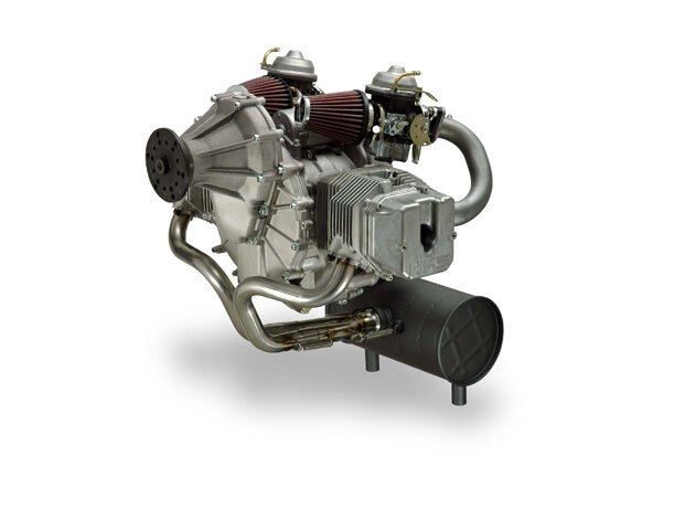

That is interesting, I flew a Thruster once that was fitted with a BMW twin opposed driving thru a rotax C box, vibration was low like a 582. The gearbox would help giving more power pulses per prop revolution ?
The HKS twin was tried on the Thruster in the 90's, don't think it was successful. The HKS is still in production and looks good on paper, anyone have any experience?
[ATTACH]41342[/ATTACH]
" As of June 30, 2019 the HKS 700E is no longer available as a new engine. A limited supply of spare parts is available, and we will continue to provide these on our store as long as supply lasts."
