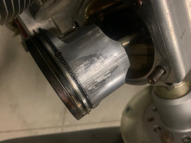

kiwiaviator Posted April 23, 2021 Share Posted April 23, 2021 Photos I was sent last year. Gen 4 pistons in a Gen 3 engine after approx 3 hours running. Engine now has non-Jab forged pistons with no issues. 1 Link to comment Share on other sites More sharing options...
RFguy Posted April 23, 2021 Share Posted April 23, 2021 OUCH Yeah they have a Gen3 retrofit specific solid skirt piston now. 195+gst each. Produced since December 2020 . 1 Link to comment Share on other sites More sharing options...
facthunter Posted April 23, 2021 Share Posted April 23, 2021 Insufficient clearance by the look of it. Some forged pistons need extra clearance just because of the alloy used. Nikasil bores don't wear much. The hone pattern on the cyls shown doesn't look the best. Jabiru get a good finish but the hone pattern could be a bit coarser to hold more oil. Honing steel is not easy. Nev Link to comment Share on other sites More sharing options...

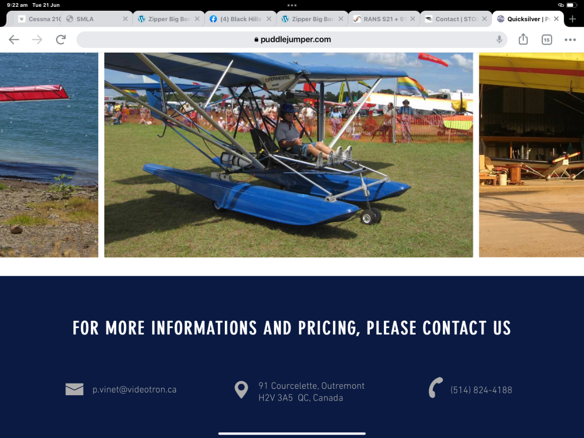

Mike Gearon Posted June 21, 2022 Share Posted June 21, 2022 Somebody mentioned puddle jumper floats on here. I didn’t want to start a new thread… I’ve just talked with Patrick Vinet. puddle jumper guy. 15ft floats (1250lb) rudder, salt water kit and maybe brakes (waiting for reply on salt water reliability. I’m busy right now because I’ll ship a 20ft with the Pipistrel, quicksilver and some rans bits. I think the QS in the hangar could be a favourite summer weapon to pull out. Nice part of floats I didn’t realise until flying seaplanes is your runway is everywhere for emergency landings. 6 weeks to order and approx 10-11k USD 1 Link to comment Share on other sites More sharing options...
