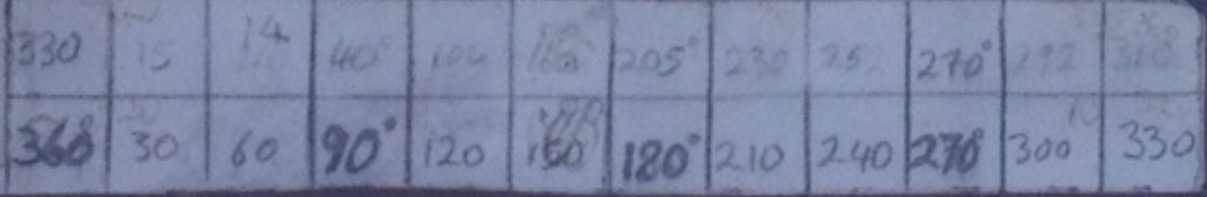

Also, there's a thing called a Compass Deviation Card that you can fill in and paste beside your compass. If you copy this image, you can paste it in Word and make up a whole heap of them.
Yep, I've had one of those for a decade, but until recently the deviation numbers have been large enough to put me off using it:

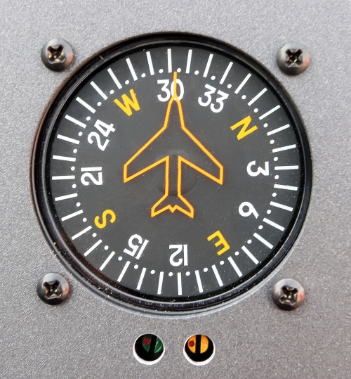

The best compass I've ever used is the 'vertical card' type, (pic), which is intuitive, steady, and large enough to read without too much error. Better than a DI because you don't suffer from precession error.
[ATTACH type=full" alt="1597533040990.png]55476[/ATTACH]
Always used to leave that one off if a DCA/DOT/CASA inspection was due. They used to fuss around and make a big thing of it saying it was essential for aircraft operation. One chap gave me a big lecture about how I should take more care. The aircraft was facing 230 the compass was indicating 330, he noticed the compass deviation card wasn't here but didn't look at the compass ? I admit I neglected to point it out to him. He snagged me and sent out a list of things he said needed attention. One of which he claimed was a cracked exhaust, I knew it wasn't. After taking it off inspecting and using dye penetrant there were no cracks, another $300 spent.
