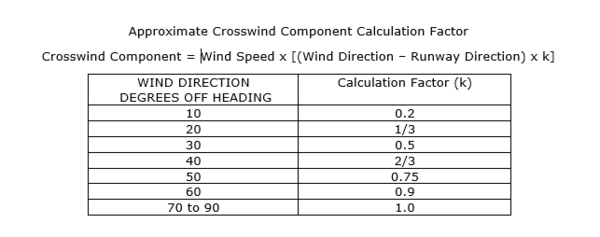

Bennyboy320 Posted September 24, 2020 Share Posted September 24, 2020 40 minutes ago, andy310r said: FWIW the rule-of-thumb I use for mentally calculating x-wind components is the clock model... Wind 15 degrees off runway heading = quarter crosswind component (picture a minute-hand at 15 mins: quarter of an hour) (e.g. 12 knots, 15 degrees off = 3 knot component) 30 degrees off = half (e.g. 12 knots, 30 degrees off = 6 knot component) 45 degrees off = three quarters (e.g. 12 knots, 45 degrees off = 9 knot component) Same rule we were taught in the RAAF on pilots course & I still use it to this day when flying the Foxbat 🦊 or the Bus. KISS. Link to comment Share on other sites More sharing options...
old man emu Posted September 24, 2020 Share Posted September 24, 2020 7 hours ago, andy310r said: FWIW the rule-of-thumb I use for mentally calculating x-wind components is the clock model... Wind 15 degrees off runway heading = quarter crosswind component (picture a minute-hand at 15 mins: quarter of an hour) (e.g. 12 knots, 15 degrees off = 3 knot component) 30 degrees off = half (e.g. 12 knots, 30 degrees off = 6 knot component) 45 degrees off = three quarters (e.g. 12 knots, 45 degrees off = 9 knot component) 60 degrees off = all of it (12 knots across). Which is pretty much what I said earlier. I would not argue with that means of remembering things. The values in this table come from looking up the value of sine for the angles, and are more mathematically accurate, but the Rule of Thumb is acceptable. People have been having difficulty in understanding what I mean by "eroding the headwind component" Basically, if a wind of # kts is blowing straight down the runway, the headwind component is 100% of # kts. As the angle of the wind to the centreline of the runway increases, the headwind component reduces by a factor related to the cosine of the angle. I suggest an exercise with plotter, ruler, pencil and paper. Has anyone even tried to do that exercise. If you do, you will find that " eroding the headwind component" becomes crystal clear. 1 Link to comment Share on other sites More sharing options...

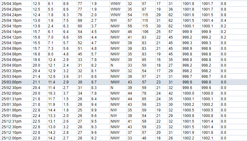

old man emu Posted September 25, 2020 Share Posted September 25, 2020 It got a tad breezy at Camden yesterday afternoon about 1600. I wonder what the crosswind was on Runway 06 about 1615. NNW covers the bearings 320 to 330 degrees. The headwind component of that crosswind would have made stalling-on in most aircraft rather difficult. Link to comment Share on other sites More sharing options...
