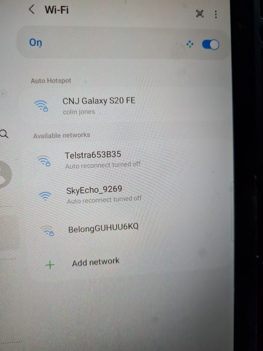

1. try Speedify. It combines data from Wi-Fi and data from mobile into 1 stream. it is free and gives you 2GB / month of streaming data.  In use, except updates, RWY doesnt use much data and Speedify can be disabled when you aren't using SkyEcho.
or 2. A bit trickier
2.1 manually connect (not auto connect) to the SkyEcho-xxx via 192.164.1.4 and setup the skyecho ICAO, callsign, transmit etc.
2.2 disconnect from the sky echo but leave Wi-Fi on (Wi-Fi not connected to anything) If you are doing this at home you might have to prevent the tablet from autoconnection to the home Wi-Fi.
at this point the tablet will not try to talk via Wi-Fi but will route data via the mobile network.  As the SkEcho picks up ADSB-in data it will send messages out via port4000 on Wi-Fi which will be picked up by the tablet (and RWY if it is setup to listen for GDL-90 (UDP port4000)).
I am lucky, I live under the Mascot northerly flightpath (there goes another on) so it is easy for me to test it. (Now ANZ106 @15,00 feet)
Part of my prep at home is to configure the SkyEcho and have it set up for the next flight (QFA737 just went past at 3000').  I have had a bit of finger trouble such as leaving the ICAO address set to the previous plane, this confuses ADSB consolidation sites as it thinks that there are 2 planes in the one spot.  If your transponder has ADSB out the skyecho out should be turned off. (BAW16 just went past at 1900' - might be something wrong with its baro)
