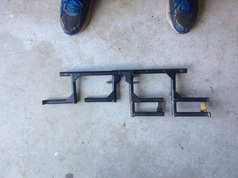

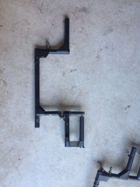

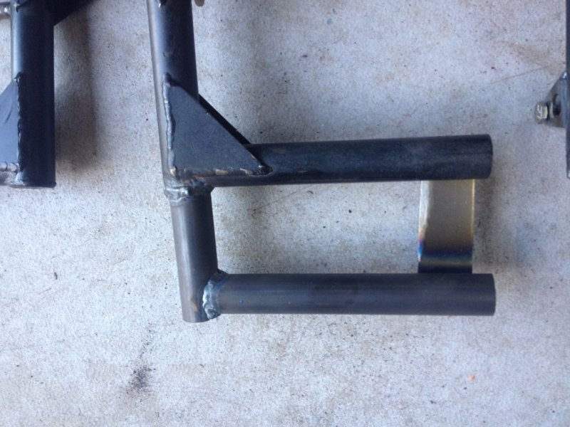

eightyknots Posted October 14, 2013 Share Posted October 14, 2013 I am going to modify the pilots rudder pedals as well to be longer and reposition the toe brakes I will add this to my other blog when I do them I'll look at that with great interest! Link to comment Share on other sites More sharing options...

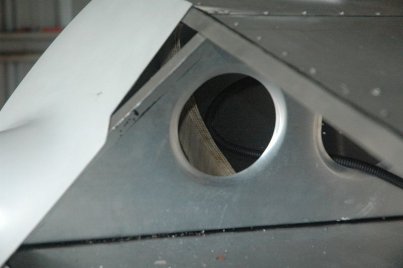

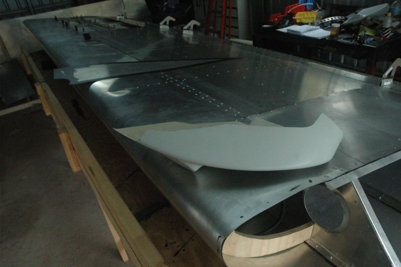

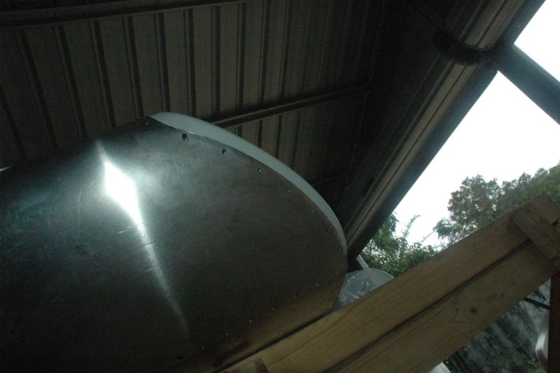

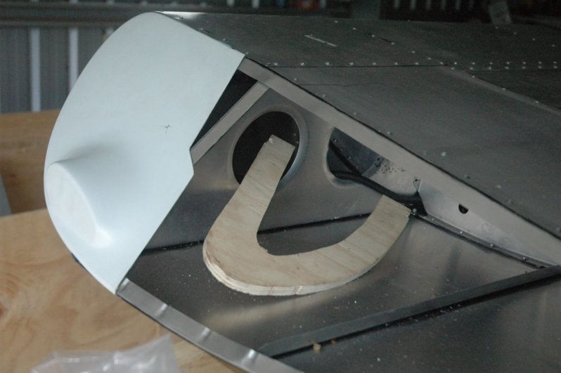

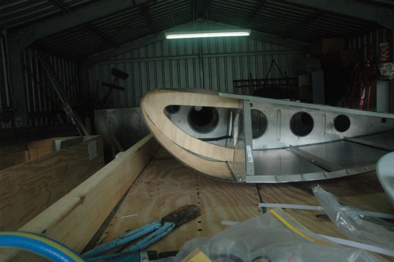

Kyle Communications Posted November 9, 2013 Share Posted November 9, 2013 Hi Steve Went looking for my jig it doesnt seem to be here may have taken it up to the hangar to get ready. My parts have left Italy so should be here later this week. These are the pics of when I was building the girlfriend. All I did was get a rib nose section and copy it onto some 10mm plywood and cut out the shape but you need to cut out the inner to be able to get it through the spar hole when you want to remove it Link to comment Share on other sites More sharing options...
Kyle Communications Posted November 9, 2013 Share Posted November 9, 2013 Oh the plywood needs to be exactly the same size as a nose rib to sit nicely firm up against the main spar to push the D section into shape at the tip Link to comment Share on other sites More sharing options...
rankamateur Posted November 9, 2013 Share Posted November 9, 2013 Does it push on the fibreglass tip or the nose skin? Link to comment Share on other sites More sharing options...
Kyle Communications Posted November 9, 2013 Share Posted November 9, 2013 no it is to form the alu as it has no support and wants to go into a oval shape so you can't get a nice fit of the fibreglass tip...the jib just forces the alu to the shape it should be...basically just a false rib but you position it as close to the fibreglass tip as you can it makes fitting the tip a piece of p*ss Link to comment Share on other sites More sharing options...

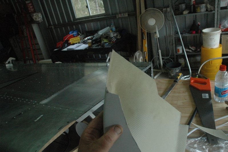

Kyle Communications Posted November 9, 2013 Share Posted November 9, 2013 what do you mean turned the edge down on the nose sheet? I had the nose sheet all pulled around and clecoed the tip was almost one of the last things I did Link to comment Share on other sites More sharing options...
Kyle Communications Posted November 9, 2013 Share Posted November 9, 2013 oh I know what you mean now..the trick with the cutting board and the slot to bring the end edge down a little to fit the glass tip nicely...like this...I did turn the alu down first then fitted the tip Link to comment Share on other sites More sharing options...

rankamateur Posted November 11, 2013 Share Posted November 11, 2013 Oh the plywood needs to be exactly the same size as a nose rib to sit nicely firm up against the main spar to push the D section into shape at the tip Made one today, worked a treat, It does need to be sanded nice and smooth or it tends to drag creases in the sheet, ver 2.0 was excellent. Link to comment Share on other sites More sharing options...
Guest Maj Millard Posted November 11, 2013 Share Posted November 11, 2013 Nice work boys...............I like to run a nice bead of sealant around where the edge meets the alum, and smooth it out for a water tight seal................... Link to comment Share on other sites More sharing options...
