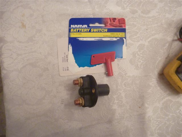

Blueadventures Posted October 17, 2015 Posted October 17, 2015 Quote Hi 80ktsI'm planning to fit a battery isolator to the starter circuit with it in the panel. Also the other master switch is on the left side of the panel. Should keep the battery cable short as battery is below the panel on the Nynja's. Cheers Mike For information I fitted the above battery isolation switch 'Nava' brand and it is s*1t. Key in 'off' position open circuit; key turned to 'on' position still open. While turning from 'off' to 'on' and back again it closes circuit. Pulled it out today and taking back Monday. Should I change brand to Hella or another dearer better quality product? I read on google about some similar failures with 'Nava' items. Not happy; lucky not to have fail when needing to do a quick restart, say during final. Regards Mike 1

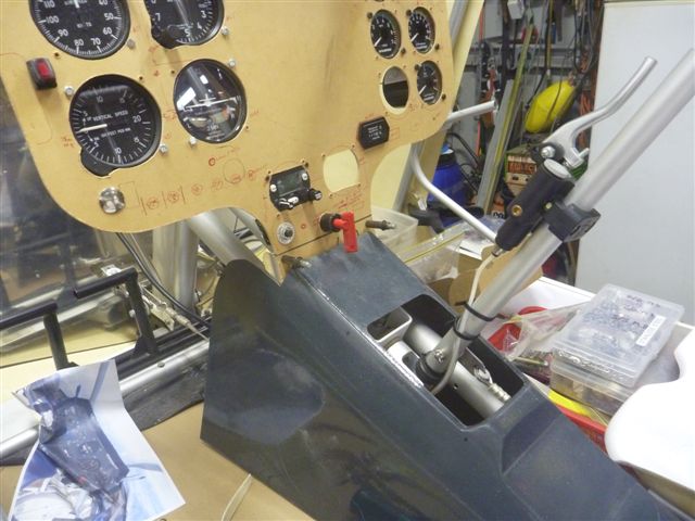

Kyle Communications Posted October 17, 2015 Posted October 17, 2015 I got mine from Jaycar I think...has been working flawlessly for more than 3 years now
Kyle Communications Posted October 17, 2015 Posted October 17, 2015 This is when I first built the Sav...it has been re sited after I fitted the twin sticks but it is still the same one
jakej Posted October 17, 2015 Posted October 17, 2015 Ah, that is better - I was thinking of a different panel switch operated one same as used in GA & most aircraft
SDQDI Posted October 17, 2015 Posted October 17, 2015 I use the same style as The one that Kyle uses. I always take the key right out when I want it off, which takes any guesswork out of it as to whether it is still on or not:thumb up:. Incidentally the only time it gave me trouble was when I left it on and it flattened my battery, but I guess that was more operator error:whistling:
Blueadventures Posted October 17, 2015 Posted October 17, 2015 Quote For information I fitted the above battery isolation switch 'Nava' brand and it is s*1t. Key in 'off' position open circuit; key turned to 'on' position still open. While turning from 'off' to 'on' and back again it closes circuit. Pulled it out today and taking back Monday. Should I change brand to Hella or another dearer better quality product? I read on google about some similar failures with 'Nava' items. Not happy; lucky not to have fail when needing to do a quick restart, say during final.Regards Mike This is the one I have removed. Its a 'Narva' ; pardon my incorrect spelling. Regards Mike
Old Koreelah Posted October 17, 2015 Posted October 17, 2015 Quote This is the one I have removed. Its a 'Narva' ; pardon my incorrect spelling.Regards Mike Looks like the one I fitted to my Guzzi after the battery had mysteriously gone flat a couple of times. I installed a long connecting rod to turn the red key and found that even in the "off" position it carried a current because there was slight pressure holding the key in. As SD says, you need to remove the key to be sure.

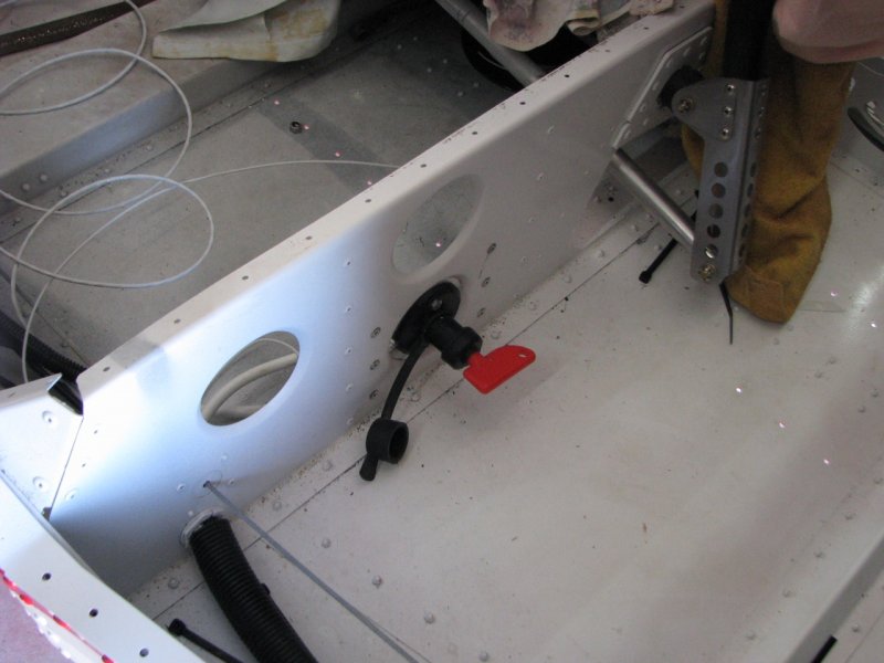

eightyknots Posted October 20, 2015 Posted October 20, 2015 Quote This is when I first built the Sav...it has been re sited after I fitted the twin sticks but it is[ATTACH=full]38725[/ATTACH] [ATTACH=full]38726[/ATTACH] still the same one They use these kinds of isolation switches in boats a fair bit as well.

Blueadventures Posted October 30, 2015 Posted October 30, 2015 Quote This is the one I have removed. Its a 'Narva' ; pardon my incorrect spelling.Regards Mike Returned that one (refunded) and got one same as Kyle Comms has (Thanks Mark for the info and also Jake J for his indepth info); all good now. Cheers Mike
Kyle Communications Posted October 30, 2015 Posted October 30, 2015 Glad to be of help....keep getting those fly off hours in
