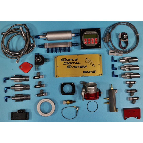

Downunder Posted November 16, 2014 Share Posted November 16, 2014 http://webshop.edgeperformance.no/index.php?id_product=74&controller=product 1 Link to comment Share on other sites More sharing options...
jetjr Posted November 17, 2014 Share Posted November 17, 2014 CAE = Camit Aero Engines Link to comment Share on other sites More sharing options...
jetjr Posted November 17, 2014 Share Posted November 17, 2014 The kit pictured is the whole deal, inc requiring dual pumps, new TBody and probably backup battery setup It can be done using Bong carb and single fuel pump Cheaper and inc full mechanical backup Link to comment Share on other sites More sharing options...
