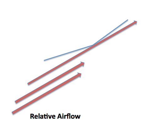

Crood picture I just made for you. But you can try and imagine the relative airflow in a descending turn. In this instance coming from below and left in a left turn. The right wing shows clearly, a lower angle of attack.
Sorry its a dodgy pic, but hopefully it makes sense.
Wayne bear with me, I still don't see how there would be a higher AOA for the Lower wing

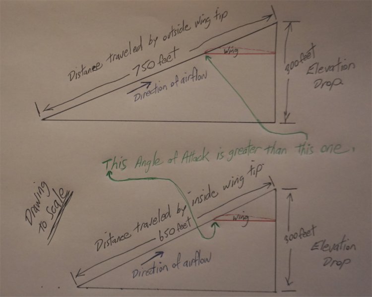

This is the way I see it, I hope it helps. I have drawn a diagram, the traveled distance are only examples not actual worked out figures. Also, I have drawn the wing (chord) parallel (in relation to a horizon) but the of course a descending aircraft wing would be lower on the leading edge, this does not change the anything with regard to the AoA differences though.
Another way to visualize it is to think of a spiral stair case. Let's put a nail in the same place on each end the steps ( dead centre say) then run a string from nail to nail on the inside of the spiral steps and on the outside. Look at the angle between the step and the string line, comparing the outside angle with the inside angle......it's not hard to picture the difference.
Now... the AoA difference may be very small for the aircraft in that descending turn but even one half of one degree is going to make a difference.....and that's with neutral ailerons.
