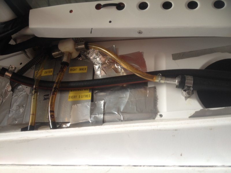

Kyle Communications Posted February 1, 2016 Share Posted February 1, 2016 I have since changed the rislan tubes they discolour and you cant see through them. I now have clear polyurethane tube in the sight guages and no further issues. I have 4 sight guages so I can see exactly how much fuel I have in all 4 tanks and I totally control what fuel is in what tank.....I am a control freak when it comes to fuel in the aircraft Link to comment Share on other sites More sharing options...

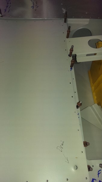

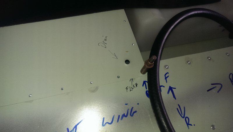

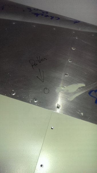

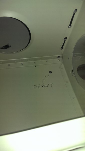

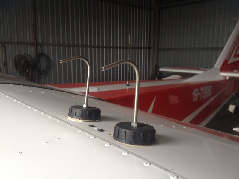

Lyndon Posted February 3, 2016 Author Share Posted February 3, 2016 Breathers of the four tanks. Manual says I holes top and bottom skins. I can see the top but the bottom hole is a drain ??? Inner rear location. Correct. So the existing hole in the top is redundant with the auxiliary tanks. Any tips ??? Or just drill a hole in the top and bottom to suit. Any pics would great. Lyndon Link to comment Share on other sites More sharing options...

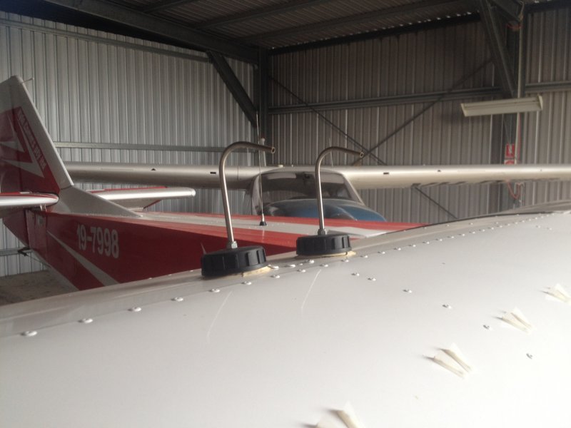

Kyle Communications Posted February 3, 2016 Share Posted February 3, 2016 I had mine like that but went away from it after a bug blocked a tank from draining. I posted here about it...I would put the breathers in the caps like I did and probably more than half of the Sav owners have done now Link to comment Share on other sites More sharing options...

Ultralights Posted February 3, 2016 Share Posted February 3, 2016 Breathers of the four tanks. Manual says I holes top and bottom skins. I can see the top but the bottom hole is a drain ??? Inner rear location. Correct. So the existing hole in the top is redundant with the auxiliary tanks. Any tips ??? Or just drill a hole in the top and bottom to suit. Any pics would great. Lyndon i think those drain holes are to allow water to drain out if any leaks through the skins, or the cutout for the fuel cap when in rain, also, as a drain if you have a fuel leak to stop it draining into the cabin. Link to comment Share on other sites More sharing options...
Ron Hoey Posted February 8, 2016 Share Posted February 8, 2016 Breathers of the four tanks. Manual says I holes top and bottom skins. I can see the top but the bottom hole is a drain ??? Inner rear location. Correct. So the existing hole in the top is redundant with the auxiliary tanks. Any tips ??? Or just drill a hole in the top and bottom to suit. Any pics would great. Lyndon Hi Lyndon, I completed my VG XL in 2010, and during construction I read a few blogs warning against putting the through-wing breathers between tanks, as a tank movement can block the breather and stop fuel flow from that tank. Consequently I put breathers in the fuel caps (copied from a Gazelle) and they work perfectly. This was also suggested by another follower, I see. I am in Adelaide and would be glad to be of any assistance. PM me and set up comms. Ron Link to comment Share on other sites More sharing options...

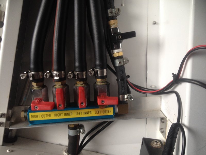

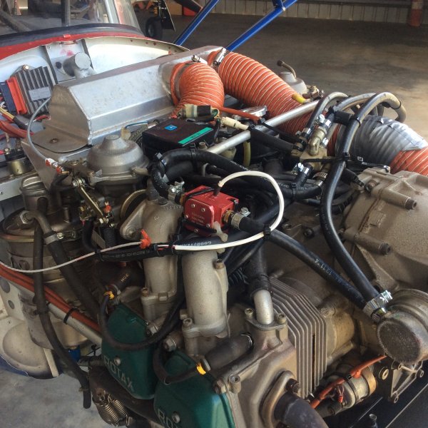

Kyle Communications Posted February 9, 2016 Share Posted February 9, 2016 Attached are the pics as promised. Shows my overflow from the engine going into the RHS of the manifold and the fuel tap which allows me to tun it off if I want to and also where the overflow/air return for the fuel reserve goes to the top of the inner tank. The new SS tubes for te breathers and the flashing LED setup in the original fuel reserve light 1 Link to comment Share on other sites More sharing options...

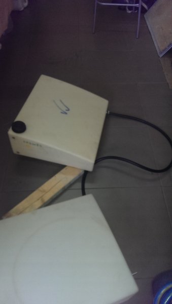

Lyndon Posted February 14, 2016 Author Share Posted February 14, 2016 Thanks for pics. Looks very nice. Opinions on matting for the tanks. Book recommended top and bottom. I have got some rubber. I guess enough just to stop rubbing. When I washed the tanks out I just could not believe how heavy two tanks in each wing will be. Thanks Lyndon Link to comment Share on other sites More sharing options...
Lyndon Posted February 14, 2016 Author Share Posted February 14, 2016 These are not the drain holes for vents are they. I need to drill them Lyndon Link to comment Share on other sites More sharing options...

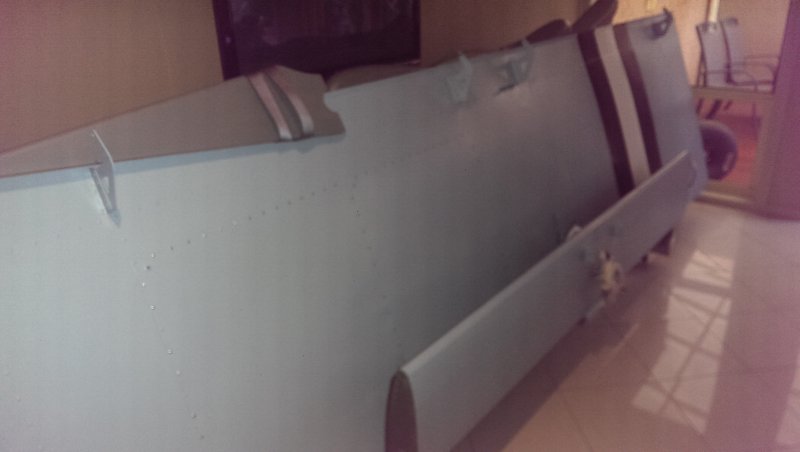

Lyndon Posted July 10, 2016 Author Share Posted July 10, 2016 Progress Link to comment Share on other sites More sharing options...
IBob Posted July 10, 2016 Share Posted July 10, 2016 Progress Looking good, Lyndon. And some coincidence: I was revisiting some of the conversation on prep and painting, and wondering how you were going. I'm the tail surfaces and one wing into my S build; finally got the tanks sorted. I think, I hope! Link to comment Share on other sites More sharing options...
Lyndon Posted July 10, 2016 Author Share Posted July 10, 2016 More paint Link to comment Share on other sites More sharing options...
