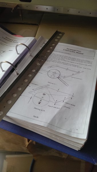

Lyndon Posted October 28, 2015 Author Posted October 28, 2015 Front lower hatch fixing support question. What am I missing. How does this work. Is it bent over to catch the lip. A rod installed to make a hinge. Nothing in my manual except rivet it the hatch ??? Lyndon
bobcharl Posted October 29, 2015 Posted October 29, 2015 No bending, no rod, just rivet it on as per the diagram on the page in your photo. The cover will then go on the outside of the fuselage with the riveted strip inside the fuse. Cleco it first and try it and you will work it out. Regards, Bob

rankamateur Posted October 29, 2015 Posted October 29, 2015 Quote What am I missing. .... Nothing in my manual except rivet it the hatch ???Lyndon You seem to be having more than average trouble understanding the manual. The manual has copped a lot of criticism but it is better than that. I will give you two bits of advice. Read the manual for the next section you expect to be building the night before you start, you will digest it before you need it that way. The other thing is that they tend to have the explanation on one page BUT the picture or diagram on the facing page usually is the diagram for the page before. So when you are looking for clarification from a diagram, turn the page and you will likely find what you need. 1
