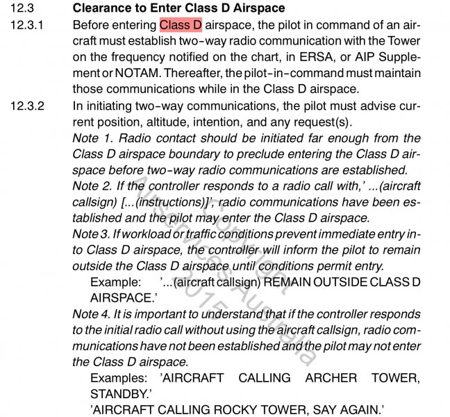

NF, where are you quoting this shortened procedure from? AIP 12.3 still includes instructions as part of establishing comm's.
AIP ENR 12.3.2 Note 2 says if the controller responds with your call sign (and perhaps instructions) you have established two way comm's and therefore may enter the class D airspace.
It seems the old GAAP airport towers have modified the Class D procedures to match GAAP by simply acknowledging your "inbound" call and consider that a clearance. However the original Class D controllers continue to provide a traditional clearance before taxy or when inbound.
