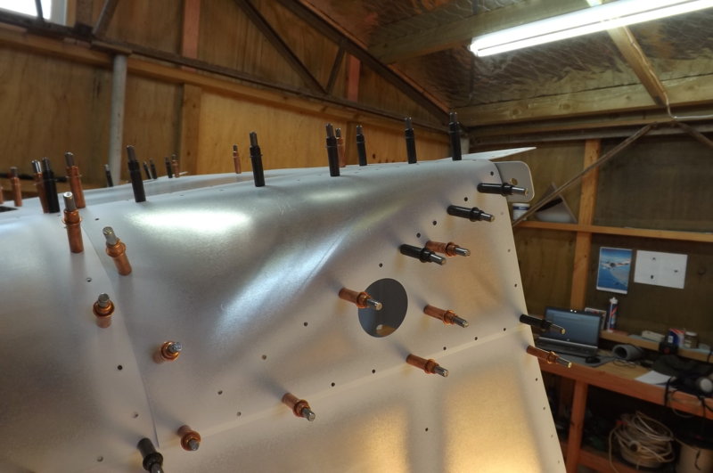

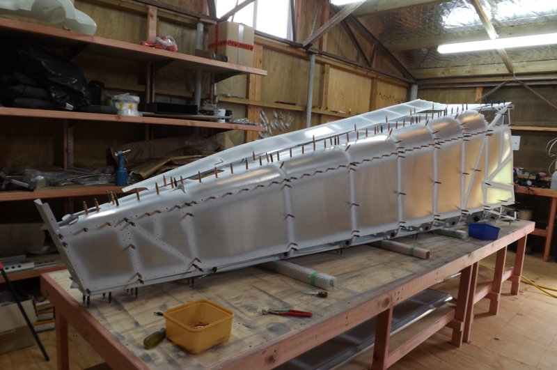

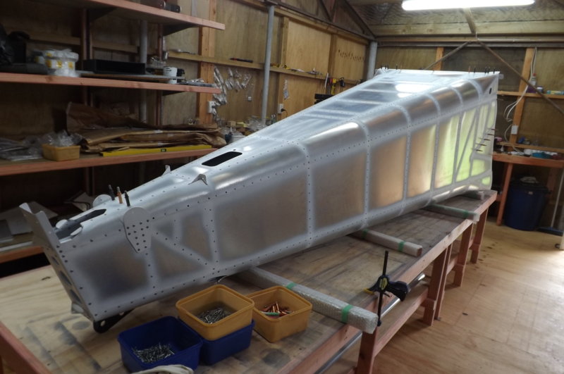

Kyle Communications Posted April 17, 2017 Share Posted April 17, 2017 wouldnt you start from the middle of those curved sections and work your way out? I would have it all clecoed first and do one cleco and rivet at a time...but any advice would be appreciated as we will soon be doing this 1 Link to comment Share on other sites More sharing options...
mcrowley Posted April 17, 2017 Share Posted April 17, 2017 wouldnt you start from the middle of those curved sections and work your way out? I would have it all clecoed first and do one cleco and rivet at a time...but any advice would be appreciated as we will soon be doing this Kyle, I started in the middle and clecoed every other hole, then riveted from the middle out, then removed the clecoes and did it again, worked perfectly. 1 Link to comment Share on other sites More sharing options...
IBob Posted April 17, 2017 Author Share Posted April 17, 2017 wouldnt you start from the middle of those curved sections and work your way out? I would have it all clecoed first and do one cleco and rivet at a time...but any advice would be appreciated as we will soon be doing this With side, top and bottom skins in place, I clekoed an upper curved section on along it's entire upper edge (the full length of the rear fuse). I then curved and clekoed it down at the front (widest) end and worked back to the tail. The very first cleko in this run went in maybe the 5th hole back, rather than the very first hole: this holds the section square on the frame right from the get go, and is less vulnerable than first hole. No clekoes went into the curved frame corners at this stage, just the upper and lower long edges, every 2nd or 3rd hole. I used all my copper clekos (450?) It went so cleanly and easily, it was a real pleasure to do. And the same applied to the little curved skins at the front: I just clekoed along the upper edge, bent the thing down and clekoed the bottom edge: quick and easy! Riveting is done from the middle (frame 6), out towards the front and the tail: I started in the side middle of the this frame, riveting up and down to the curved sections, then along the curved sections, upper and lower, towards the front and the tail. Each time riveting approached the next frame, I would rivet that from it's centre, up and down to the curved sections. And so on. I believe I did one side then the other, then top then bottom. If you like riveting marathons, you're going to love this! All holes were perfectly aligned except some at the curved frame corners, but these are easily enough podgered. These went in last of all, but I had to redo some of them after misjudging the gun position (working down and round the corner too far) and so putting in several with raised edges. 1 Link to comment Share on other sites More sharing options...
rankamateur Posted April 18, 2017 Share Posted April 18, 2017 wouldnt you start from the middle of those curved sections and work your way out? I would have it all clecoed first and do one cleco and rivet at a time...but any advice would be appreciated as we will soon be doing this I found I couldn't get the middle to curve around the corner because it fought me on both sides. I think I got into trouble starting on the big end working to the rear, but I can't clearly remember. It is quite a while ago now...isn't it? Link to comment Share on other sites More sharing options...
rankamateur Posted April 18, 2017 Share Posted April 18, 2017 I did think this and the wing leading edge are two places that would be three times easier with two people until you get it pinned down in shape. Link to comment Share on other sites More sharing options...
