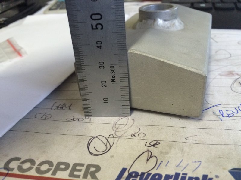

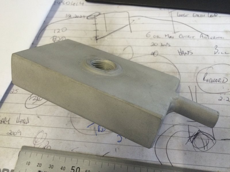

Old Koreelah Posted May 31, 2016 Share Posted May 31, 2016 I want to replace the simple oil vent catch can on my Jabiru engine with a canister to collect oil and return it to the sump. On longer flights this might prevent running low on oil. I'd like to use the CAMit design, but it requires dismantling to drill an oil-return hole in the casing. I can't seem to find one ready-made; people suggest I build my own. My solution: a home-made flat canister mounted close to the dipstick so oil mist can enter, be condensed out and accumulate. Water vapour and other nasties can pass out thru a tube at the top, routed down under the aircraft. Problem: how to allow the oil to accumulate in the catch can without blocking the single small entry hole? Solution: slope the flat canister so that oil can only drain back into the engine when aircraft is sitting on tail wheel. I have only a vague idea of what's actually inside a functioning unit; I'd rather use metal mesh than stainless steel kitchen scourer (I don't want scrap metal draining back into the engine). Any suggestions and advice welcome. Link to comment Share on other sites More sharing options...

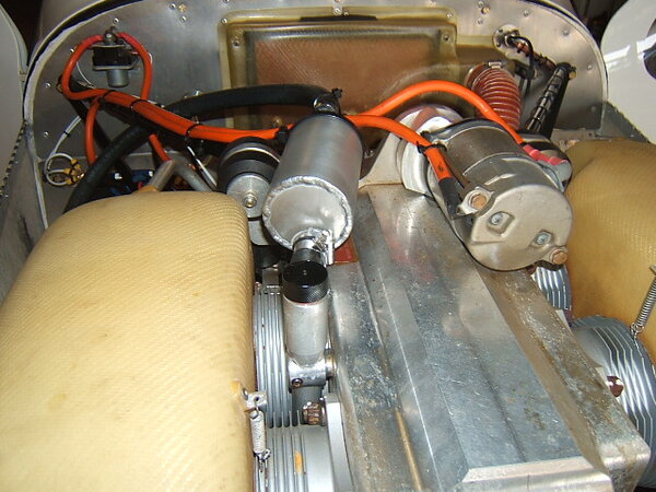

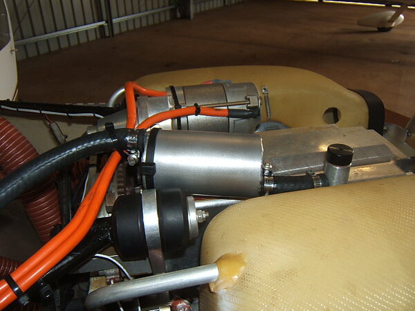

jetjr Posted June 17, 2016 Share Posted June 17, 2016 I bought a Jabiru one, dont think it achieved anything much. An issue with Jabiru is that they tend to pump out good oil to a set level, this could be an issue on really long trips. Have to work out real oil burn which is tricky. A lot of people overfill and get the perception the engine is burning the oil up. CAE vent the blow off pipe to a different part to the rear of the engine. An issue is maybe the small diameter of the oil fill tube and this fixes it. Now they have a catch can too. Mine uses almost no oil without this. I also have on the bench a different style, and new,catch can here I could sell cheaply. Wasnt cheap to buy. Made specially for 3300. Pipe with baffles inside that sits alongside coolong duct, Not required as i now have CAE engine. Link to comment Share on other sites More sharing options...
Oscar Posted June 18, 2016 Share Posted June 18, 2016 The CAMit return system is an oil separator and return: check it out at: Breather/Oil Separator Approximately similar in operation to a gascolator. I have no idea of the Jabiru device, it may do the same. Nev's point about returning water-saturated oil to the sump, is extremely important. Not only will it contain sulphuric acid due to combustion, but in extreme cases a high water content being delivered to a high-load area - e.g. the main bearings - will cause flash steam displacing the oil and causing oil starvation scavenging of the bearing surfaces. This has been observed in some Jab engines and incorrectly ascribed to tight bearing clearances. 1 Link to comment Share on other sites More sharing options...
Old Koreelah Posted June 18, 2016 Author Share Posted June 18, 2016 The CAMit return system is an oil separator and return: check it out at: Breather/Oil Separator... I have no idea of the Jabiru device, it may do the same... See post #6. It looks pretty simple, but not as elegant as CAMit's. Both types, being mounted to the engine, should get hot enough to prevent water condensing and returning to the engine. Link to comment Share on other sites More sharing options...
jetjr Posted June 18, 2016 Share Posted June 18, 2016 Theres nothing much inside the Jabiru version, i believe CAE has mesh and trapping material, bit of work gone into getting it right, like all CAE items 1 2 Link to comment Share on other sites More sharing options...
