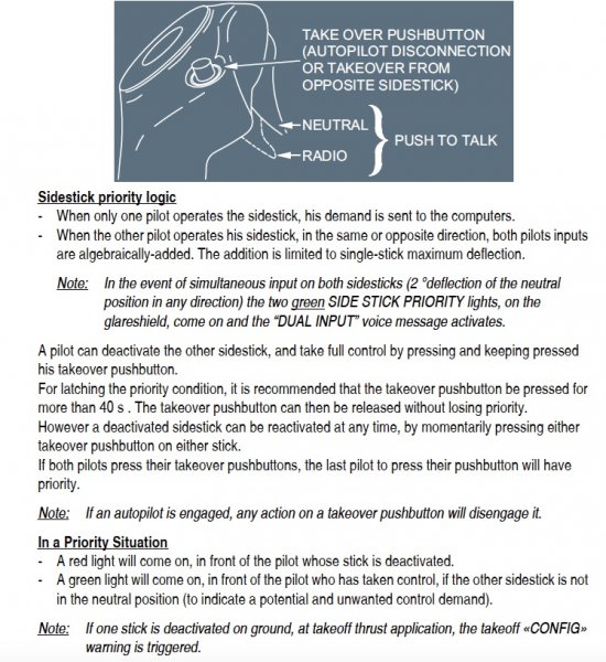

So the plane has a sidestick controller on each side, obviously one for each pilot. It is totally "fly by wire" so there's no physical link between the two. If simultaneous inputs are made, the computer "averages" them. I guess it was designed that way because if it did anything else, a dual input could lead to pretty extreme movements.
If one pilot pulls full back, and the other pilot pushes full forward, nothing happens because the inputs are averaged and cancel out.
However the plane will loudly announce "dual input!" at you if both pilots make a control input, as well as illuminating a warning light in front of each pilot. There is a pushbutton on each sidestick which if depressed (whichever one is pressed first) will instantly take priority from the other sidestick and if held long enough, will lock it out all together. This is how you take control if the flying guy is doing something really bad and you don't have time to talk about it.
The bottom line is that discipline over who is actually flying the plane is required (which has been the case ever since dual control planes were invented) and positive confirmation or action is required to have one pilot take control if dual input is shouted at you by the computer, but we've seen accidents where this discipline has broken down. AF447 which stalled into the Atlantic had this happen, among many other things. You'll see "dual input" in the CVR transcripts while Bonin was holding his sidestick fully back keeping it in the stall though he didn't understand that he was stalled, while the other guy has tried to push forward. No-one ever really did anything about it. The senior First Officer should've screamed at him "I HAVE CONTROL!" and/or pressed his takeover button.
It's just one of these basic principles which tragically broke down. Only one guy flies the plane at a time, and everyone in the cockpit needs to be fully aware of who it is.
Correction:
In fact both inputs are algebraically added, not "averaged". It does this up to maximum deflection that would be available to a single sidestick. So the effect of one pushing forward and one pulling back is the same - one essentially cancels out the other, or partially cancels it out. Sorry....been a while since I've done the ground school and I had to refresh myself because I couldn't recall the exact details!
It's on page 1,371 of our 4,255 page Flight Crew Operating Manual for the Airbus A330, if you must know....004_oh_yeah.gif.82b3078adb230b2d9519fd79c5873d7f.gif (that's true!)
The principle is as I said though. It tells you, and there needs to be clear communication of who is doing what.
