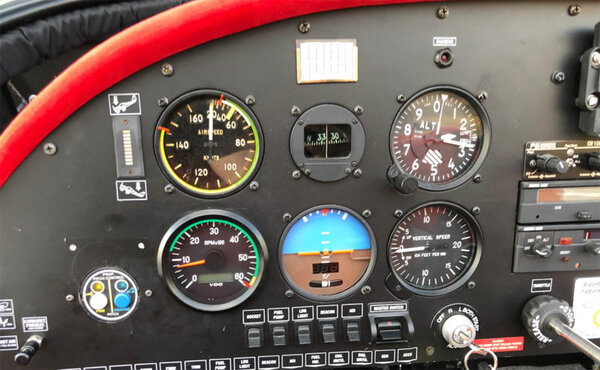

BirdDog Posted January 1, 2018 Author Share Posted January 1, 2018 The prop does not have predefined stops. It’s electric with a button on the dash with lights to show full fine or full course. To set the prop in the cruise I need to be able to see RPM and MP properly. Would be nice to have them right under my nose. Link to comment Share on other sites More sharing options...

BirdDog Posted January 1, 2018 Author Share Posted January 1, 2018 It has end stops. But nothing in between. So you have full fine at one end and full course at the other. In between there is no predefined stops. Just a button that adjusts it between full fine and full course. So in cruse the pilot has to adjust the pitch to get the best RPM/pitch combo to get the best out of the flight. The two gauges needed for this are MP and more importantly RPM. With them on the right side and flat, it’s a PITA!! 1 Link to comment Share on other sites More sharing options...

BirdDog Posted January 4, 2018 Author Share Posted January 4, 2018 Hey Nev, Bit of an update for you mate. Managed to play yesterday and I had to back off at 115, as it was too lumpy! LOL! I still had more throttle and pitch to go, so it really can boogie! That said, it will take some getting use to trying to spot the RPM from the other side of the dash. Pain the backside! I have a request in with RAA to see if I can get it relocated. But happy with how she went yesterday. Cheers John Link to comment Share on other sites More sharing options...

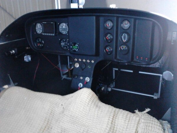

skippydiesel Posted January 5, 2018 Share Posted January 5, 2018 .........................SO... does anyone have any ideas on how I can rectify this? Maybe retrofit some sort of angled bezels etc?I am open to ideas. Cheers J I used different length vibration isolators (the ones that have a threaded rod at each end) to tilt the whole right panel in my direction. Works a treat. Very cost effective & easy compared with trying to angle each gauge separately. I should also point out that I redesigned my panel at the same time, as when you angel, you effectively "shorten" in terms of mounting hole location & esthetic fit. Link to comment Share on other sites More sharing options...
BirdDog Posted January 5, 2018 Author Share Posted January 5, 2018 Thanks Skippy. My dash is all one piece - sadly. My buddy did the same with his. Angled the half that he needed to. Works a treat. Link to comment Share on other sites More sharing options...
skippydiesel Posted January 5, 2018 Share Posted January 5, 2018 Hey Nev,...............................trying to spot the RPM from the other side of the dash. Cheers John I can't understand the logic of having the tacho on your right side - along with fuel & manifold pressure, it's as important as your flight gauges (no revs. no fly). Link to comment Share on other sites More sharing options...
BirdDog Posted January 5, 2018 Author Share Posted January 5, 2018 Yep! My point exactly. The later models actually have the RPM on the left, AND, it's double the size! So somewhere along the way they decided it's a bit more important! My plan is to get it on the left side - come hell or high water. It was a real PITA yesterday trying to set that prop for cruise, and having to lean over to see it. With a PAX, it would be worse! Link to comment Share on other sites More sharing options...
Downunder Posted January 5, 2018 Share Posted January 5, 2018 Would it be easier just to add an extra rpm gauge on the left? A bit wierd doubling up, but you only have to worry about an installation rather than a relocation. Even if it was something of a semi permanent set up.... Link to comment Share on other sites More sharing options...
BirdDog Posted January 5, 2018 Author Share Posted January 5, 2018 Yep! That is possible too! I have written to RAA asking - but as yet, not heard back. This time of year, it's understandable. Link to comment Share on other sites More sharing options...
skippydiesel Posted January 5, 2018 Share Posted January 5, 2018 Yep! That is possible too!I have written to RAA asking - but as yet, not heard back. This time of year, it's understandable. Almost certainly RAA will refer you to the manufacturer for a decision - So I suggest you try and contact the manufacturer ASAP - If , as you say, later models of this aircraft have the RPM on the left, I shouldn't think they will have any issues with you relocating or adding (as per DownUnder's advice). Just make sure you get their agreement/approval in writing to wave at RAA . Link to comment Share on other sites More sharing options...
Yenn Posted January 5, 2018 Share Posted January 5, 2018 If you want a tachometer on the left, how about putting in a “Tiny tach” it takes up very little room and can be be very accurate. It only needs a wire wrapped around a plug lead to operate. 1 Link to comment Share on other sites More sharing options...
