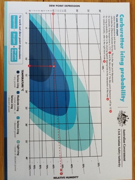

biggles Posted June 23, 2019 Share Posted June 23, 2019 “That would still leave you in almost prime carb ice territory. As facthunter said there are requirements for certification. The chart says serious icing ANY power for the dark blue, lycoming say somthing different.” My point was in reference to post #39, indicating that in some instances it is possible that the application of carby heat may not degrade engine performance ...... Bob Link to comment Share on other sites More sharing options...

Roundsounds Posted June 26, 2019 Share Posted June 26, 2019 We have little idea about this EFATO, that's the point Re ice, Yep, POH written in Bundaberg Is guess and if youre not expecting it would take quick thinking to clear and keep going. I regularly clear carb ice before take off in cold weather and its hardly noticable when idling. The carb heat check on run ups (if youre not to fast) will let you know if its there with a rpm RISE. Jabiru carb heat setup has very little effect on power, esp 3300, and can handle normal operation left on all the time, all the air is filtered on nearly all Jabiru aircraft hot or cold. Carb Ice is more likely in less than “cold weather” conditions. Have a look at the carb ice likelihood chart produced by BoM / CASA. Carb ice is one of those things you may never have experienced in your flying career, but could catch you out one day. Using carb heat to prevent icing is much smarter than being reactive, because when you’re likely to need it, it may not be effective. My experience with Carb Ice on takeoff has been a momentary rough running as accumulated ice is ingested. The prolonged rough running / power loss is unlikely to occur at high power settings. Follow the manufacturers recommendations is your safest bet. Link to comment Share on other sites More sharing options...
